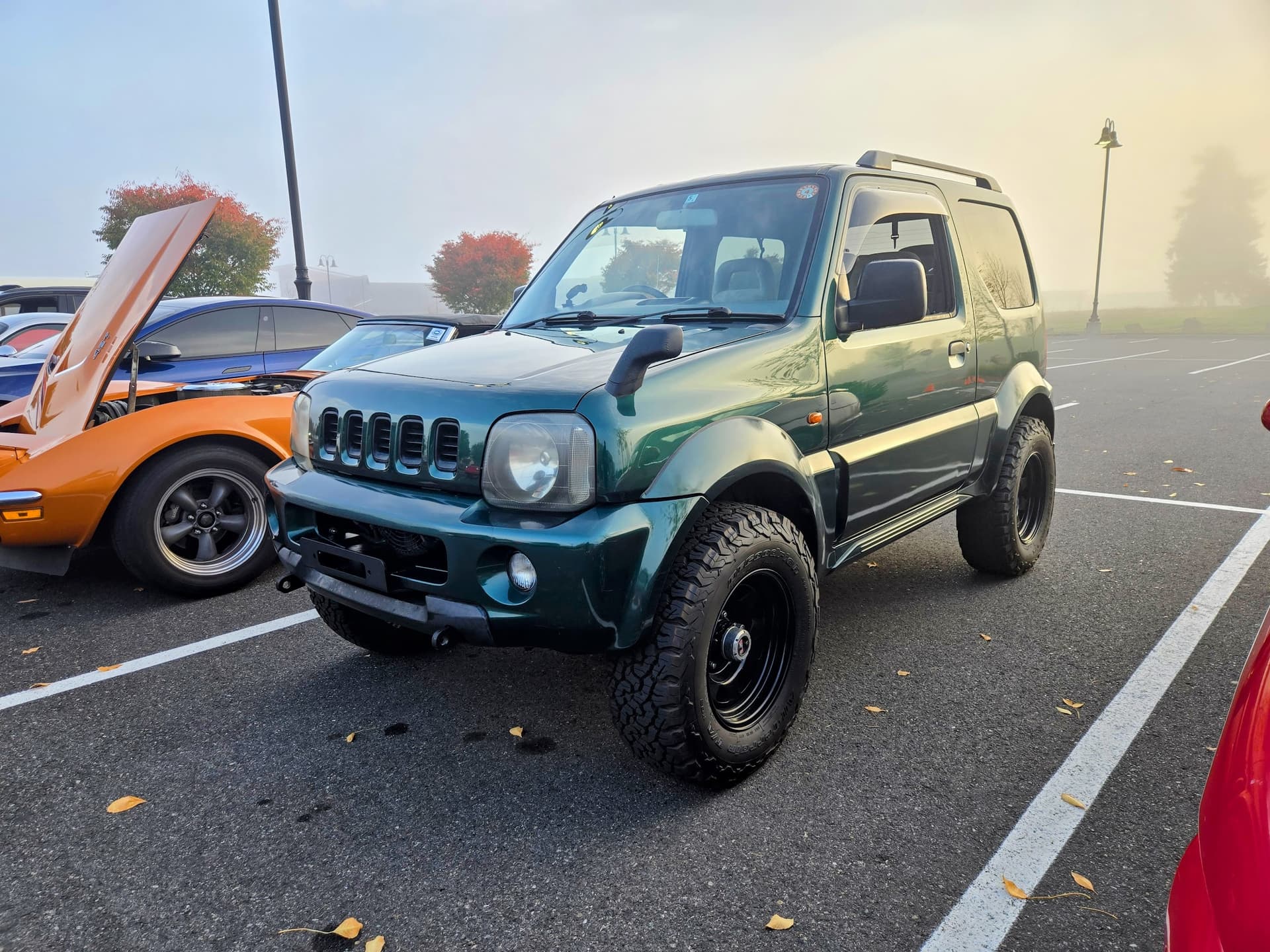

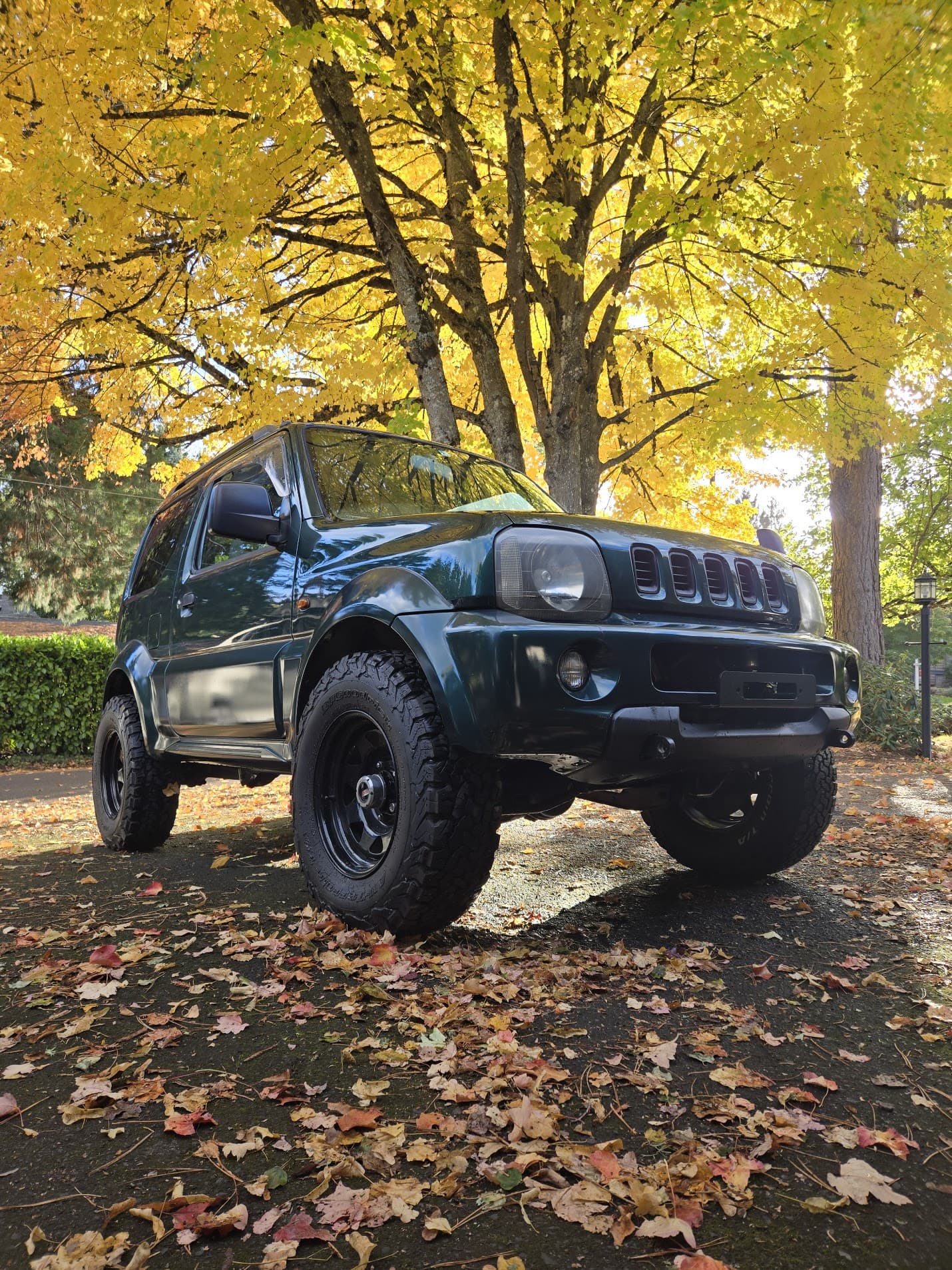

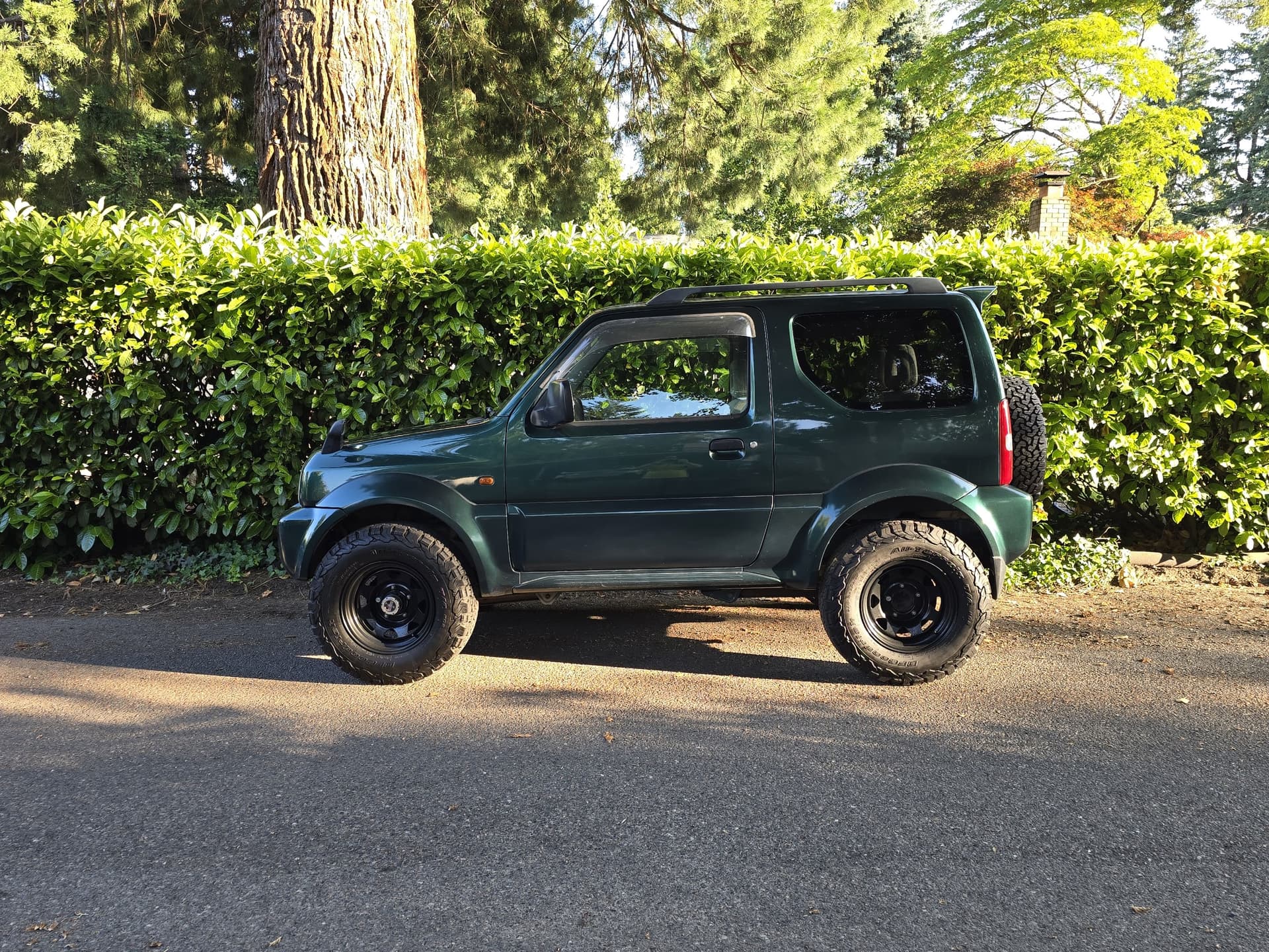

I always wanted a Suzuki Jimny, and we finally got one. We got this in June of 2024, then promptly took off on a couple months of travel, so I’m just now getting around to working on it.
Being the Jimny Wide, it uses the G13BB engine (1.3-liter) and has wider flares kicking it out of kei car classification. This means I can register it in Oregon.
It came with Ultima shocks and King Springs for a little 1" lift. Also came with brand-new BFGoodrich KO2s and new wheels. It’s got a winch plate, and I just got a new WARN R-Series 6000 lb. winch for it. It also has manual hubs, a full set of replacement brakes, and rear recovery points I need to install.
Had an oil leak, which is now buttoned up, and I fixed a leaky heater hose a couple days ago.
This little thing is brilliant around town. The engine + 5-speed darts around town easily. It can do 70 MPH without much effort, too. Lots of potential here!
We plan on replacing the roof rack, adding some lights, underbody protection, and who knows what else. Also, got to love the two-speaker stereo!

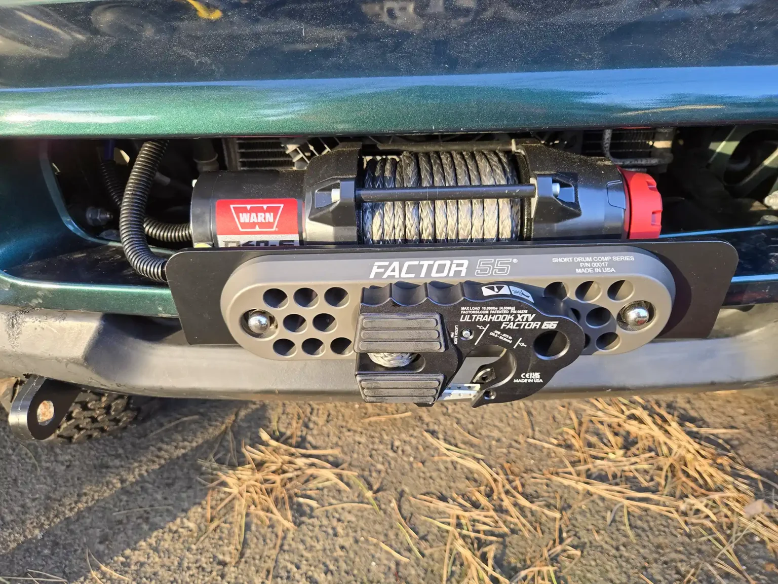

I also got the winch one. I pulled the Harbor Freight APEX winch, sold it, and got a new WARN R60-S winch. It has a 6,000 lb. capacity and is made for UTVs and small SUVs like the Jimny. Since it already had the mounting plate (which is drilled for this size winch or a full-size truck winch), it just bolted up. I wired it up, and it was almost ready to pull.
The Jimny Bits winch plate, however, is drilled for a truck-style winch fairlead which has a 10" spacing for the bolts. The UTV fairlead is much smaller and wouldn’t work. So, I got a Factor 55 Short Drum Comp fairlead, which has a narrow opening, perfect for this winch. I also topped it off with a Factor 55 UltraHook XTV, again, intended for UTVs, but still well within the pulling capabilities.

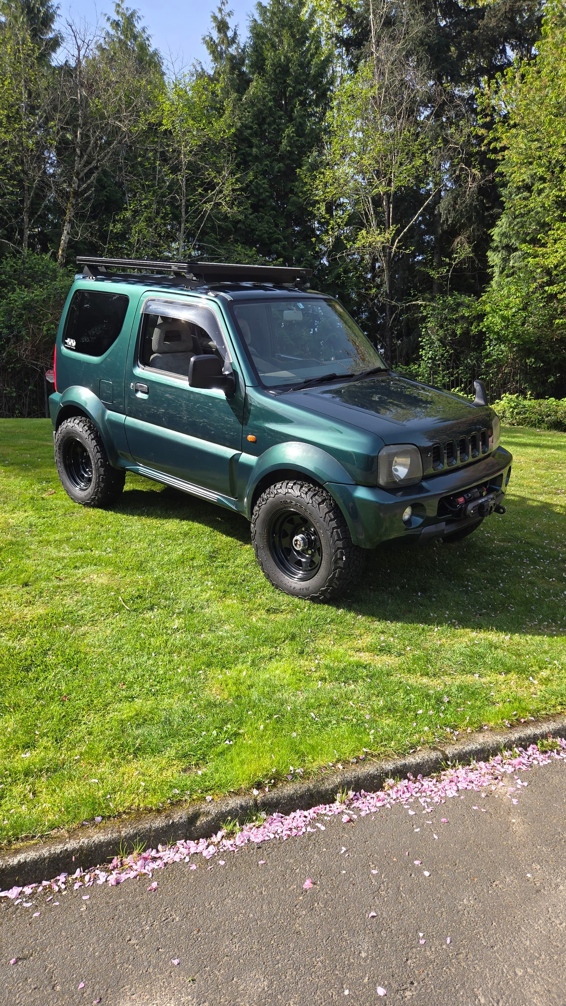

If you ever want a cheaper alternative… Say… Like… Jake the Snake Roberts level? I’ve been very happy with my Smittybilt Defender platform rack. Had it for 7 years now. It’s seen all kinds of rough treatment and is still fine!
got the rack on, and it’s very good! Took it to the Avants Portland Weird & Wacky car Show too!
