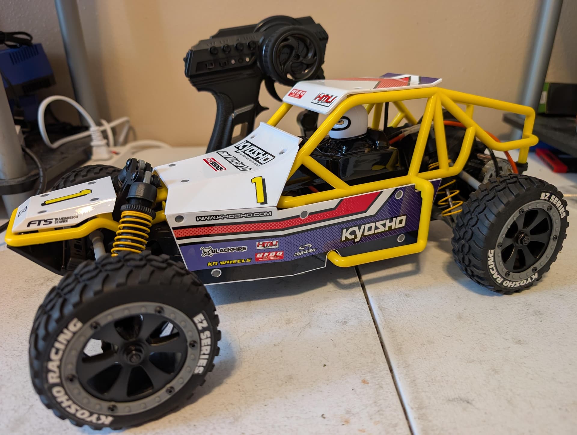

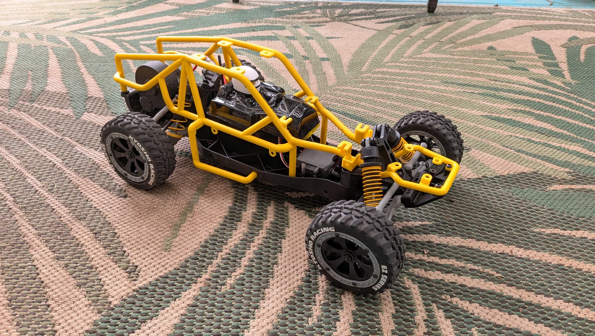

Not sure what I’m doing with this one yet, really. I just know it feels good being back in an electric, 1/10-scale buggy again. The Kyosho Sandmaster 2.0 is a modern revision of its vintage forebear, tailored to entry level fun. It’s usually around $100, batteries not included, but I think I got into mine for well under $140 shipped, all-in.
I can’t stop looking at it. (You know that means you bought the right car.)
Why All About That Base?
I dunno. I might change it at some point, but I’ve always been one to end up in the base model. Granted, I had an RC-10 Team Car with a pretty hot setup there for a bit, but thinking about it now, I’ve always lacked either the means–or the patience–to hold out for the top-of-the-line.
What makes this “base model”?

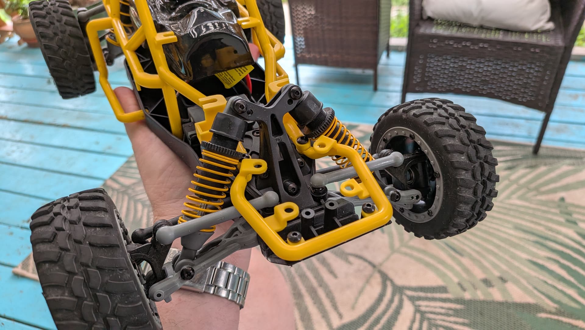

You might have noticed it’s all plastic, but it’s also designed to be relatively forgiving to those new to driving RC buggies. Those body panels snap into place at the gray dots. The roll cage seems almost entirely cosmetic. It’s got the same lower control arms front and rear. (The rears have 1/8" of side play.) All of the suspension and steering linkages are single-piece plastic and non-adjustable.

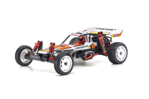

Compared to more performance-oriented models like the Ultima pictured below, it feels almost twisty, fragile; and yet it also feels like the quintessential basher, ready for big air at the local BMX track. The reed that bends, after all. That curiously flexible roll cage? $17 on Ebay. Kyosho used to sell them direct–for $4.99. I mean, you can replace the entire thing for $100.

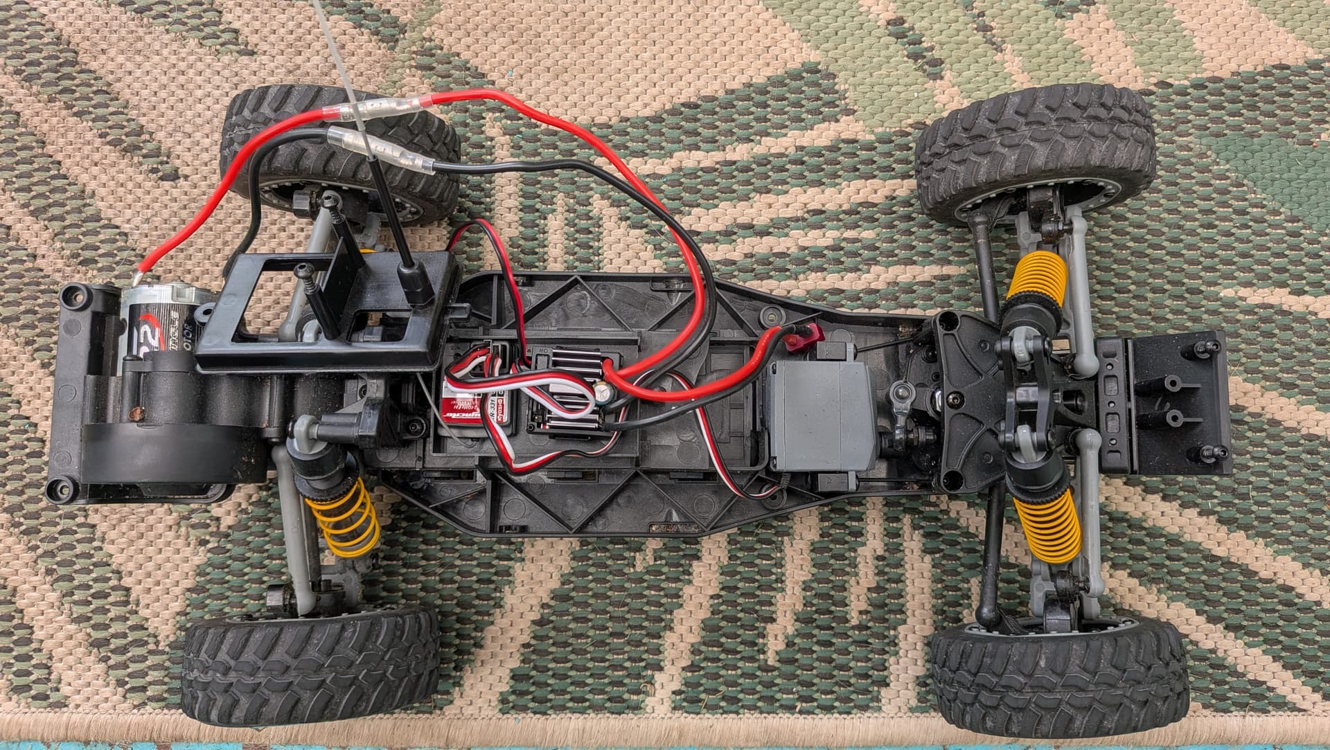

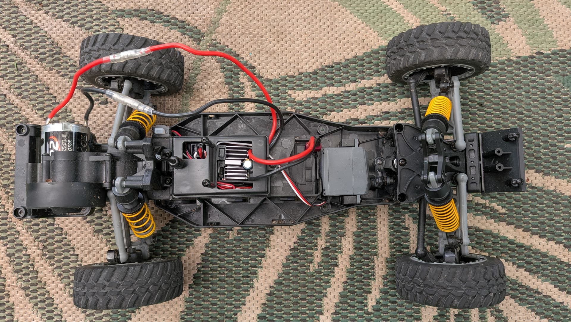

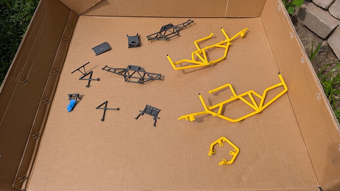

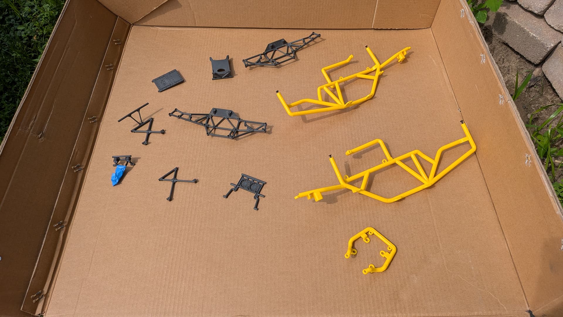

Started by taking the Sandmaster apart.

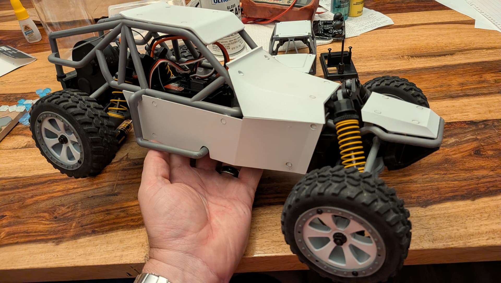

Like I said. Pretty basic. A lot of the suspension and steering linkages feel an awful lot like Happy Meal toys. The shallow, plastic tub feels a bit more rigid; clearly a different material. Kinda neat comparing this to the metal tub on the Optima in my previous post.

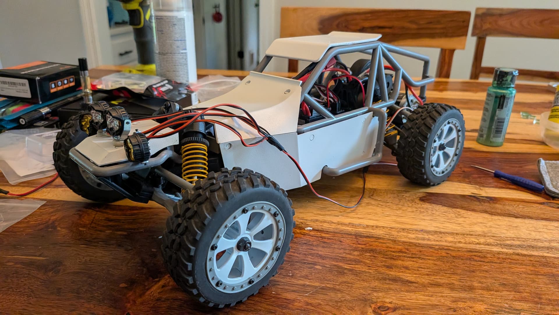

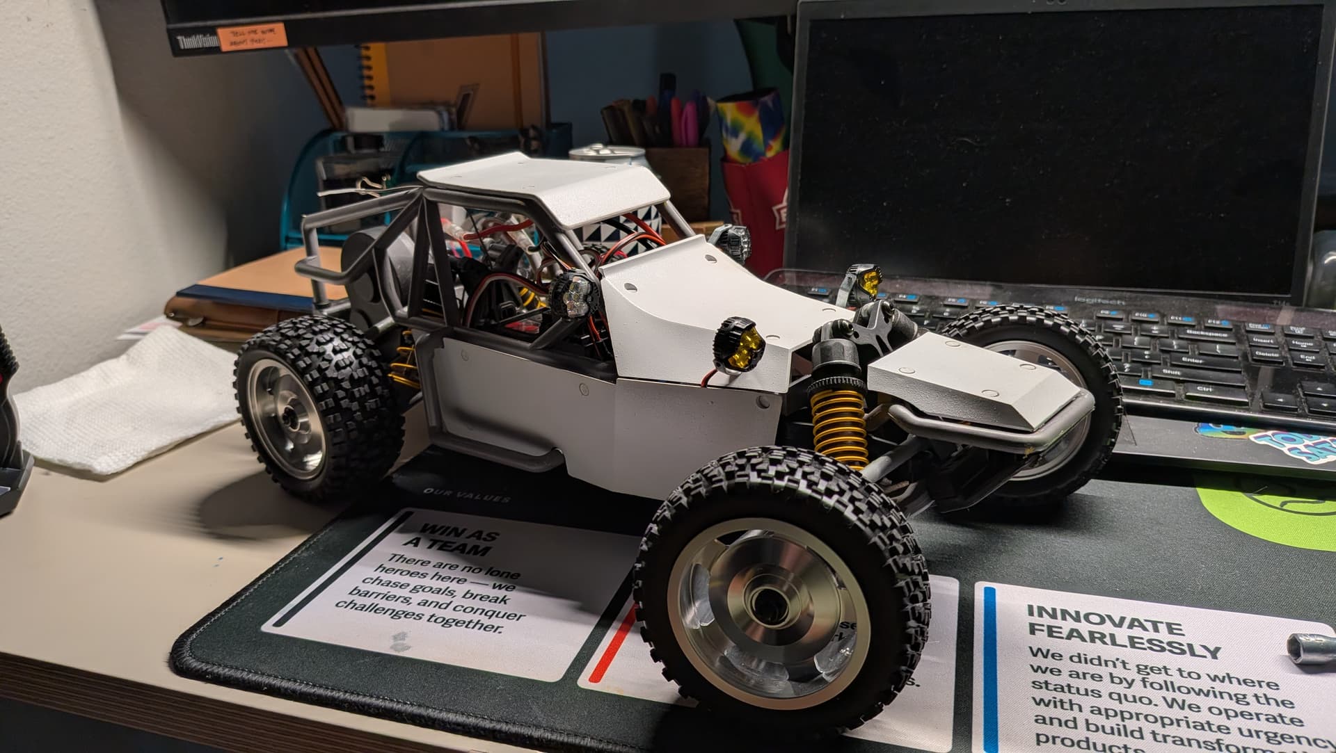

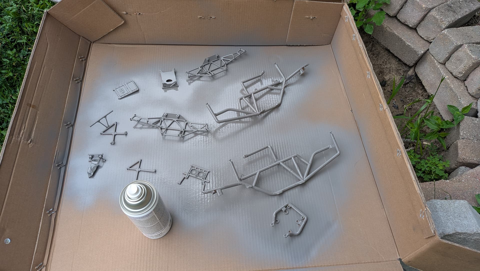

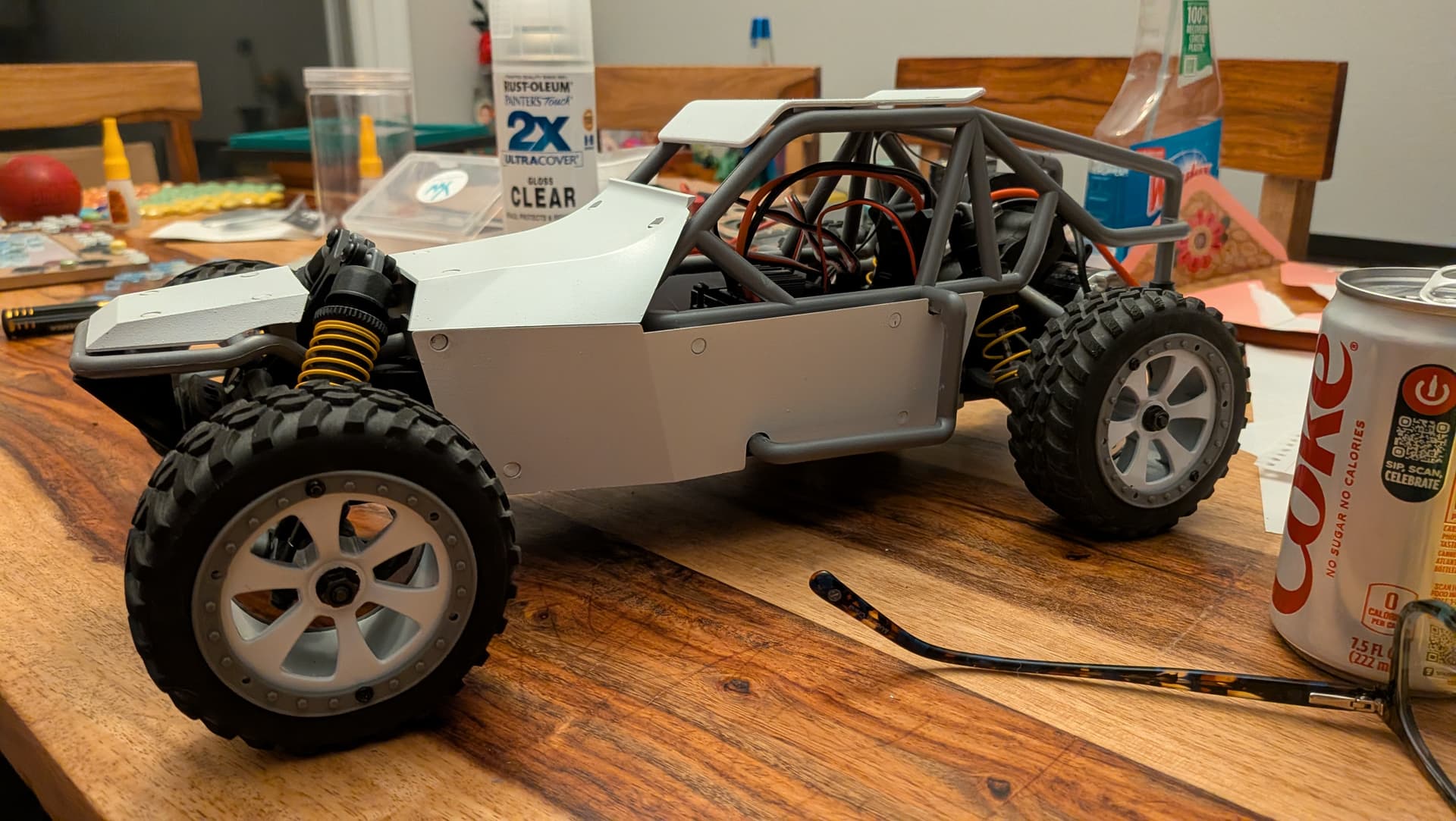

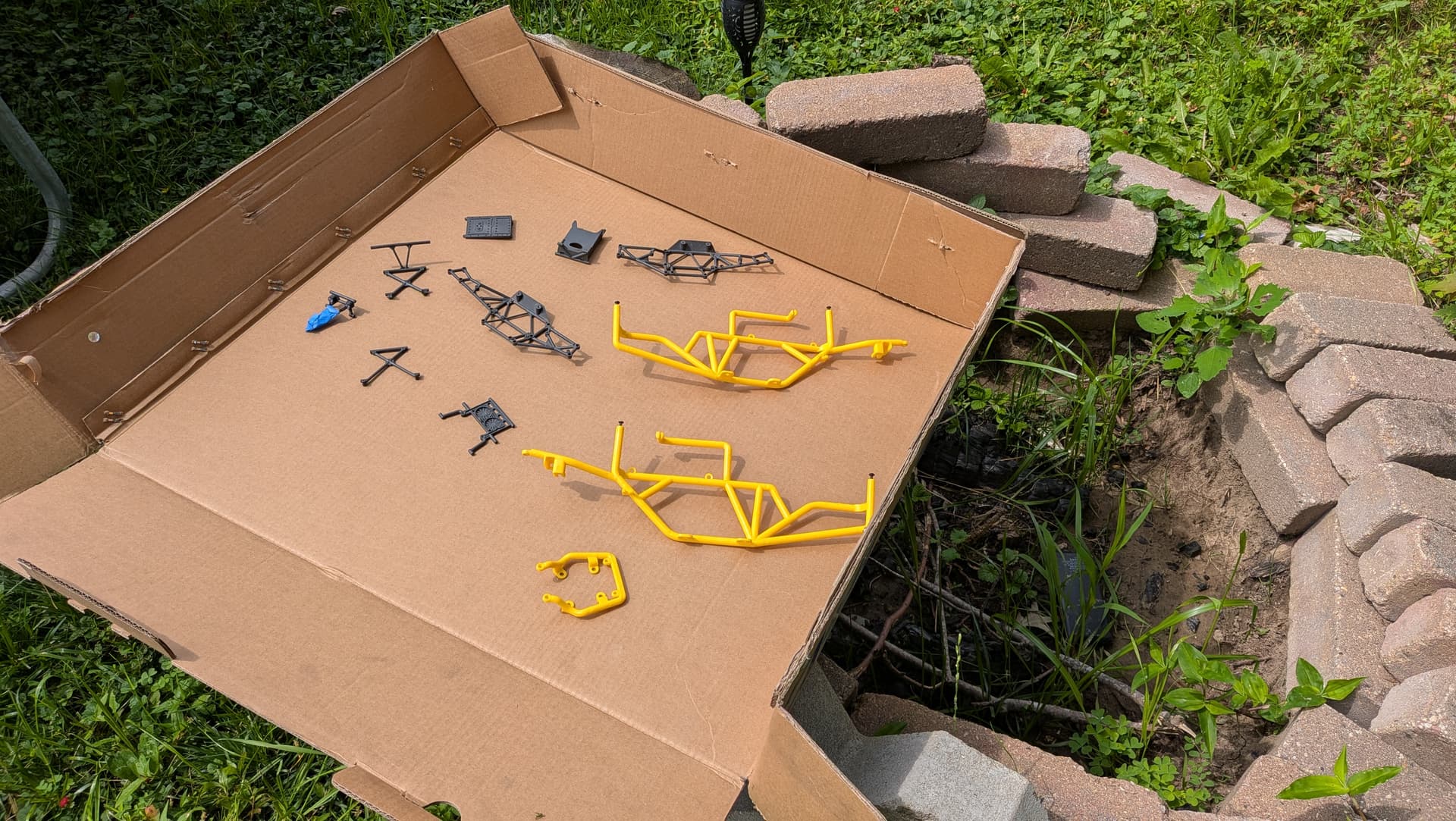

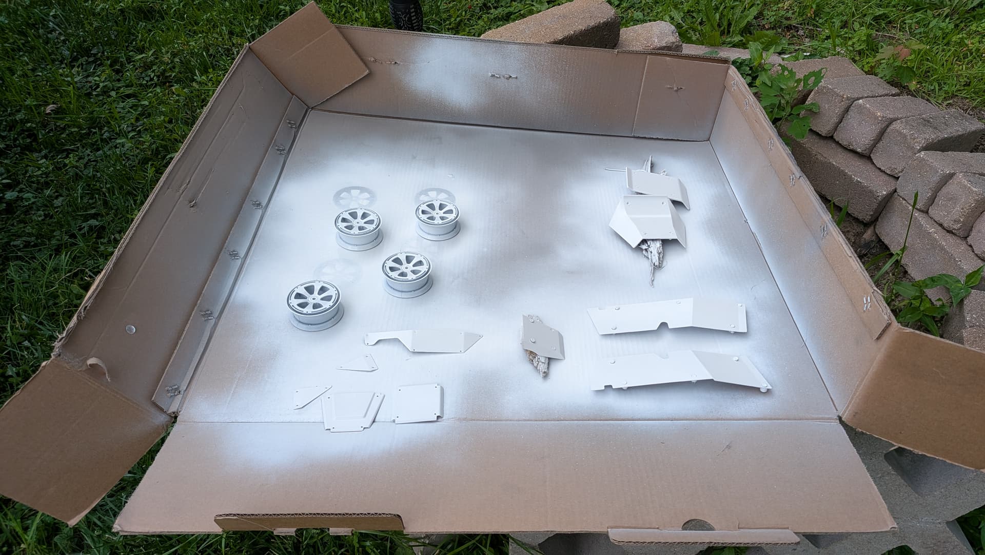

Anyway, I took the cage and body apart, removed decals, cleaned, and painted a bunch of parts. Roll cages are gray–Rustoleum Matte Granite Gray. And the body panels are white–Rustoleum Gloss White Wheel Enamel.

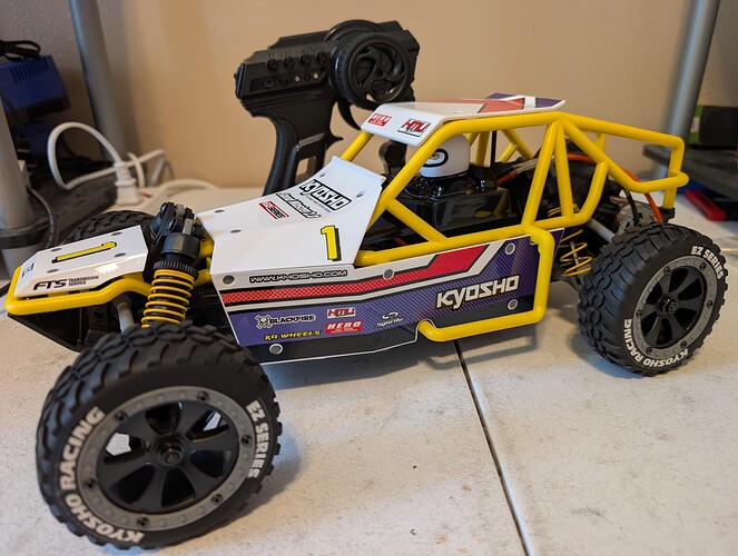

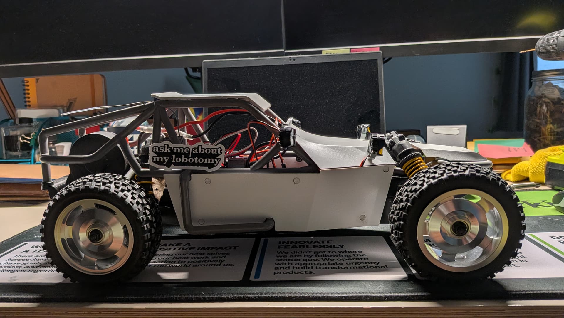

Semi-Final Results
New wings showed up today. And several lights, some of which were broken. Boo, I say.
Sharp eyes will notice smaller parts were painted as well. (Little Guy update to follow.)

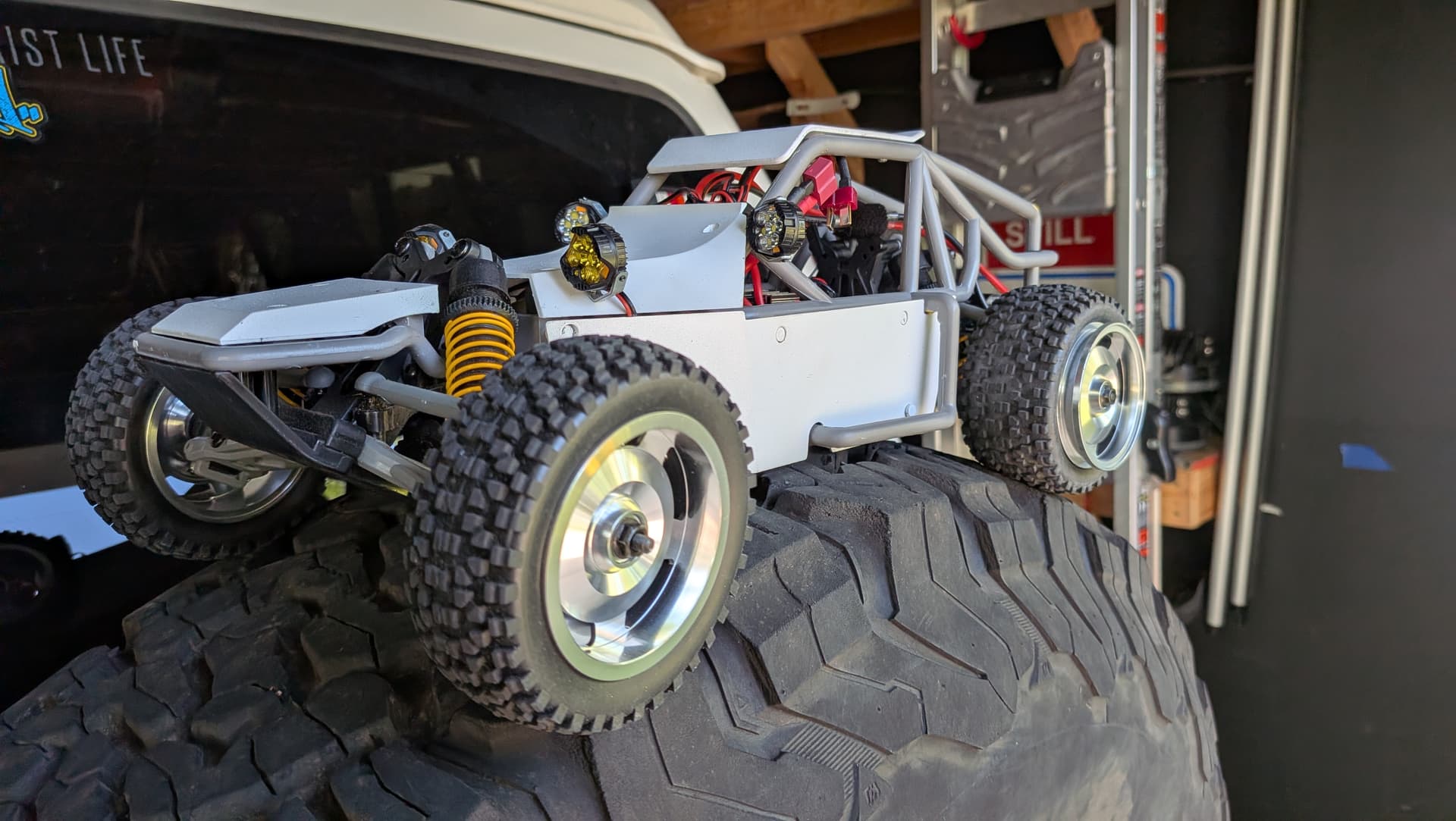

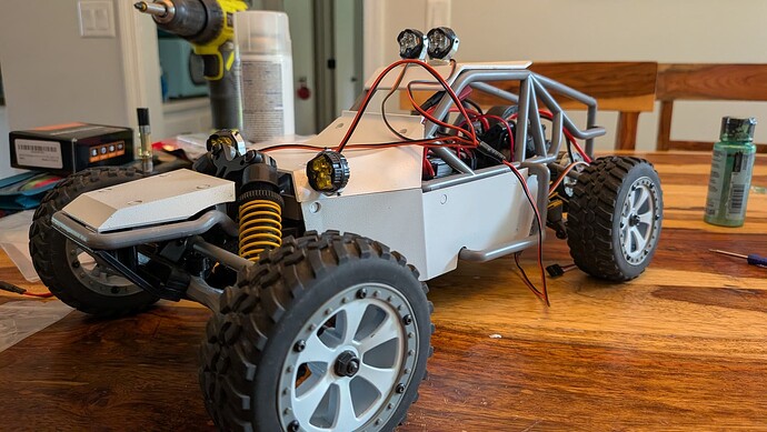

Things have escalated…

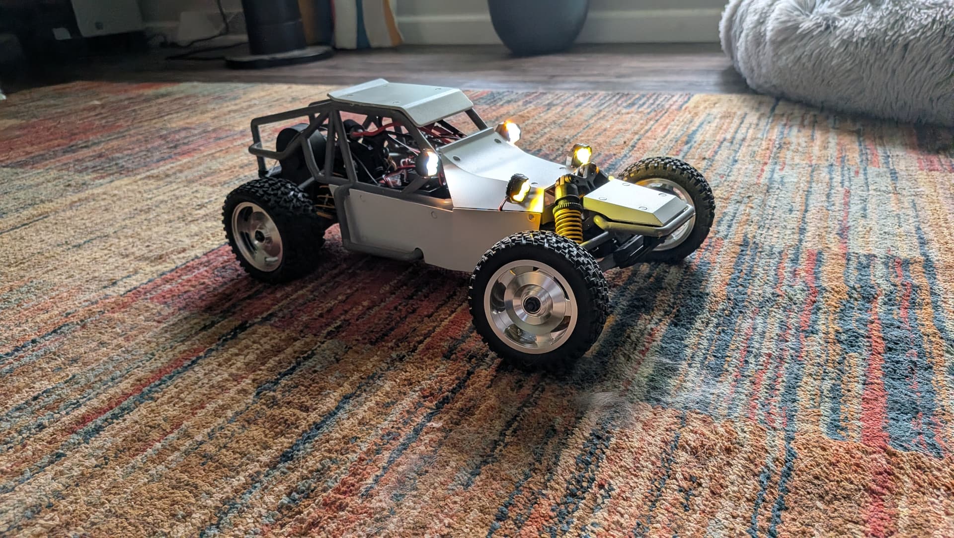

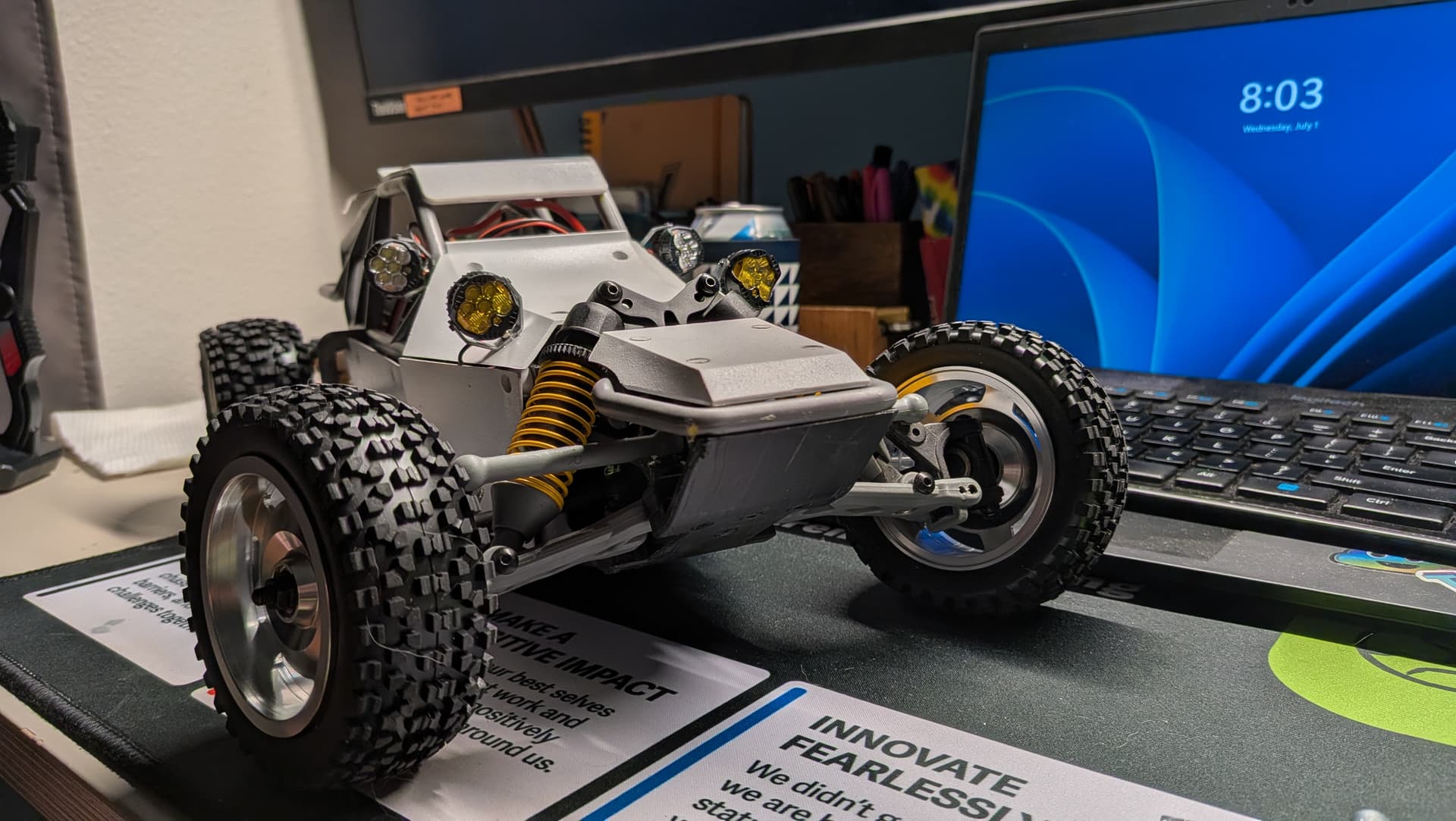

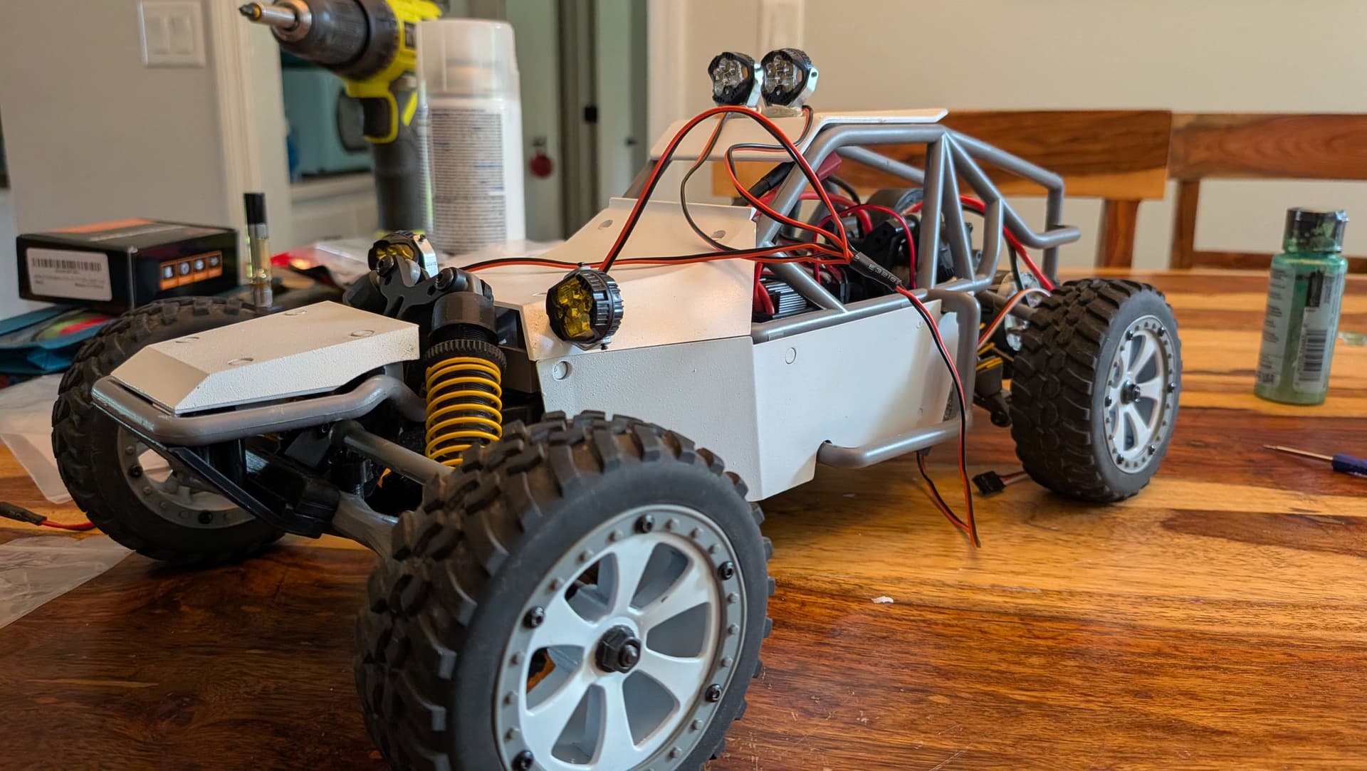

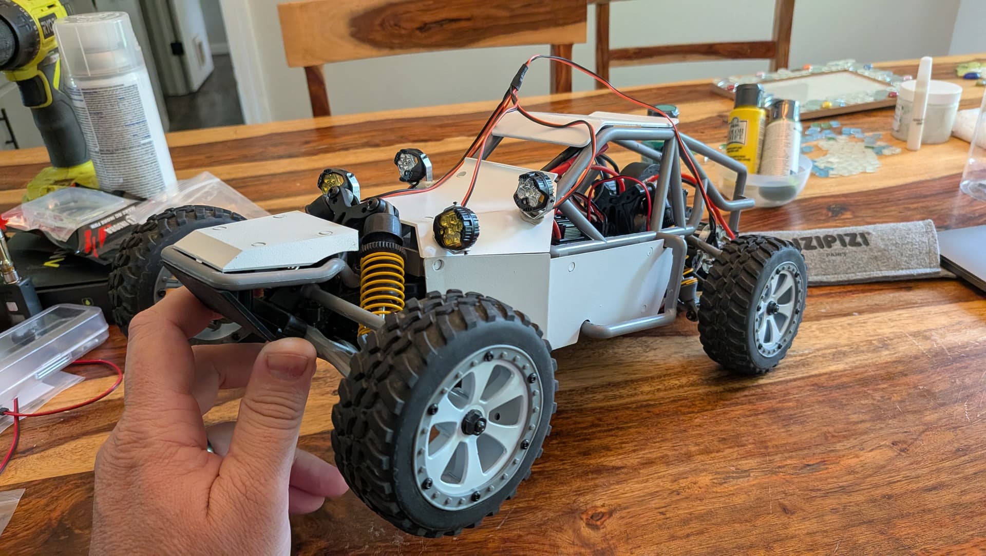

I got some lights. Used sticky putty to mock them up.
I then went a different direction.

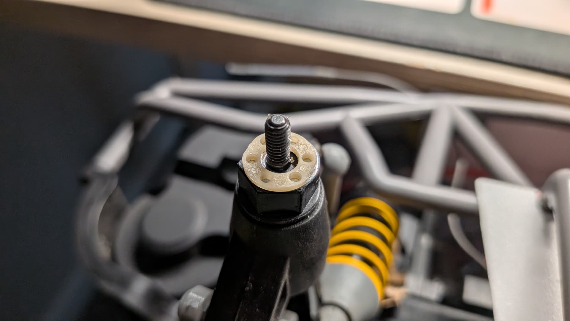

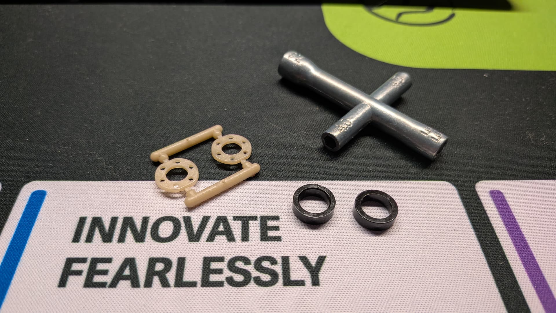

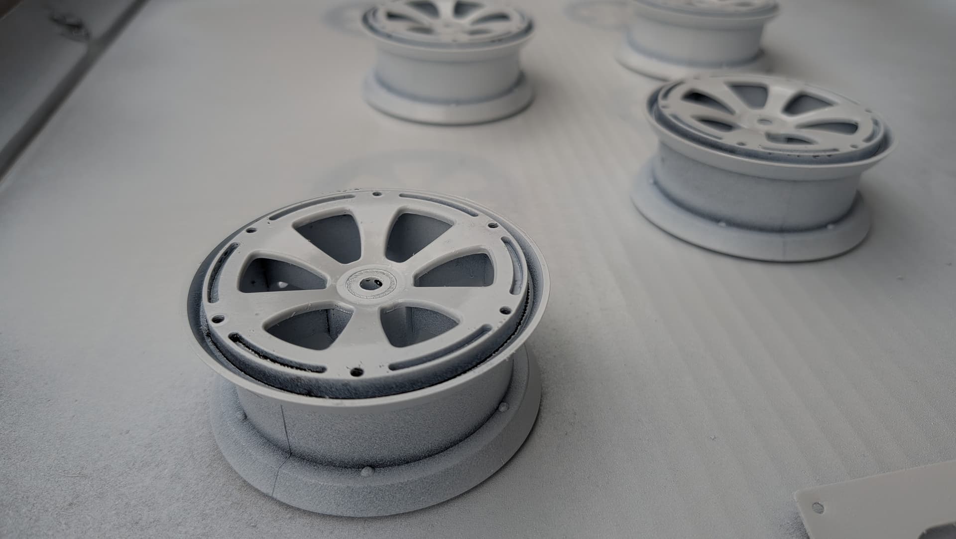

I tightened the lug nuts–and offset clamped the inner lip to the top of the hub, so spacers are in order. I started with a couple NOS King Cab shock piston valves, but they weren’t enough. Then I went and bought some #8 SAE-ish washers in a variety of materials and thicknesses to space things out.
Things appeared to be working excellently. I was coming to terms with the double-tap for reverse (I guess it’s something of a standard failsafe) when I noticed there was no drag brake on reverse. I tried a wheelie.
Captain Halfass needs to learn how to glue his tires, it would seem. :man_facepalming:
