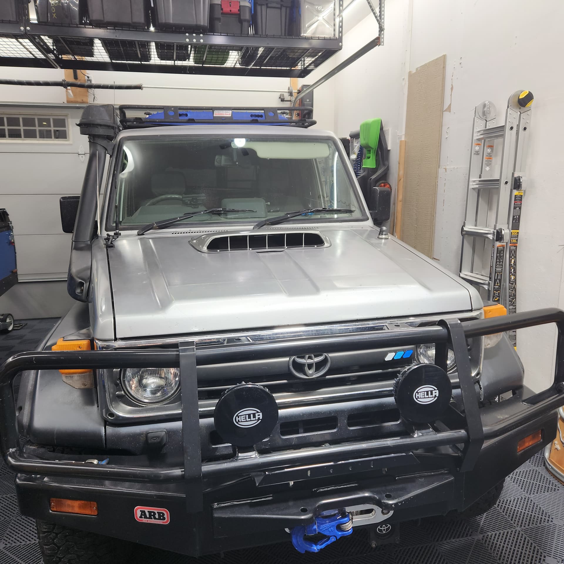

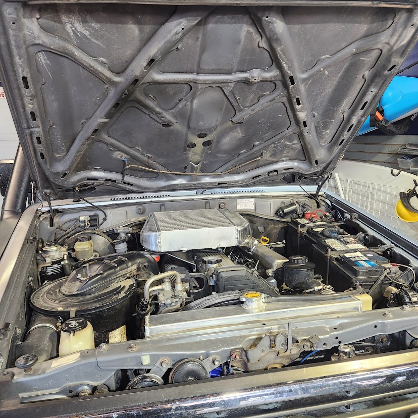

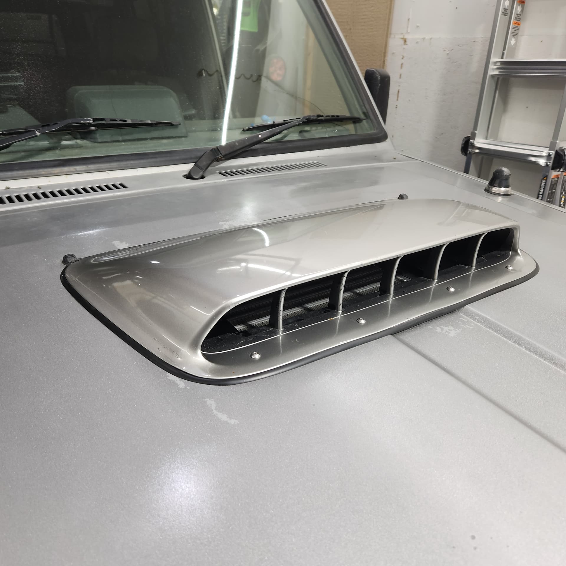

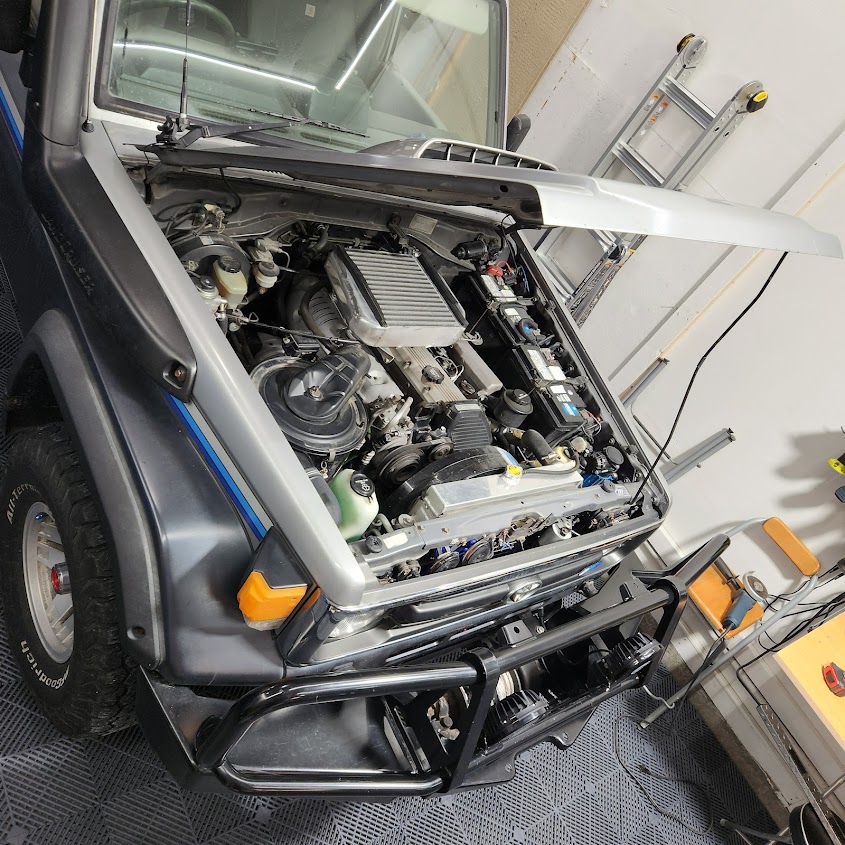

Intercooler scoop from 05 wrx sti (allegedly)… looks like an absolute hack job in my opinion, but there weren’t a lot of good options (nobody would ship from Aus) and so this was the best of the worst possibles.
Anyway, top mount, so no need for a bunch of tubing. I am geting a little oil spray creep so I’m going to have to replace the gasket where it bolts to the intake. But overall it has lowered EGT’s even further, and reduced water temps as well. Interesting to see how it works on the Utah trip coming up. Hard to gauge temps when the outside temps are winter temps.

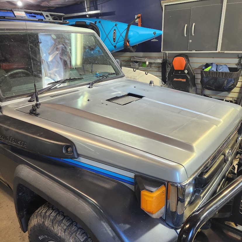

Not an easy hole to cut when I consider the availability of hoods in North America.

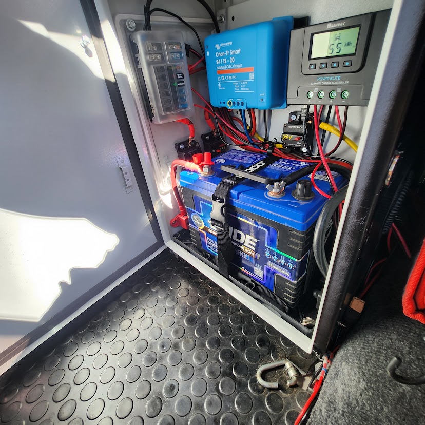

Electrical box remains nicely sorted:

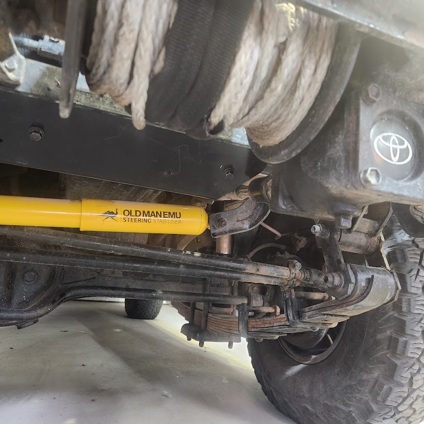

OME steering stabilizer:

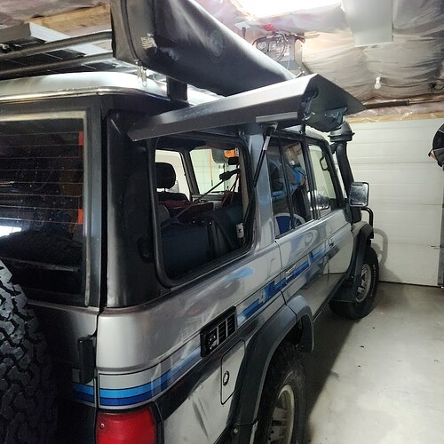

Rear window metal retrofit to replace the ummmm compromised one from last year: (The Cruiser Company from Aus)

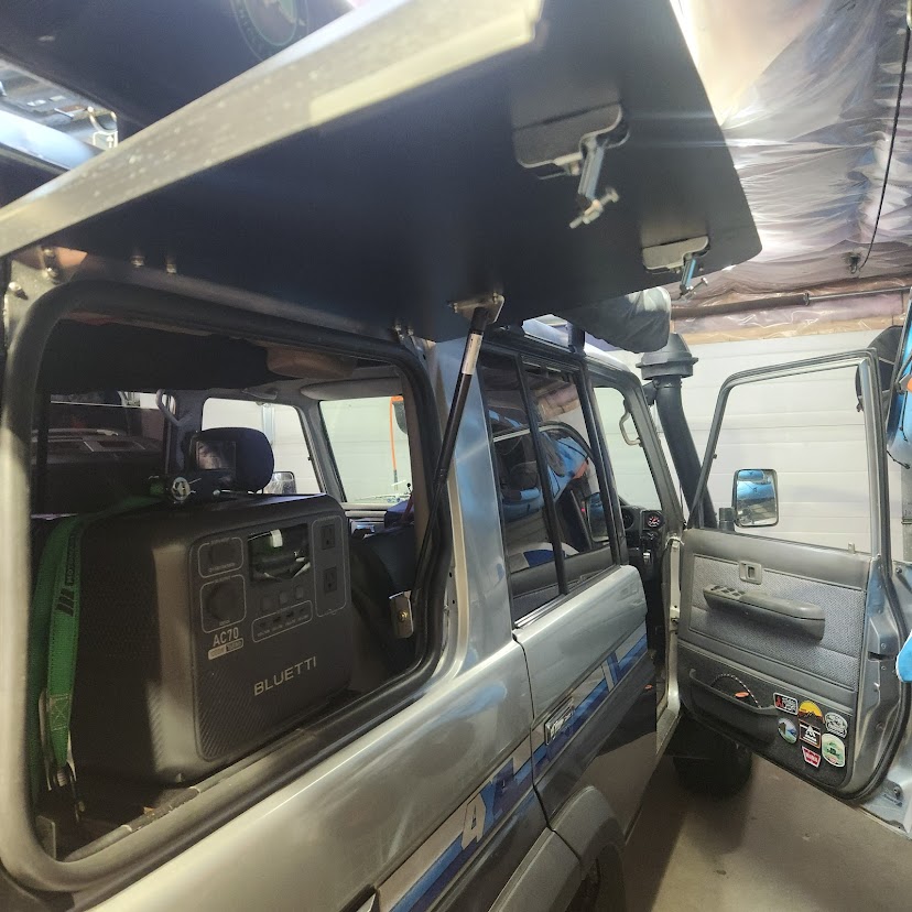

Solar panel on roof (220 watt) as well as traction boards
Bluetti is strapped down on a shelf when you open window. We’ll see if that config stays there…

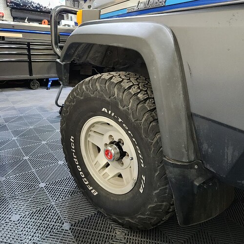

There was a hiatus after this, but last night I finally switched out one of the failing electric hubs from last year on Lockhart Basin to manual. Other one will be done tonight.

I like the scoop Phil. Hopefully there’s at least one angle that looks good to you?
On the plus side, it’s big enough that you might get ram-air effect above 160kph. :imp:

Oh, and the red hubs look HAWT.

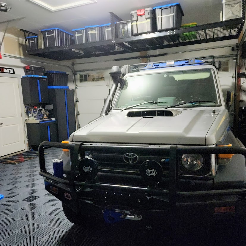

I’ve decided no more projects on truck until garage lights are done.
I also need to sort out some jackstands. My old ones aren’t compatible with the new floor. I need them with little pads under the legs ,(I could just use a sheet of something under each one but that’s more things to find space for…)

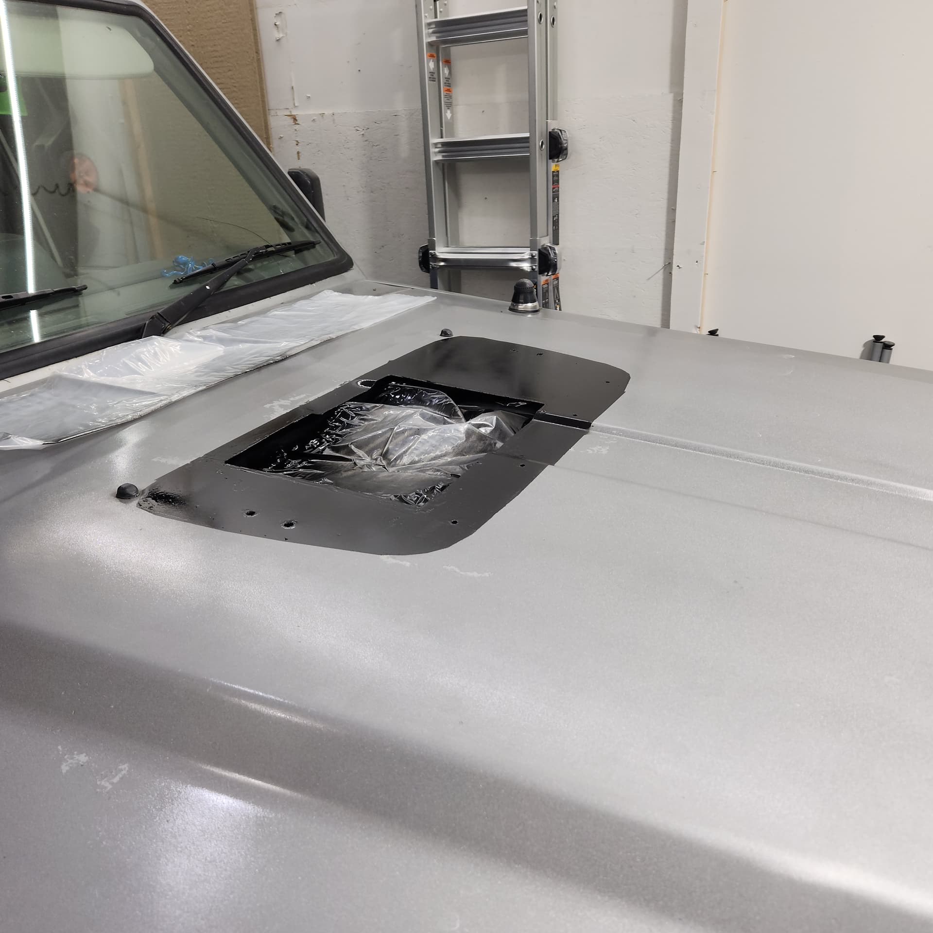

Bought some new jigsaw blades. Also bought some fender flare material. The plan is to cut the hole in the hood bigger to allow the intercooler more breathing room. No such thing as too much cooling once you start compressing the air?
Wow! I’m looking forward to the end result.

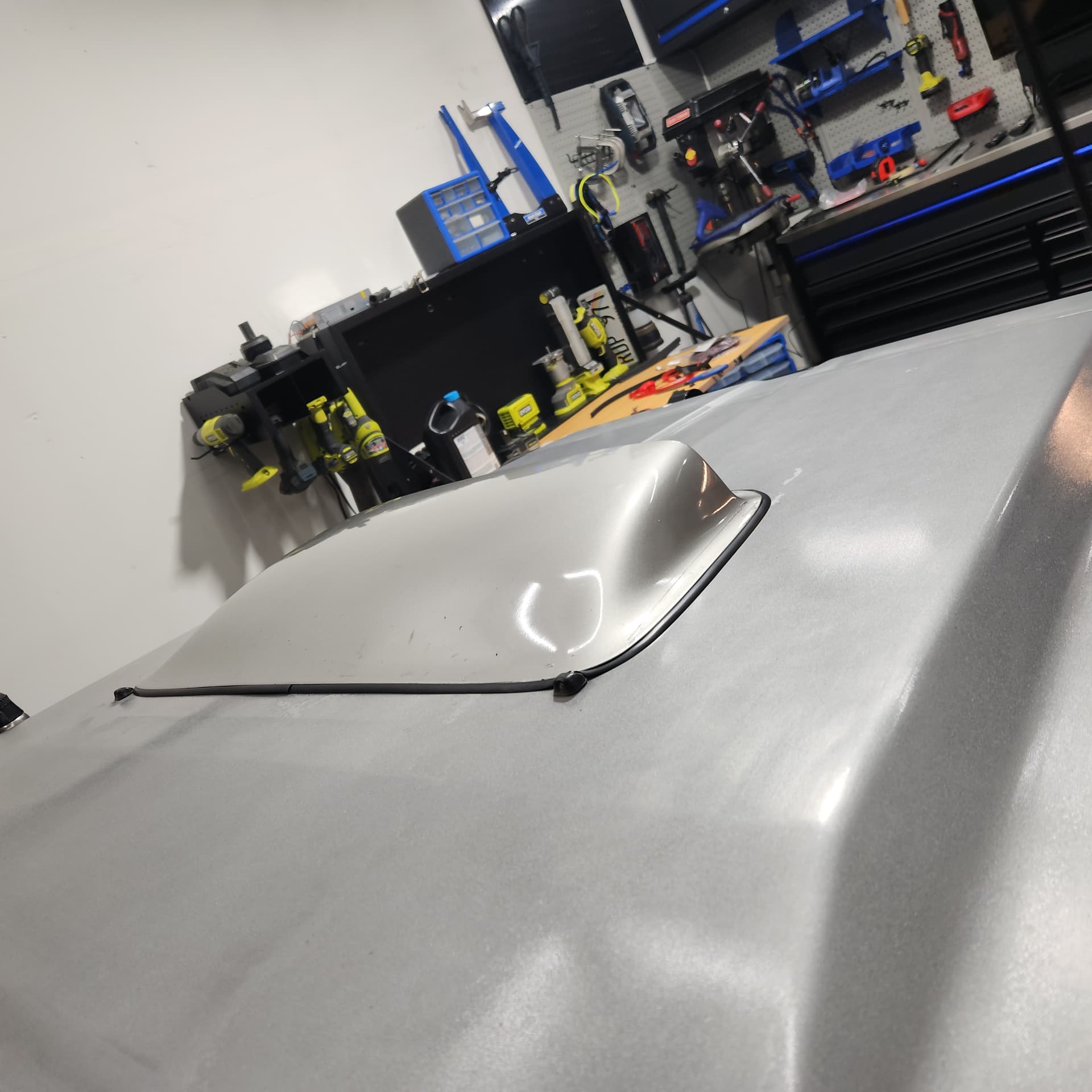

Had to use the grinder. Enlarged the hole. Painted the portion that would remain under the scoop flat black. Applied the edge seal plus new 3m tape. Then carefully dropped it in place. Two screws from the underside on each side. Plus the ones on the front.
Sits much better on the hood and I’ve exposed maybe 25% more of the intercooler to the air passing over it?
May make no difference but it won’t be worse and isn’t that the name of the game with any mod? :grin:
I have to think that a 25% increase in airflow volume through the intercooler is going to make a remarkable difference. Especially on such a low-powered mill to begin with–and this time of year, eh? Surely, a stream of below-freezing air being forced through that thing is going to make some difference!
This time of year is actually likely to yield zero gain, since temps don’t really get up there anyway. Its more southern trips where I’m hoping to gain some thermal room, pulling the trailer up those passes…? But we’ll see?

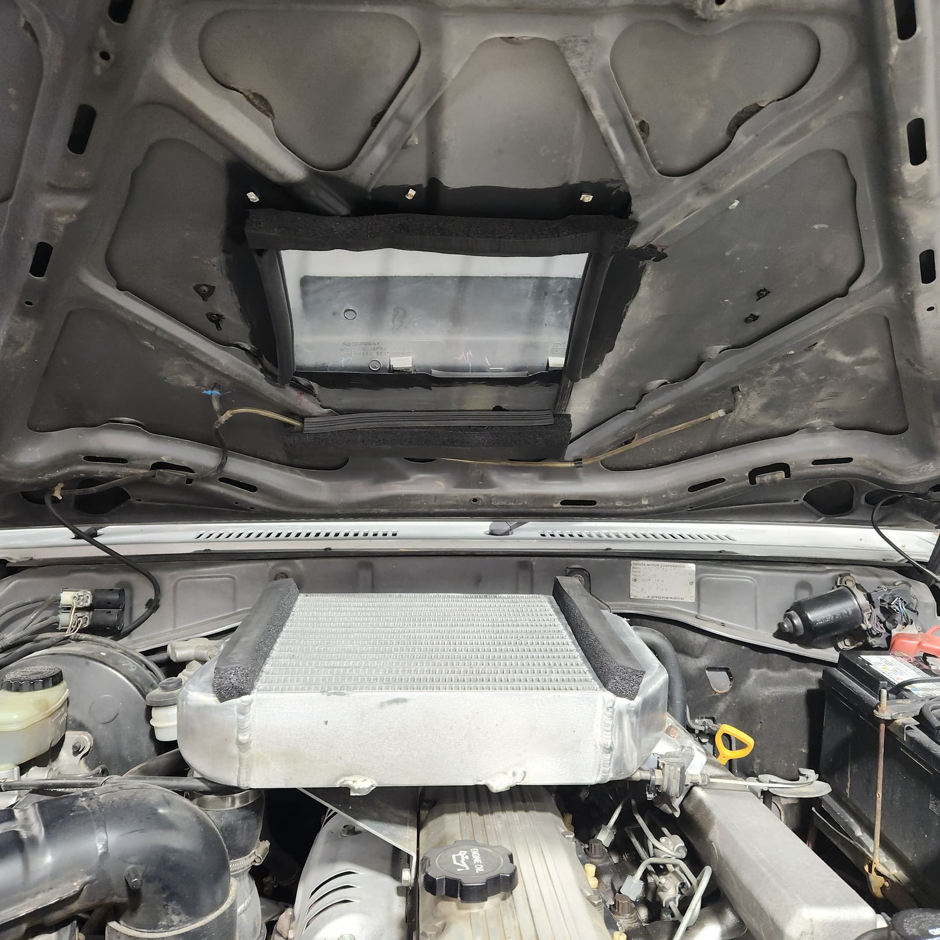

Getting ready to seal the new hole now. Waiting on an edging that has a built in bulb seal. This is where it sits currently.

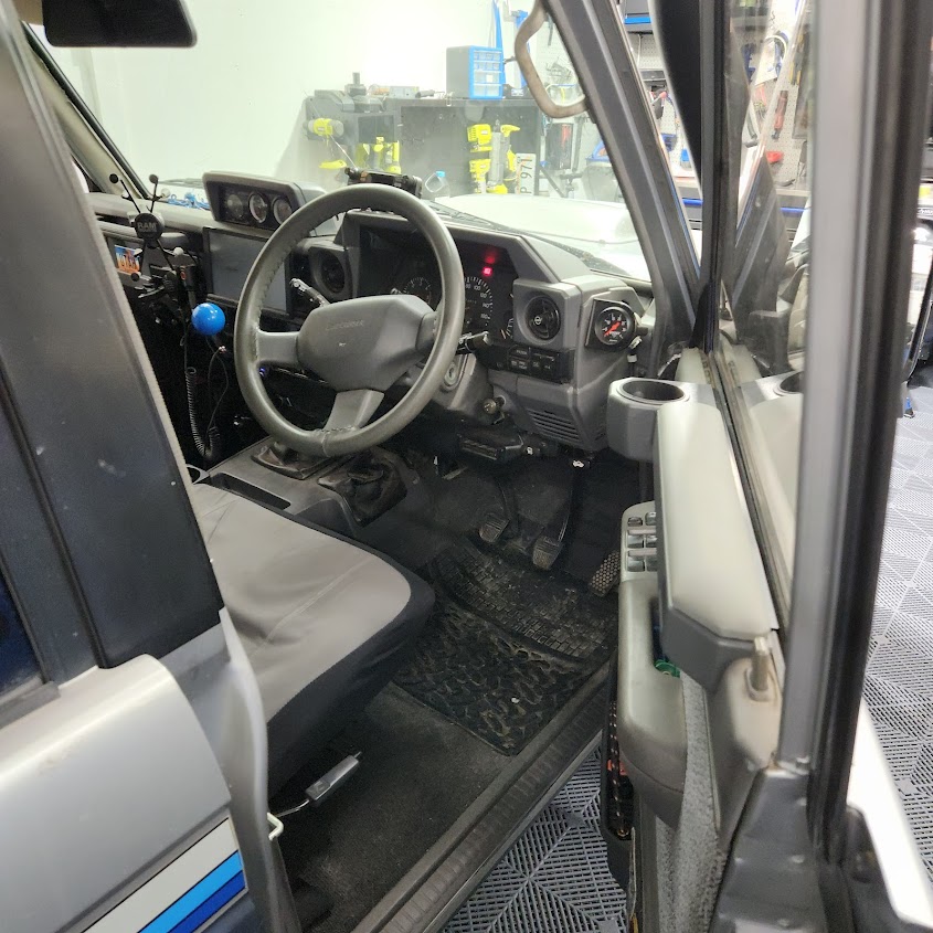

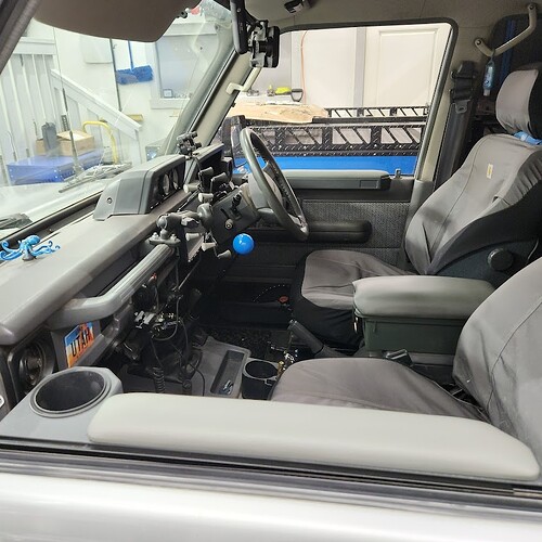

Also, given the relative low beltline of the 70 series, and the high seating position, you invariably end up using the top of the door as an armrest. So of course where there is a need, some company will come along and fill it: Voila! Door-top armrest/cupholders (magnetic on sides, and held by a bracket that slots into the window molding).
Also, update on some other interior mods: The center console (literal) ammo can covered by an aftermarket honda armrest cover has been brilliant, if not aesthetically perfect. The leather steering wheel wrap is holding up perfectly, and the Carhartt seat covers are wearing like… Carhartt’s. They’ve been installed 3 years or so now and are still just like new (might give em a wash?). BIG BALL shift knob has been baller.
And finally, Android Auto on a 10.5 inch screen almost feels like cheating in a rig that is (no exaggeration) unchanged since 1984.
Oh, and in looking at these pics, it occurs to me that my antiquated “tool for war” (its true - look up the landcruiser specials in most major conflicts) now has FOUR cupholders for the front seat passengers. FOUR! :hugs:

IC is now fully sealed against hood duct. Should increase its effectiveness when climbing those southern hills while getting the hair dryer blasted down its throat.
Looking good, Phil!
I feel like TMICs present special design considerations. The massive scoop and seals should do you right by channeling fresh air into the IC, and I suspect the direction and volume mitigate most heat sock concerns–but do you have to take additional steps to also extract more air from the engine bay to prevent pressurization and restriction?
This question feels both asinine and incredibly interesting at the same time. :clown_face:
All those old forum threads about radiator/FMIC ducting and hood vents to create low pressure behind them got me thinking you’ve got 4+ liters of oil-burner cooling itself with whatever it can pull through the radiator.
Made-up math to hopefully clarify what I mean by this?
  • 1000cfm air flow through radiator into engine bay at 60kph
  • +500cfm air flow through TMIC into same at same time
  • If you can’t freely exhale >1,500cfm of heated engine bay air, doesn’t this = restriction?
So curious!
Hmmm. No real shielding underneath (beyond a little deflector at the front to ensure the rad sees its fair share) likely equates to a giant rush of air down and back? Its a long ass engine compartment, and the inline six isn’t taking up much width, so its pretty open overall.
Also, 12 or so liters of coolant, 10 liters of oil, 4.2 liters of iron block/head, and a giant engine driven fan with extra juice squeezed into its viscous clutch means a lot of cooling is happening behind the scenes too…
