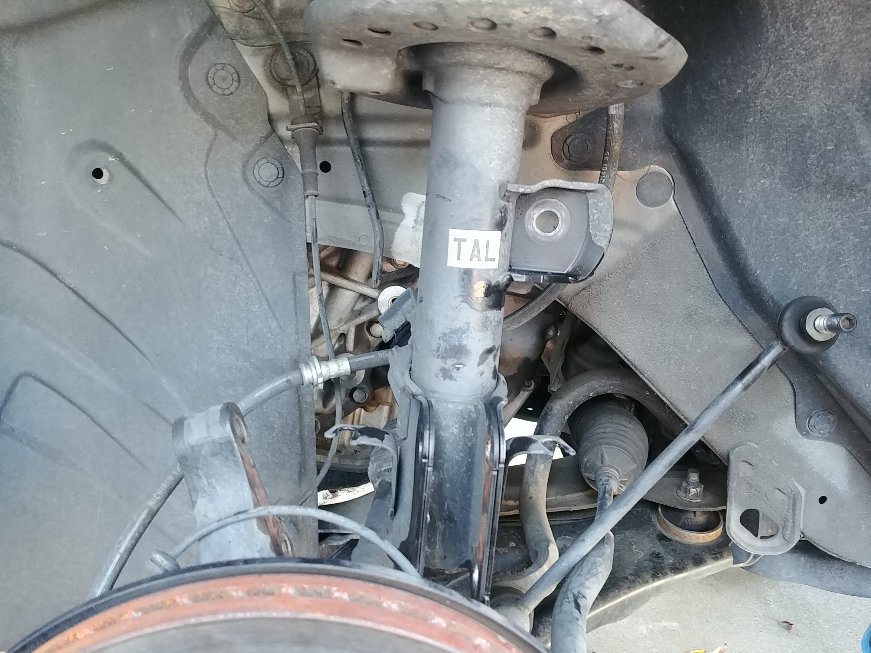

FL Juke strut before
Hit things with PB, mostly because that’s what you do.
FL sway bar end link connection
ZOMG. RUST!
Things came apart real nice down below.
