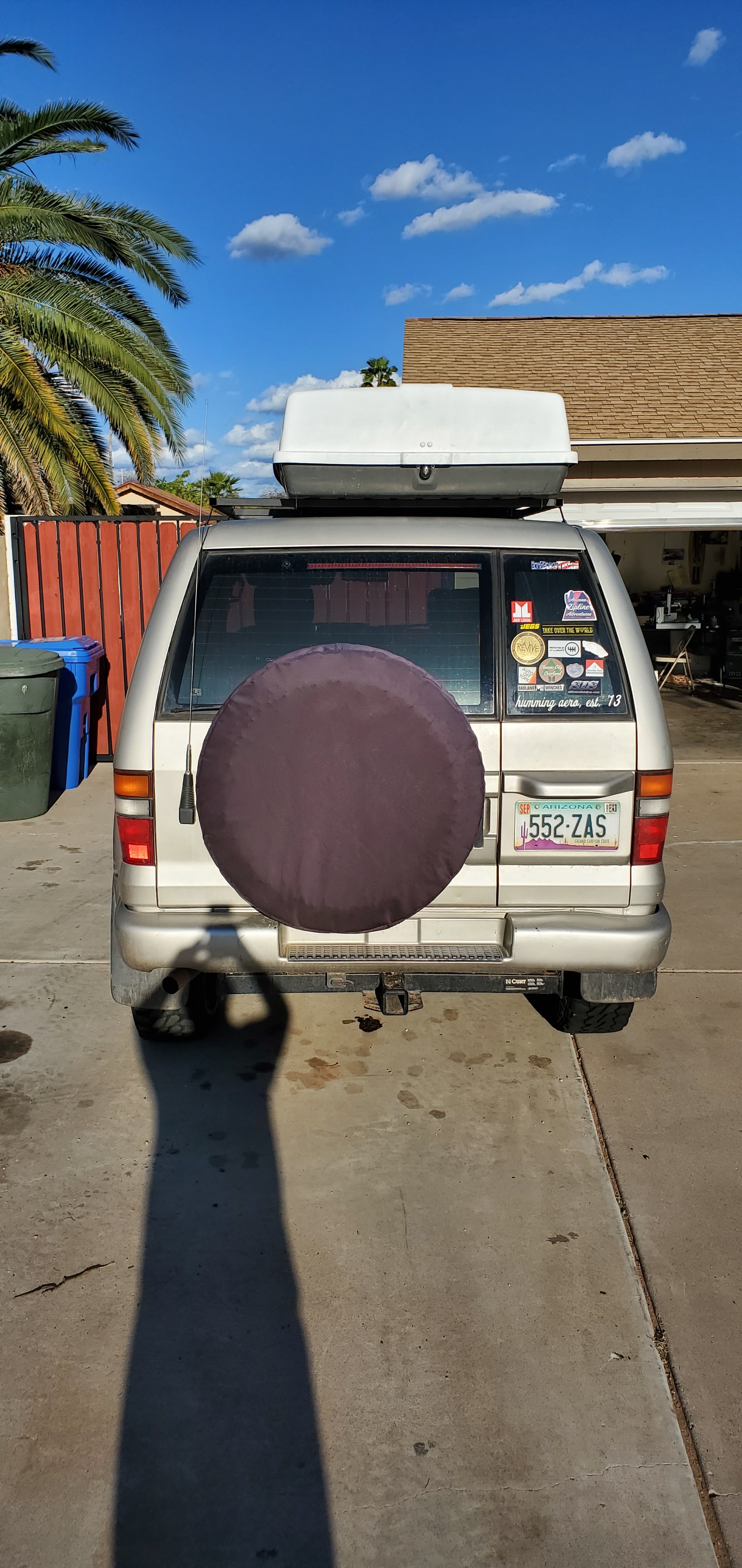

The bar Spacing is both uneven and intentional for a roof top carrier I plan to install.

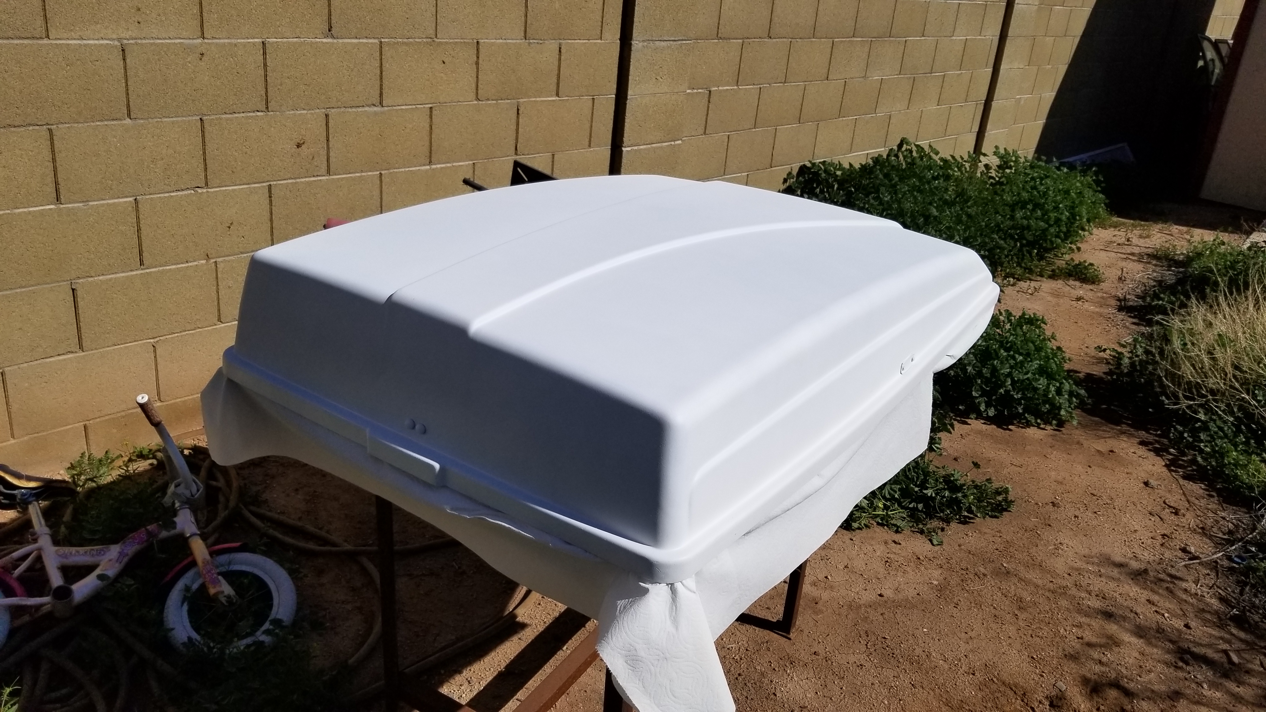

There it is getting a paint job. It’s a small yakima one and it’s OLD but it’s good enough for the trooper.

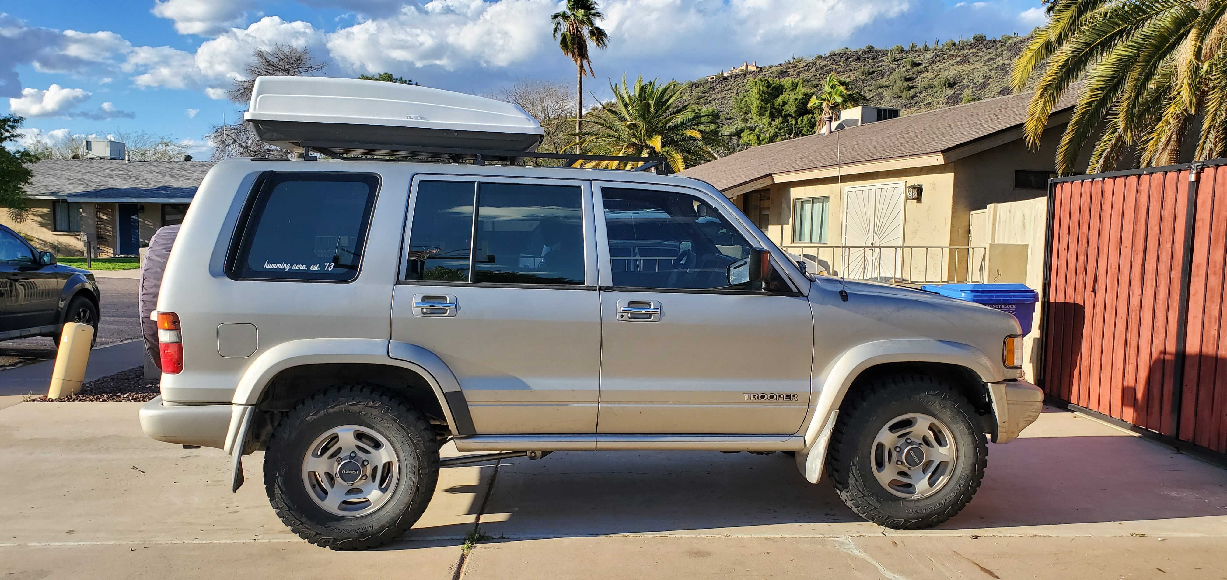

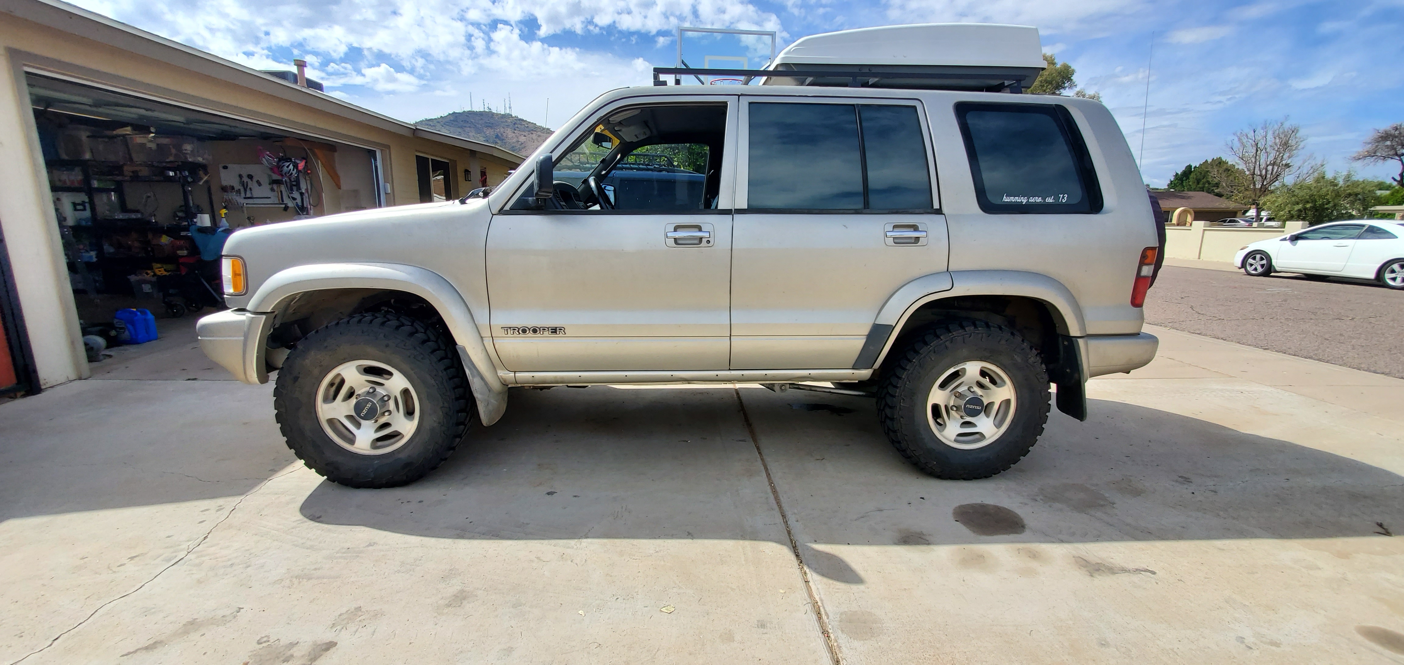

Finally got the roof rack done-ish. I needed to make room in the garage for some other stuff so this had to get a rush job on the brackets. Not ideal but it’ll do. I think that was $50 in steel, $35 dollars for the carrier used on offerup, plus another $50 in parts and paint. Not too bad!
Offset is intentional to accommodate my ezup alongside the carrier and leave room at the front for anything else I want to carry up there.

Truck looks good leveled out. Hopefully by fall I have a trail vehicle to join you with!
