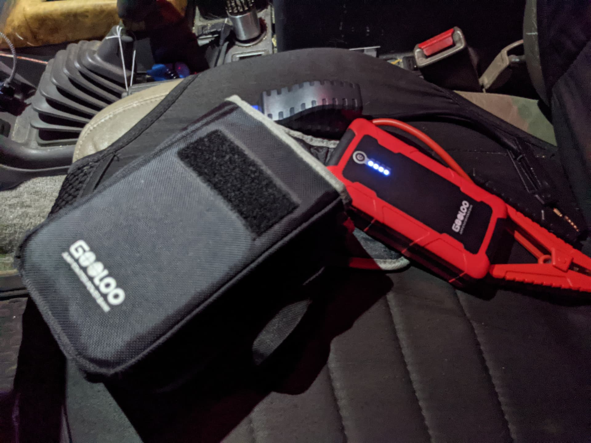

Pro Tip: Get yourself one of these USB booster packs. They won’t jump a dead battery, but it’s the easiest jump you’ll ever get when the car won’t start in the Homie D parking lot. They’re like US$40.
I remembered having to go well out of my way to get this battery, but didn’t have any paperwork or emails for it. Ended up having to check my timeline in Google Maps for 2018-2019, looking for outlier stops in the far southwest valley. Nice to see my data being useful to me once in a while, eh?

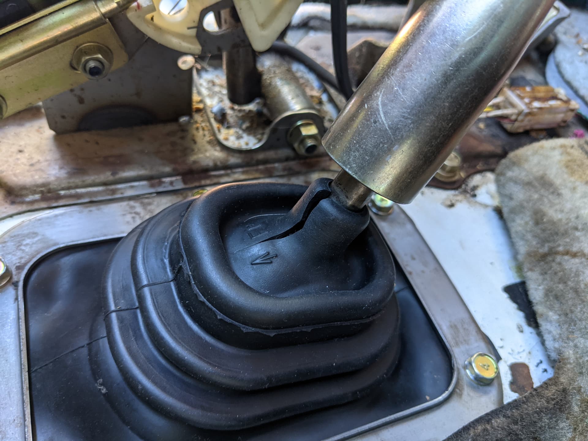

I think it might have been April when I discovered the tcase leak. Ernest said there’s a gasket on top where the lever goes in that’s almost always cracked and he didn’t think mine was that far gone.
What followed was a good four hours of careful disassembly, cleaning, and resealing. Took me so damn long I forgot where a couple electrical connections went. (Seriously. No idea. Just gonna wait until something doesn’t work.)
(Didn’t have time to clean further.)
Here’s a couple shots of the cut and fix I made to get the tcase sealing boot over the fulcrum. Das Boot just has to keep the elements out of the cabin. In the spirit of British auto manufacturing in the 90s–That’ll do.
