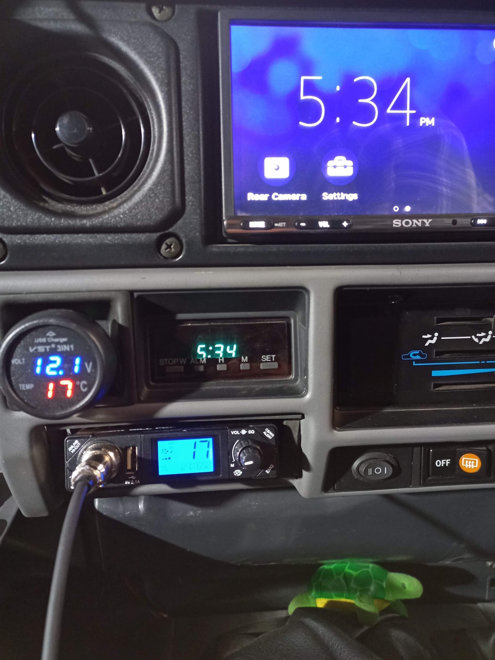

-12v in dash for CB/charging from rear battery made tricky by the fact that I want it switched with ignition. I made this work using a 24volt relay to pass through the 12v source when 24v ignition as powered. That enabled this …
24 volt socket is now instead a switched 12v socket and meter/thermometer/usb charger is plugged in and reflects state of charge for rear battery.
Former ashtray is now tiny President Bill CB radio, because sometimes it’s still the method of comm.

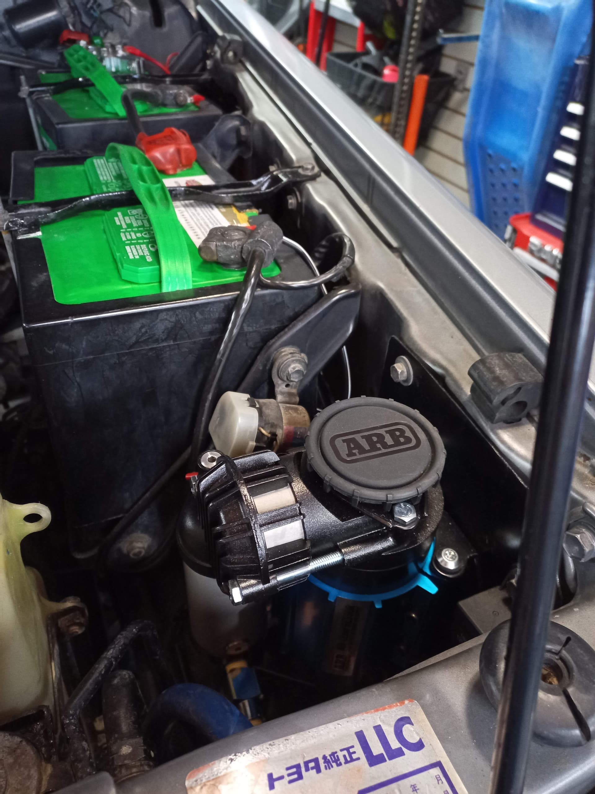

ARB compressor install is done. Ended up buying the q/c. Hose kit from ARB. Worked a beauty…
Airline connects where headlight washer used to reside.

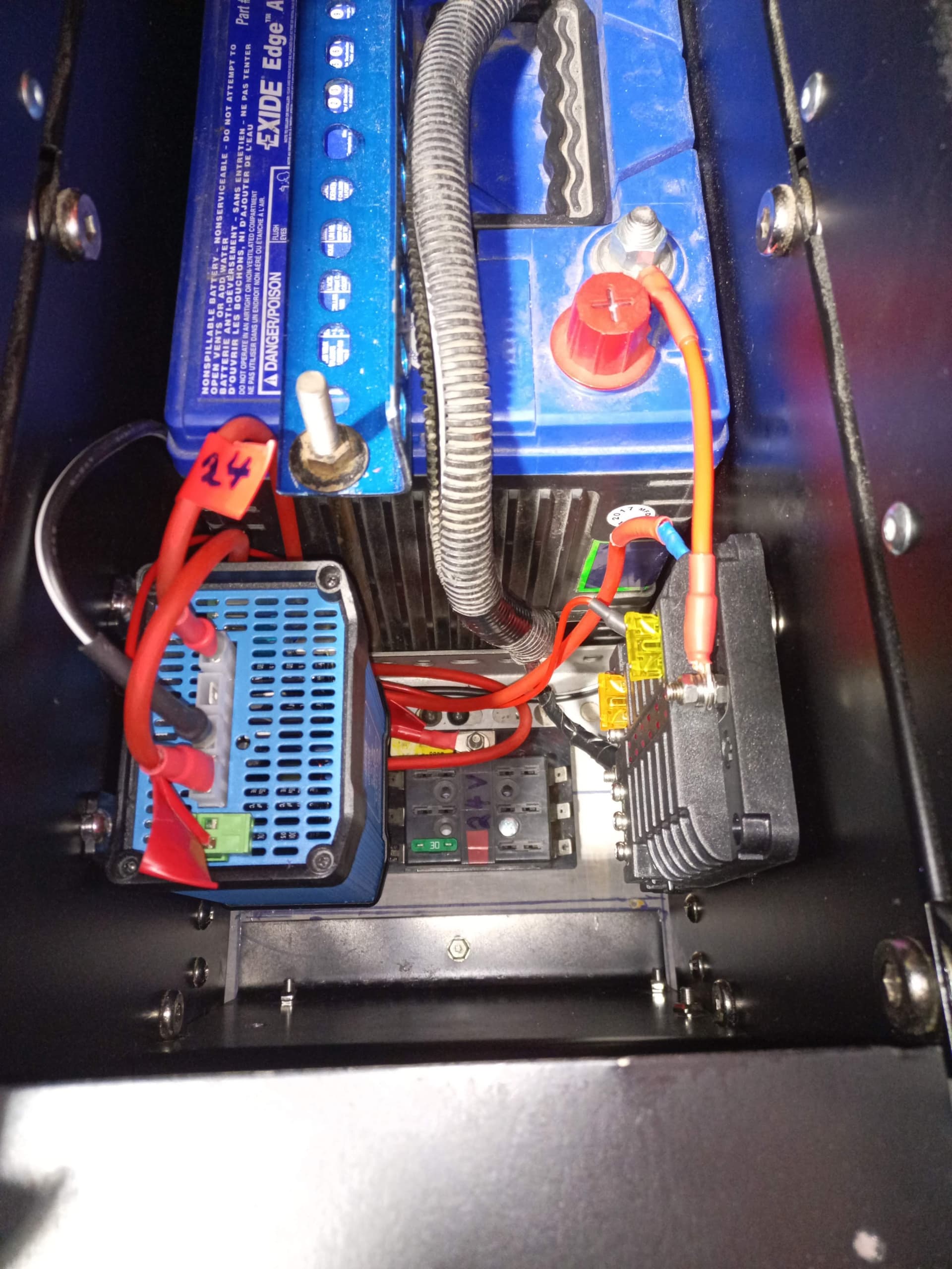

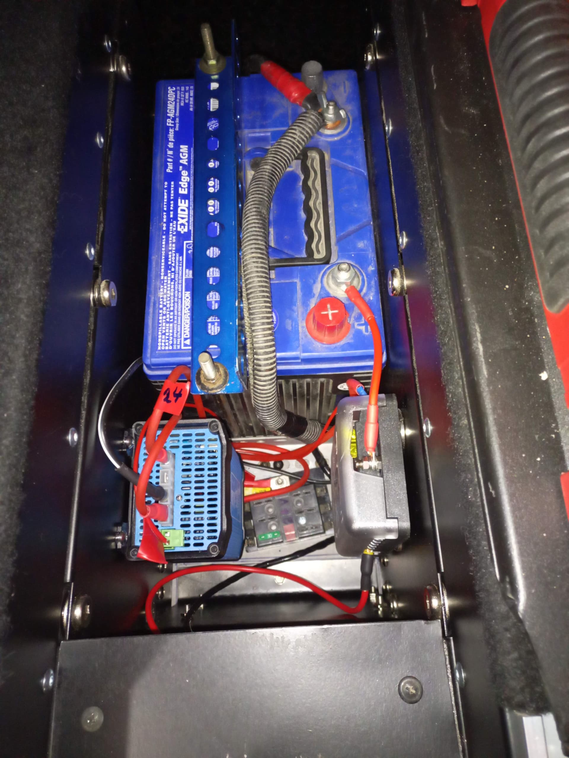

Now I’m back to the back. 24v>12v converter is getting installed so I can finally charge the aux batt.
It’s a tight space so it’s taking some rearranging to get it right,…

Phase 1 complete!
LHS is 24>12 converter. 24v fuse panel on the deck. 12v fuse panel on RHS. Here it is with cover panel…
Switch panel: Right rocker activates the LEDs along with the two sockets and voltmeter. The others are idle for the time being.
I am sincerely jealous of your wiring space. Those neat little cable runs look so clean. I love it.
In fact, if there was one automotive project I want to do more than anything else one day, it’s a clean slate wire harness. There’s a parallel universe where I’m one of those guys doing ridiculous, mil-spec harnesses.
Thanks buddy. I feel like it could be neater, but it’s coming along. Originally I had the 24-12 converter on the deck in the center but there was too little room for the hookups and I was afraid they would be under too much strain. One bonus now is that I can access the pot that allows me to adjust the output voltage under load to optimize it for AGM battery charging.

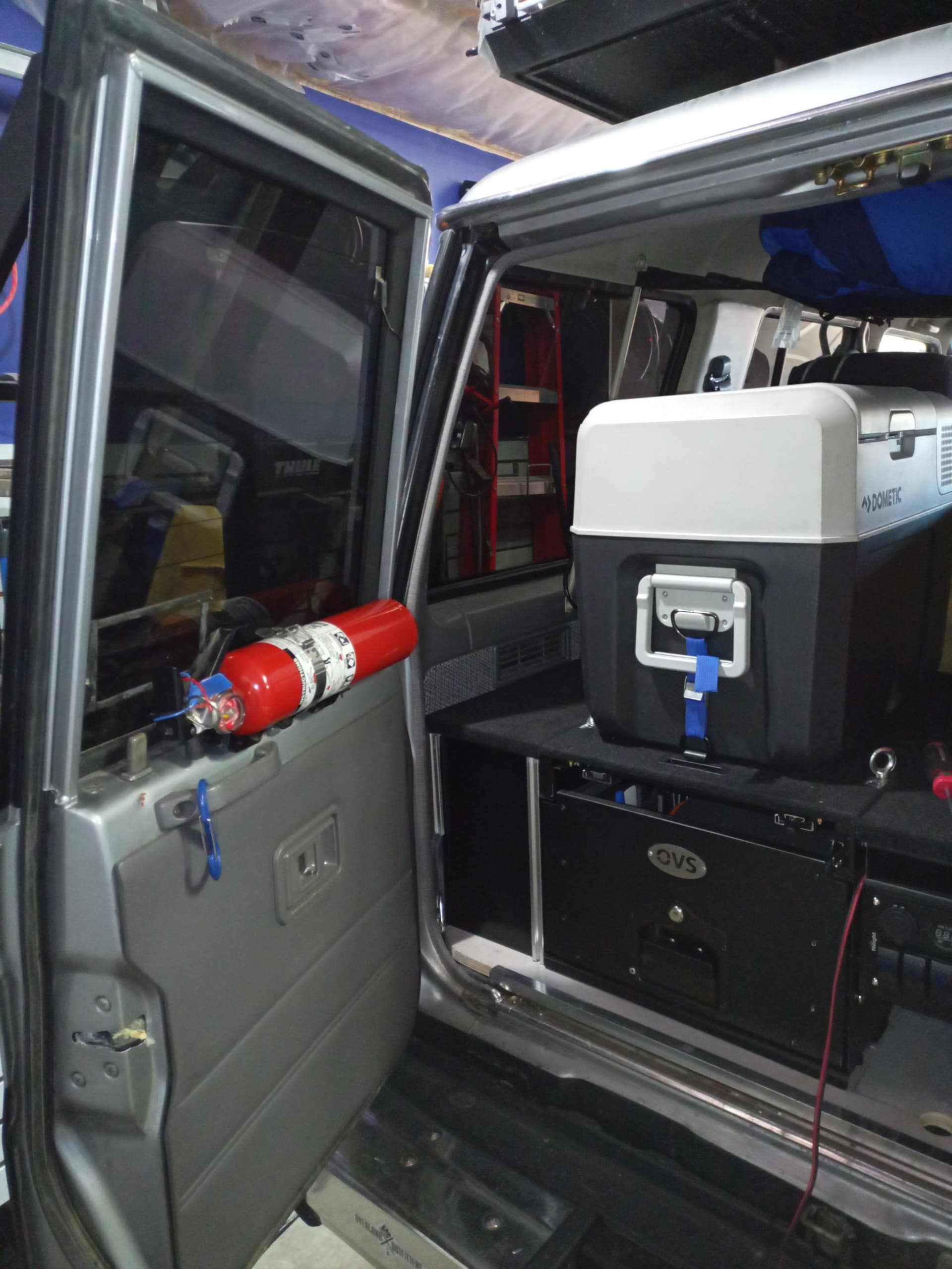

Mounted my extinguisher on LHS back door. Didn’t like drilling the sheet metal but a nutsert won’t hurt, esp if I need to put out a fire. :crazy_face:
I like the extinguisher mount. I have an Element extinguisher to mount there that’s stuffed in my glovebox these days. (I’ve never had a traditional extinguisher that wasn’t dead when you checked it.) The Elements seem like a better idea.
Agreed element is a great choice. I’ll likely get one eventually. This one on the back door is because I’m cooking with gas back there. So having an extinguisher literally backing me up seems a good idea. :joy:

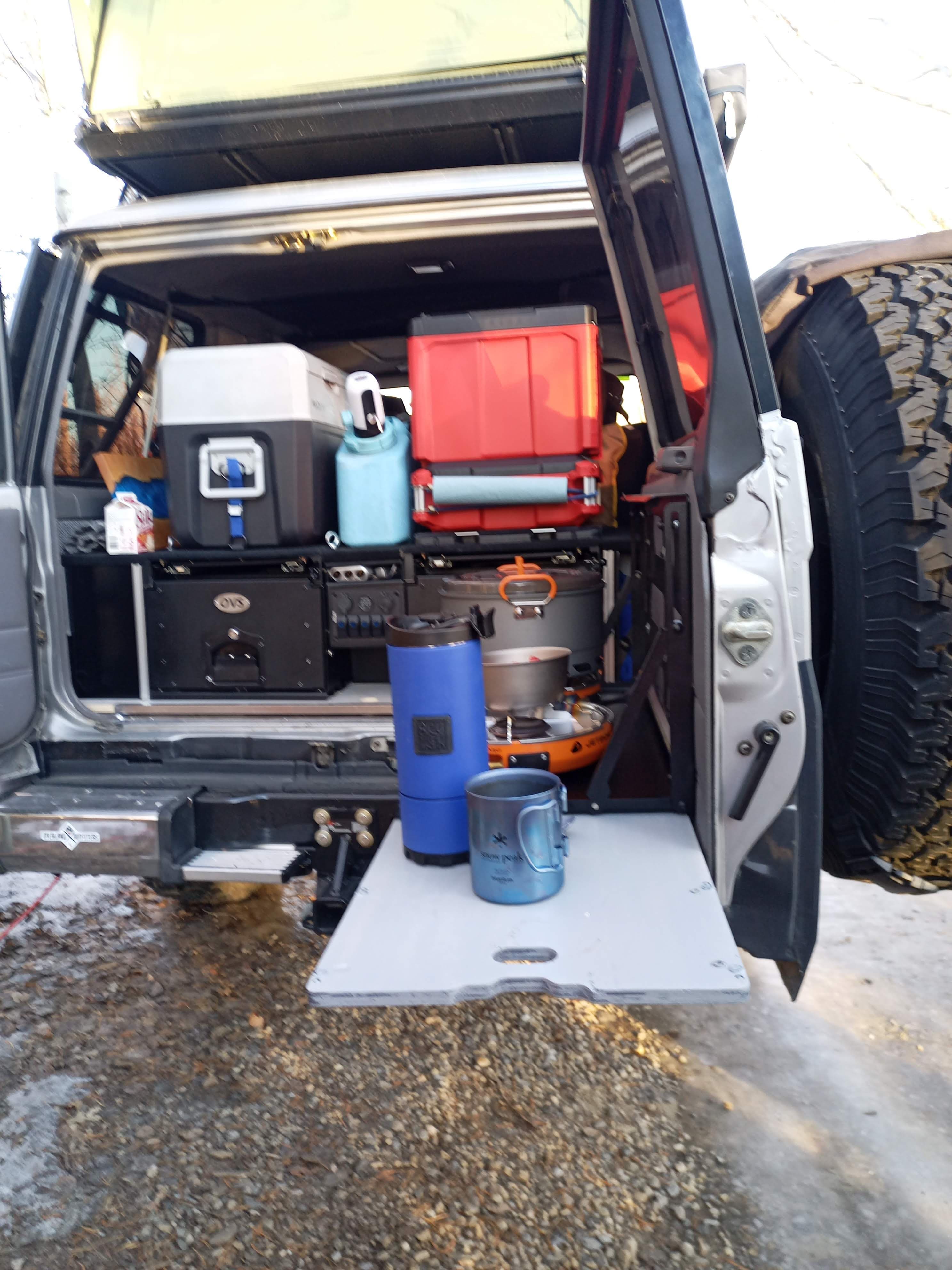

We did a little picnic in the park yesterday. I made coffee. Getting used to where things are and changing where I put things, every time I use it to get it dialled.
So Banff, then? :stuck_out_tongue:
Looks like a good time. I’m looking forward to getting somewhere like that. The dream has always been a setup I can deploy inside of five minutes. I mean, it goes all the way back to my Delica dream. Roll up to a good spot, pop the hatch and the awning, and be sitting on the front porch with a drink in-hand inside five minutes.
Still running well? Looking forward to spring?
I’d say it’s under 3mins but yeah. Exactly like that.

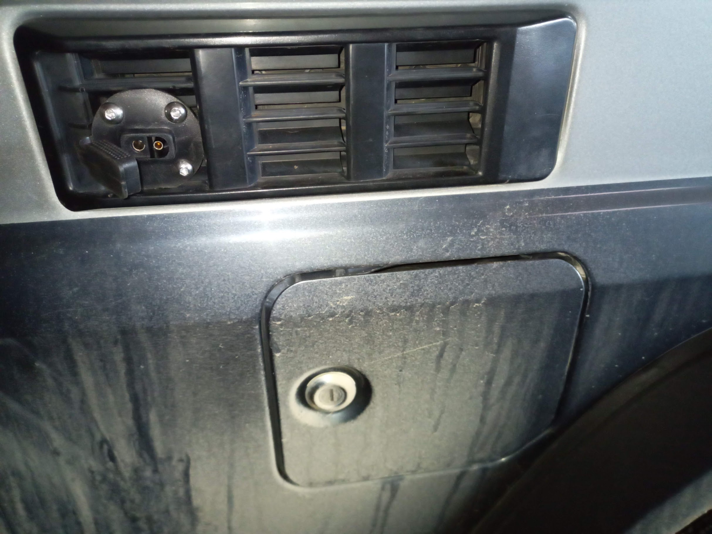

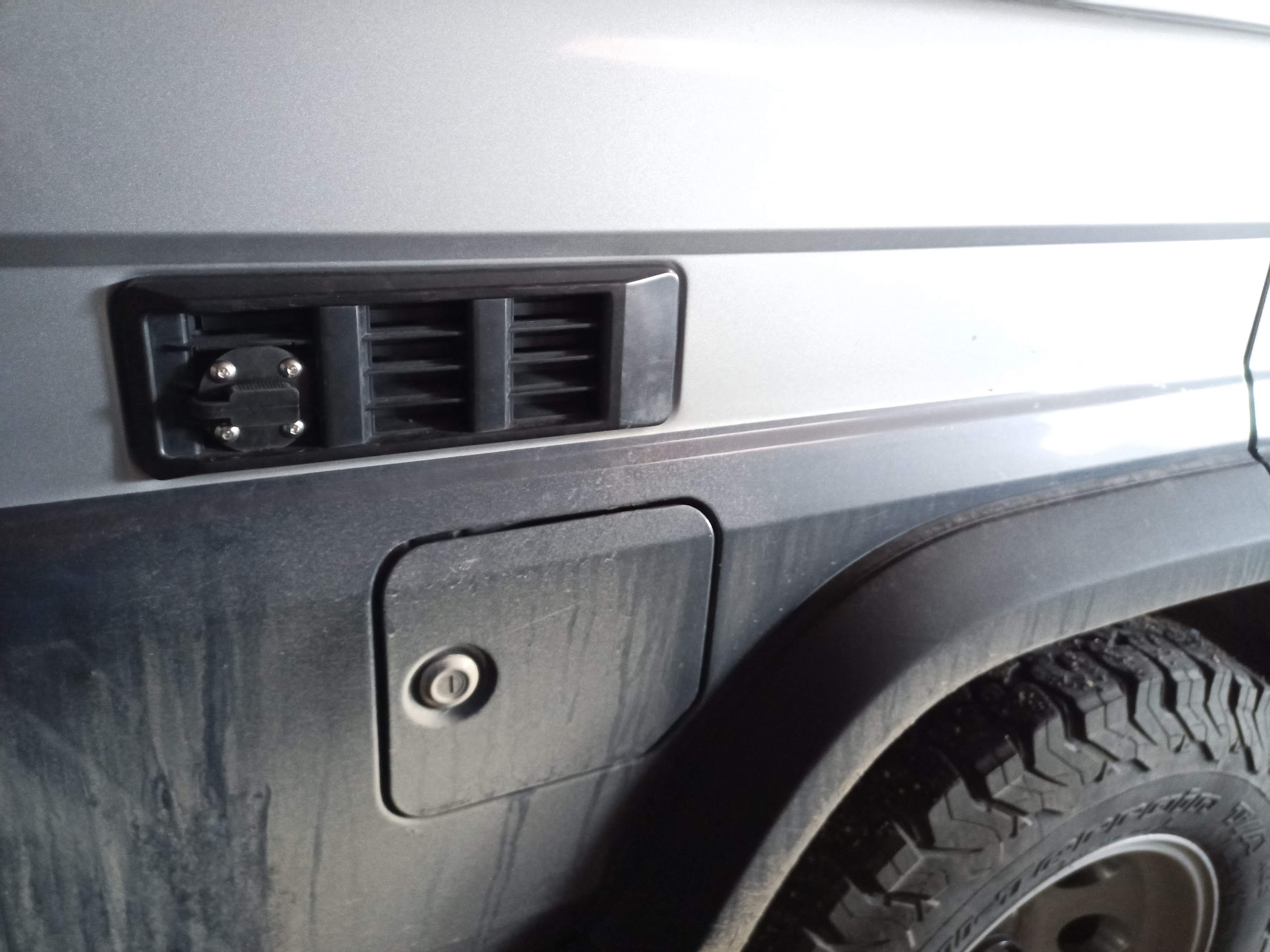

Electrical port now installed on the port side of the rig. Used a minimalist SAE socket, but with 10 AWG backing it up inside, with a plan of powering temporary lights on the outside and lights inside the RTT, for starters.
That’s excellent. I’d like a weatherproof, external socket or two, myself. Something topside for roof mounted accessories, but also at the rear for similar.
10awg is pretty stout!
Routing wire to the roof is a challenge, but if you have a snorkel its way easier!
I got an SAE adapter yesterday so now I can power two circuits… One will run into the tent, while the other powers lights off the side.
You had me looking at snorkels, man. Haha.
I’m still planning on pulling the interior and headliner here pretty soon to noico all the things and run power where I want it up top. Just gonna pre-wire as much as I can while it’s all out. (Maybe run some small PVC conduit? I dunno.)
