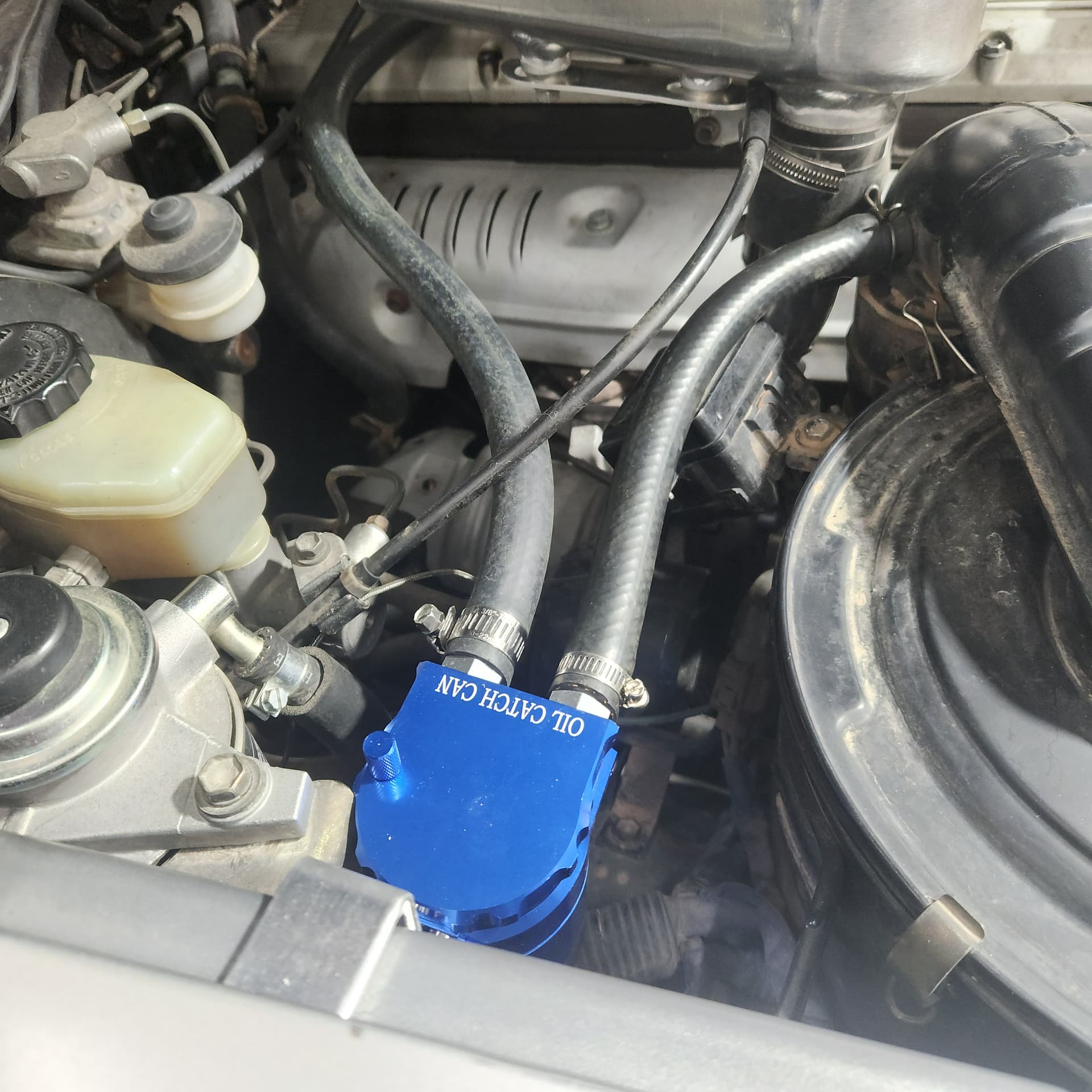

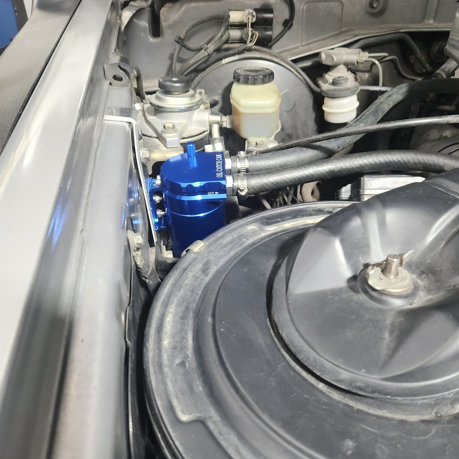

I’ve had a little oil misting here and there since adding boost. And more noticeable with the intercooler so I thought I’d route the valve cover vent into a catch can and see if I can reduce it a little…

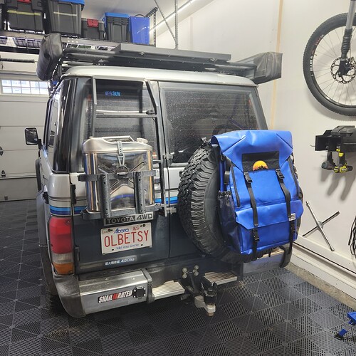

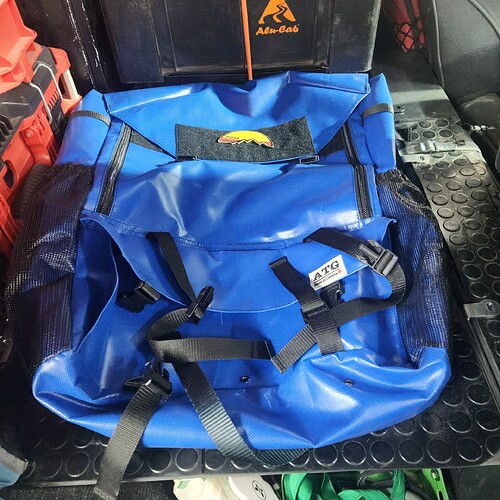

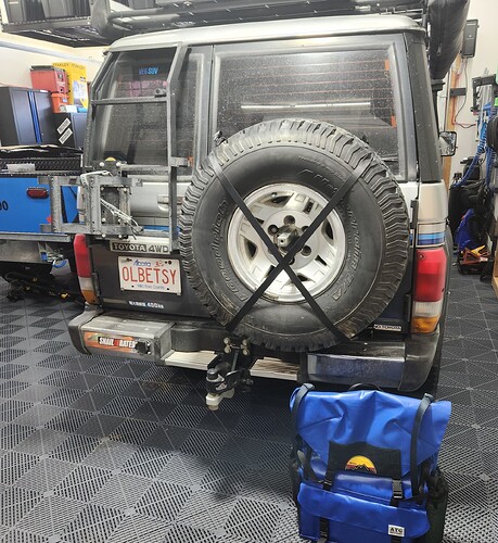

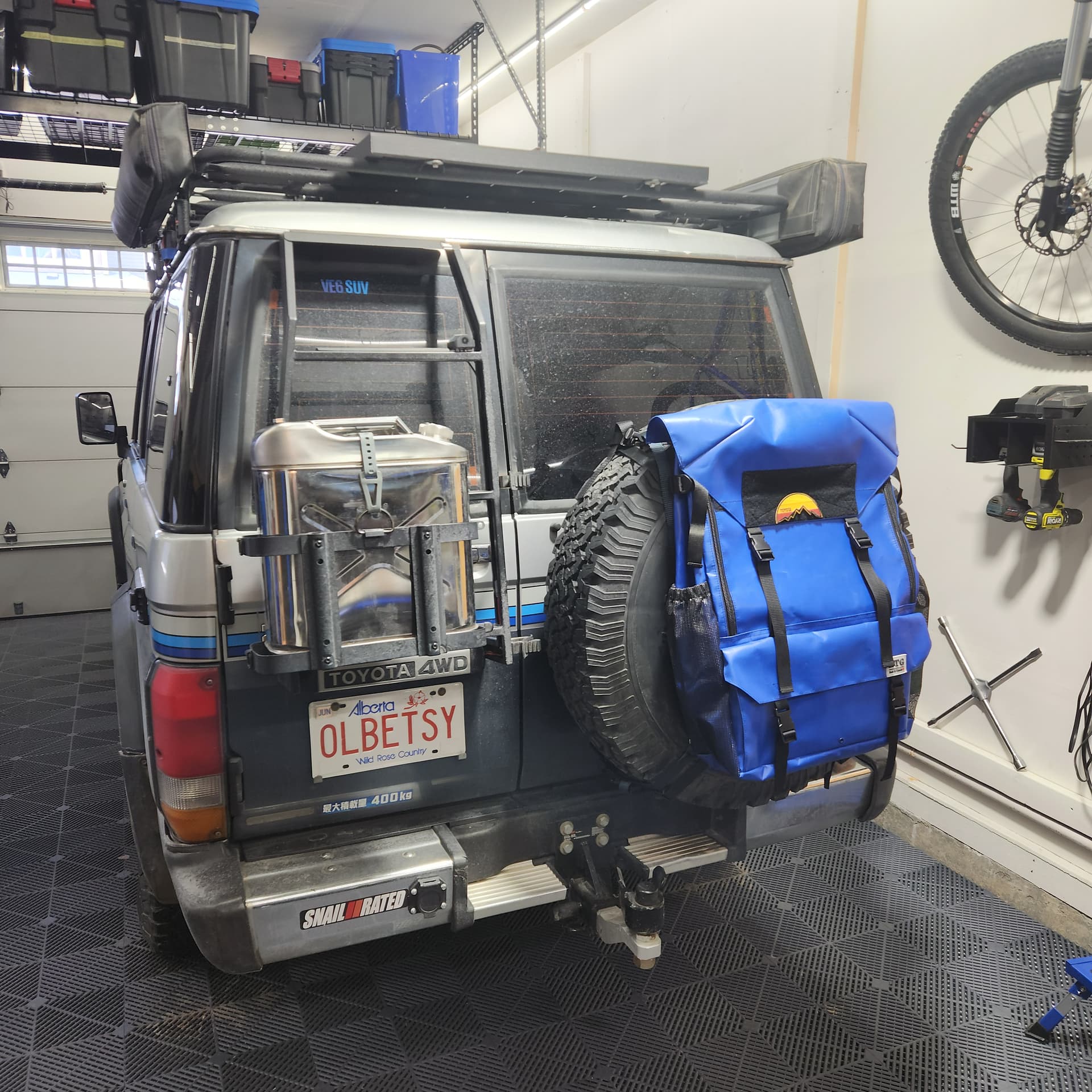

Also, my new spare tire bag came. Hand made in New Brunswick and looks really good on first inspection.
More feedback after I get it on the back.
Hand made, you say! That’s LEGIT!
So you install the cross straps first, and these have small straps sewn in with metal clips.
Then you take 30 seconds and hang the bag.
Great material and some good pockets.

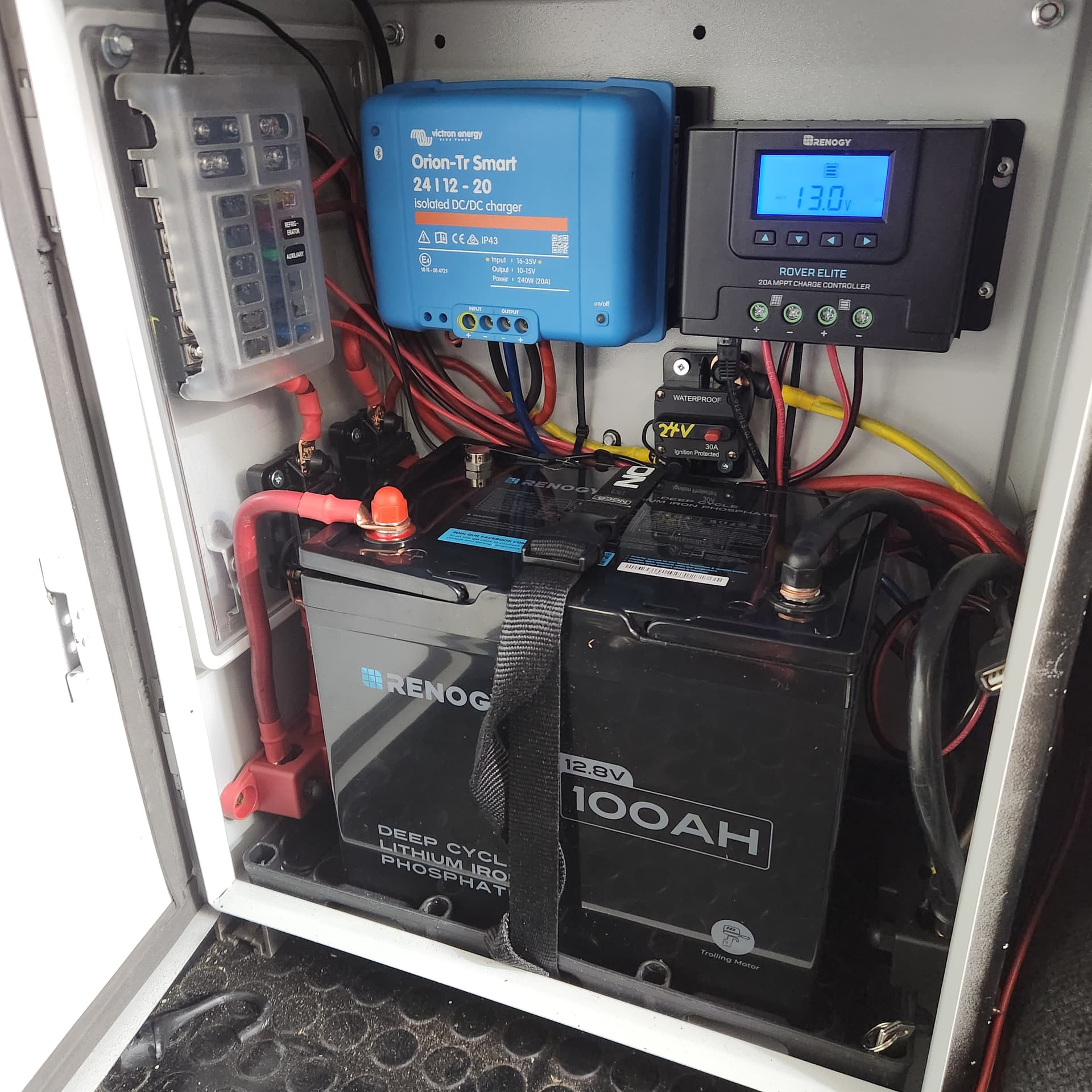

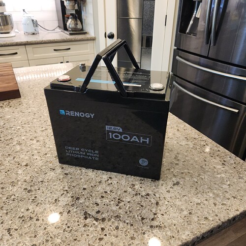

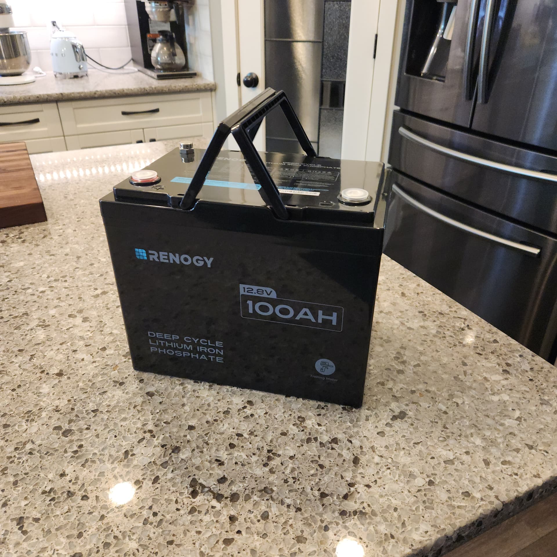

New batt arrived! Renogy gr24 100ah 12v
Super light weight and lots of usable power.
These all have BMS built-in, right?
One of the few areas I like the thought of things getting “smart”.
So apparently not all do but this one does with Bluetooth connection. It also has temperature protection etc.
Climate control? I can see a heater, but does it have fans too?
No fans. No heater either. I didn’t want the heater because it uses up power. It is thermally protected so if the temperature goes too low it won’t allow charging. That was good enough for me.
When I put it in the truck and checked the app, it showed 43 amp hours. Who knows how long it was sitting in the box after it was made? I drove to work and back which was maybe an hour and 40 minutes total? Maybe a little less? I’m now sitting on 99% and 103 amp hours. So it seems to charge up fairly quickly.
