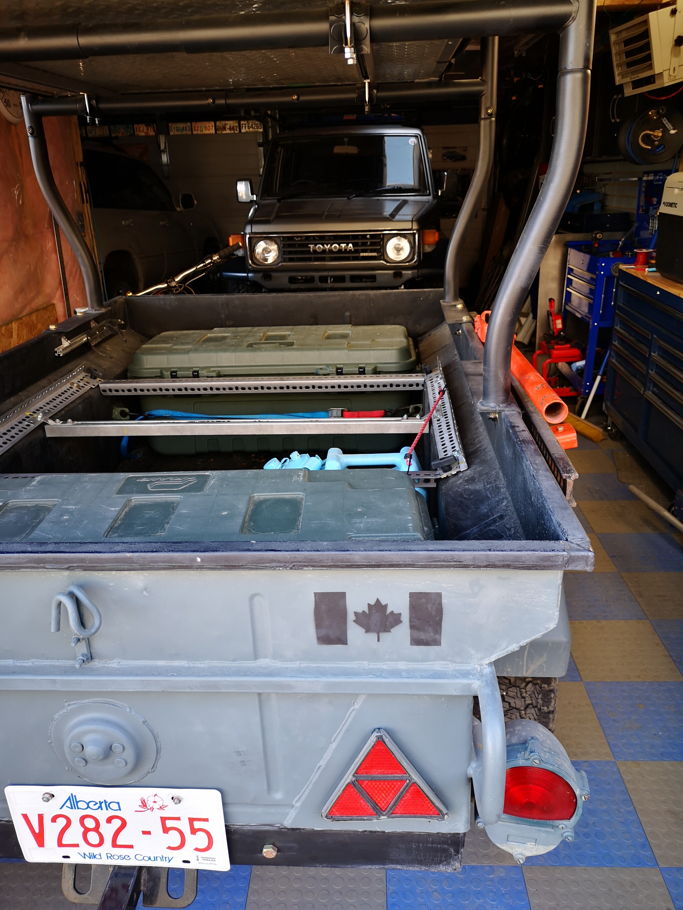

Updates… My M101CDN2 trailer had been retrofitted with 12v bulbs, so of course I had to switch them back. Thankfully some of the spares that came with my truck had the right combo of bulbs. Job done. But that is only half the battle. I am in the process of wiring a trailer harness. Got a 24v unit, and have the rhs indicator left to run a longer wire to, and I’ll be ready to tow. Well, electrically, anyways. Still need to get some safety chain eyelets.

Trailer wiring is done. 24v control box, hidden in the floor compartment and trailer now has 24 volt bulbs again, like it did when new.
