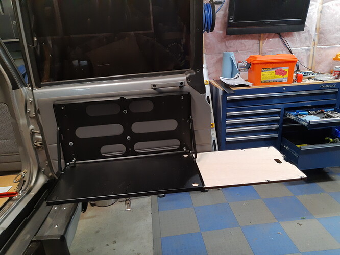

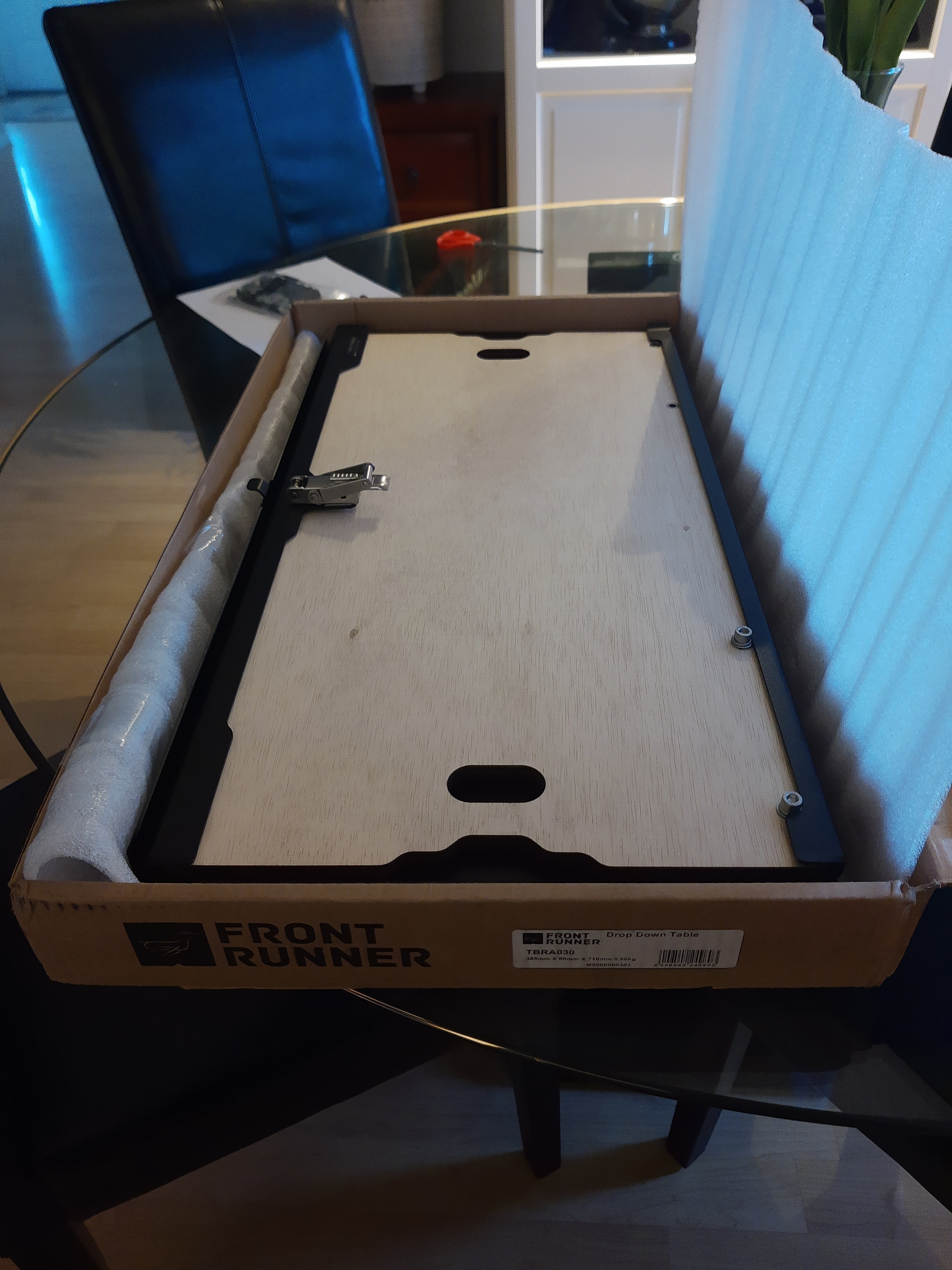

At long last I have myself a tailgate table. After agonizing over which one to buy, or even building my own, I ponied up for the Frontrunner drop down table. Two things really stood out on this model…
-the slide out undershelf
-the HD brackets to hold the table in lieu of cables
I’ll install it soon, but my thus far in-box examination says it’s a worthy addition!

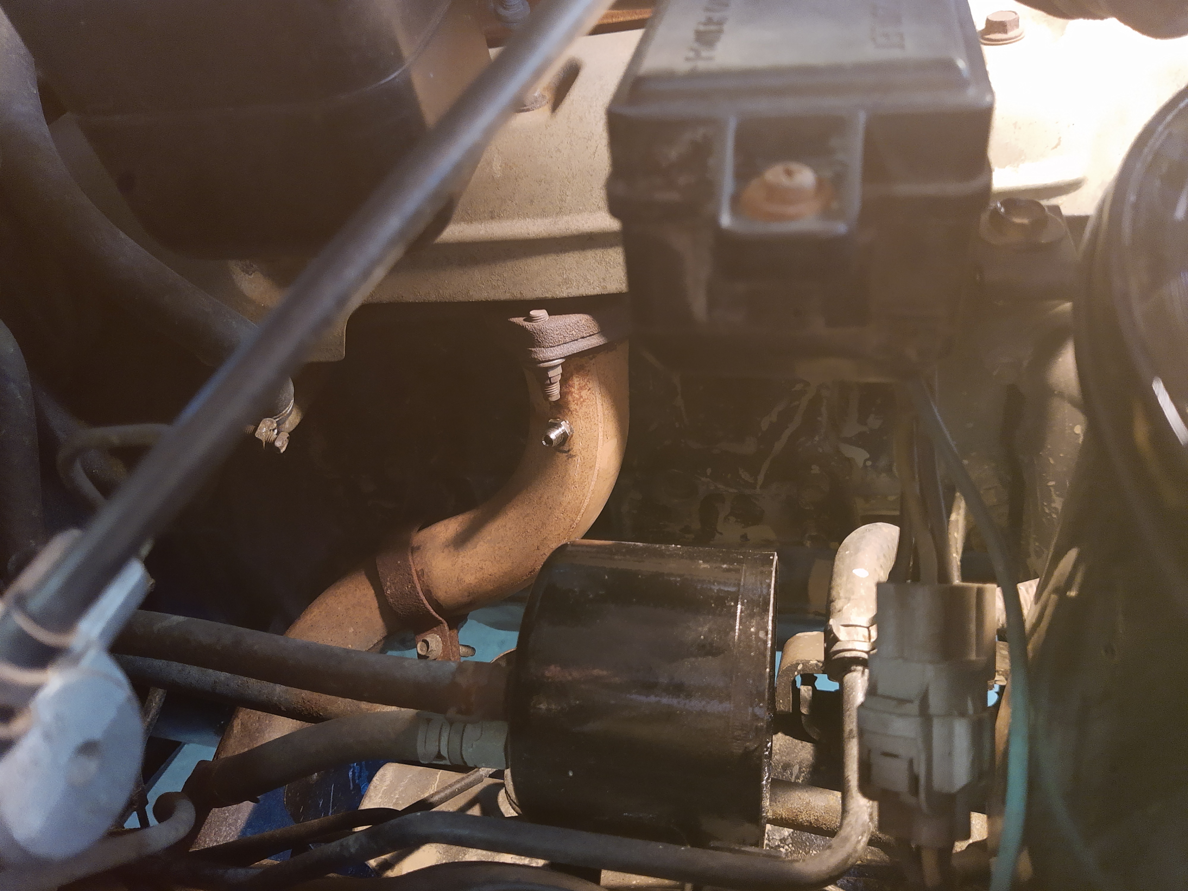

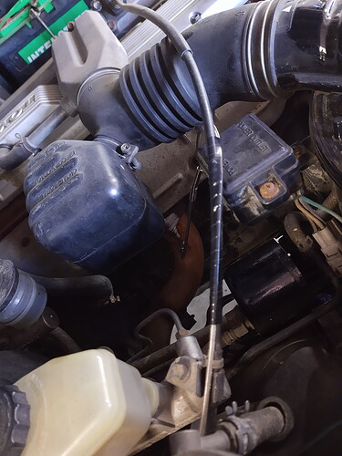

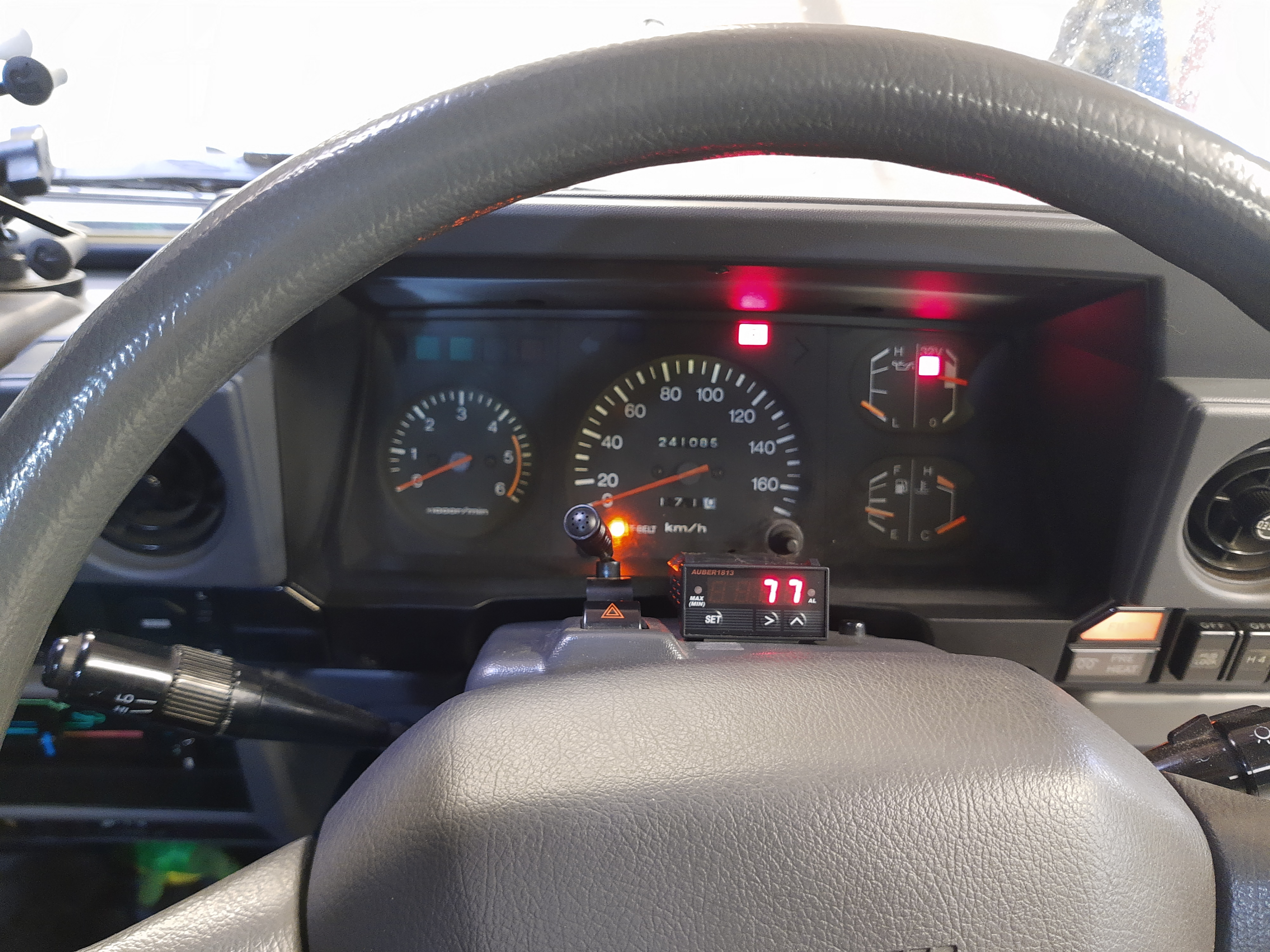

EGT! It’s in. Tapped a hole in the downpipe, “before turbo”. Get it? Before tur… Nevermind. Kissing face with closed eyes
Tapped a hole, carefully threaded the NPT bung into my NF hole. (Pretty sure there’s a smart alecky comment there somewhere, but I’ll take the high road). Routed the harness through a firewall grommet.
Found some power, some earth, and reminded myself 5 times that the thermo couple wanted red on the negative, NOT the positive (on the auber unit).
Then I wrapped the wires to make it a little less raw on top of the steering column, hooked up all the wires, fixed the red wire that I STILL put on the positive terminal (LOL) and gave it some juice.
I’m assuming it must be a good connection, because it immediately queried my ECU and recognized that it was a 77 chassis. Displayed the number right away.
Now just need to get it out for a good drive and see what ridiculously high temps I was blissfully unaware of, previously. If they go too high then I’ll change it to Celsius to bring them down. See? I know stuff…?

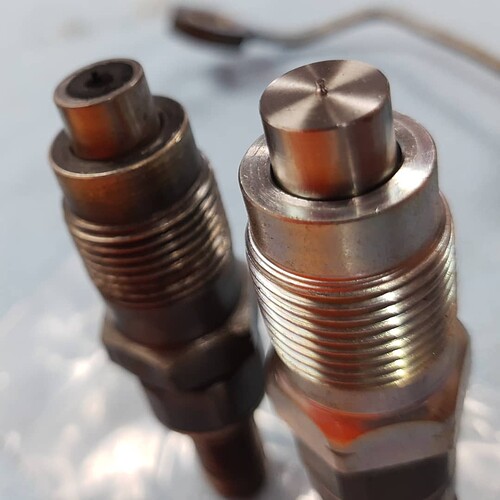

Annnnd… I just dropped a grand on 6 new injectors. Ouch.

Diesel injectors are a wear item. There are places that can rebuild em, but for a little more I just figured what the heck. I needed six of them too, not just four.
Honestly, a grand for six injectors is actually pretty good. Direct injection style injectors are usually way more.
Parts on this rig have been, on average, the same as what I was used to in my mitsus. And even more available…
Not gonna lie, until your reply, I had misread it as “6 grand on injectors”, not “a grand on six injectors”
How do you know the old injectors need replaced? Just age? EGT tuning not going as planned?
Egt’s are high. Injectors are old. Above a certain rpm the clatter sound changes. Lots of smoke. Not great power output. All things that point to injectors.
I’ve had rebuilds before but I’d be close to the same price and instead I’ll get brand spankers. Should improve the performance a lot.
New injectors are in and I’ve put about 500kms or so on them. Absolutely different truck.
Less smoke. Less clatter. More power. Less downshifting. Better fuel econ.
It’s a win win win.
Before I placed the order I checked with the previous owner. He told me in a nutshell not to waste my money on new injectors. He ended off this way:
“They all smoke. It’s normal”.
Yeah well. I guess everyone has a different view on what they’re willing to accept as normal.

Made a baseplate of 3/4 ply.
Installed a dropdown table.

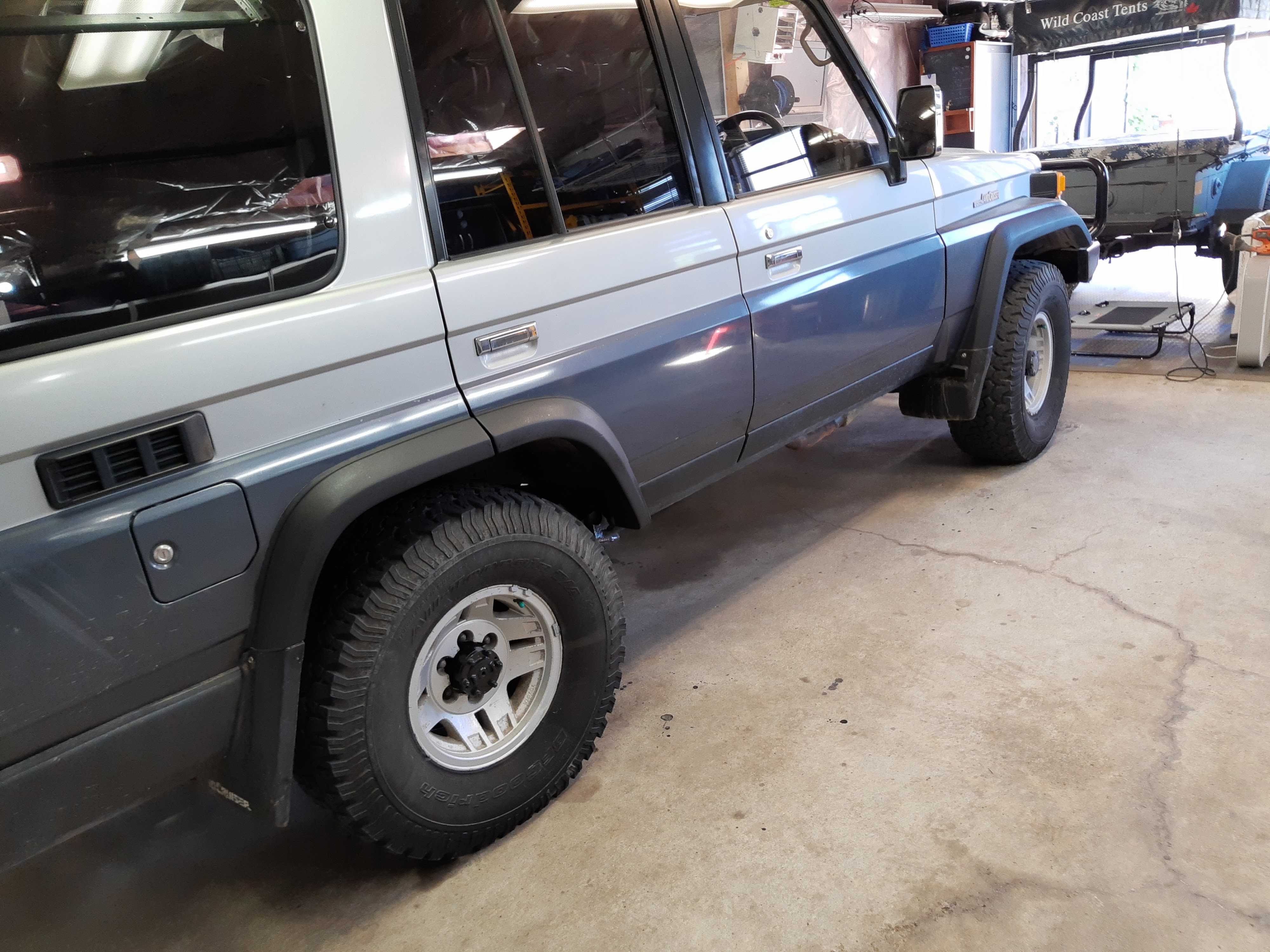

And finally, after much debate… Painted the flares satin rubberized black, to cover the peeling clear coat. Much better…
Getting there…
Dude. She looks excellent!
Thanks buddy! She certainly is making progress. Today I used the last of my por15 (right down to the last drop) to do some tiny touch ups here and there, using a tiny brush and in some cases the end of a skewer.
Some visible places needed to be silver once the por15 dried, so I top coated with what I had left in a factory color matched can…
And then… Before I knew it I was temporarily masking with Scott towels and broadcasting my diminishing rattle can over the recently sanded hood! I had wetsanded some of the peeling clear a week or two ago, but today I just started spraying. Lol. The hood is still a patina display, for sure, but most of the peel was either feathered in with the sanding or now invisible under my dust coat.
It’s patina that I can live with for now. Looks weathered, yep. But not neglected, which was how it looked previously, if that makes any sense?

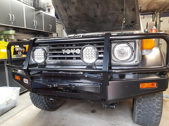

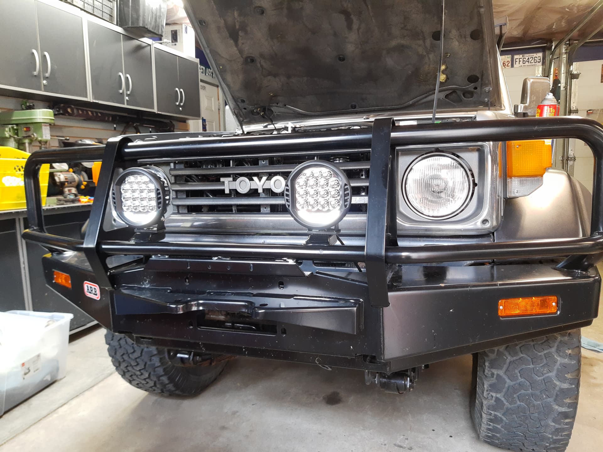

So my dad and mom are here for two weeks. Dad saw all three vehicles for the first time (what can I say… It’s been a busy two years).
First thing he noticed was that the new ARB looked “bare”. So he immediately instructed me to get lights. Lol. He paid. Have to keep him happy… New hella 500s inbound.
NICE!
Looking forward to the install.

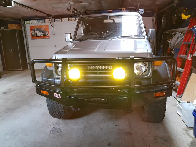

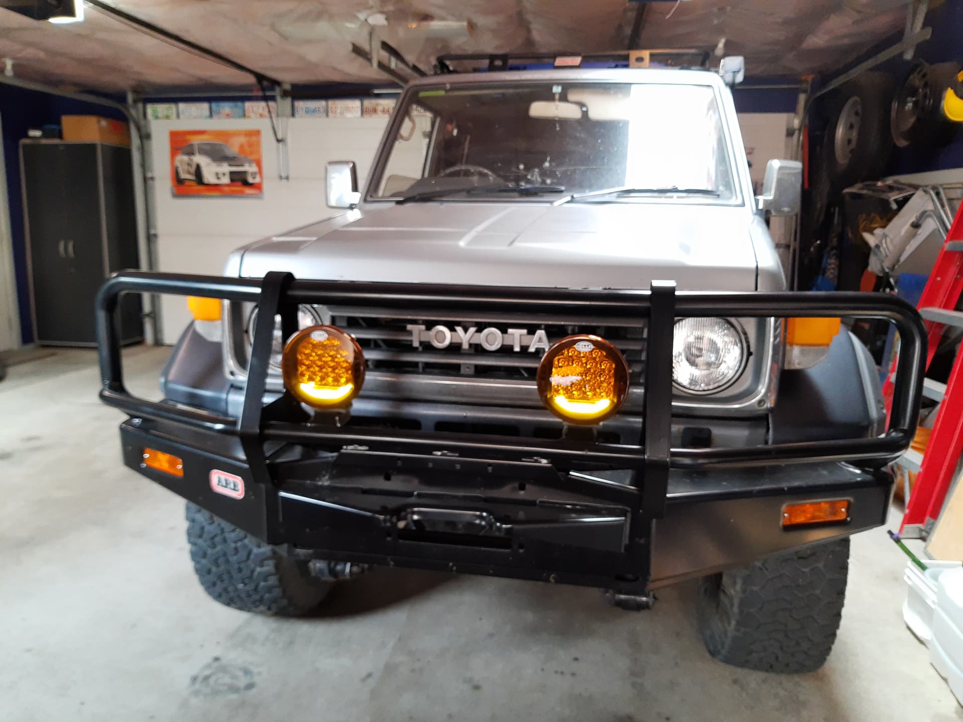

Due to the magic of Amazon, they arrived today. These are not your old 500s, of which I had at least 3 pairs over the years. Nope. These are led, heavy, metal, substantial lights with small DRL type lights at the bottom as well, controlled by the (included) three way switch.
These are special for me because in addition to being hella 500s, they are rated to run on 12-30 volts! This is important when your electrical system is in fact, 24v!
So included was the wiring harness (complete, from switch to lights) the lights, and large fasteners (look to be SS) to keep things from rattling loose. The only thing I overlooked was the fact that most would be using them as 12v lights, and therefore the relays are… You guessed it! 12v!
So now I’m waiting for my new 24 v relays.
