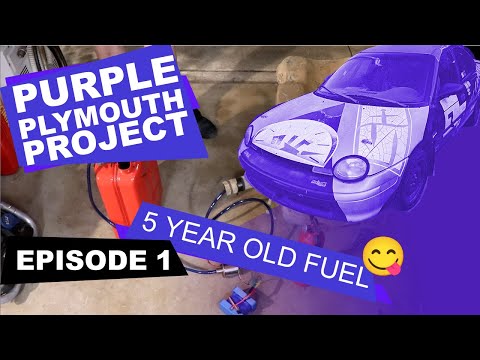

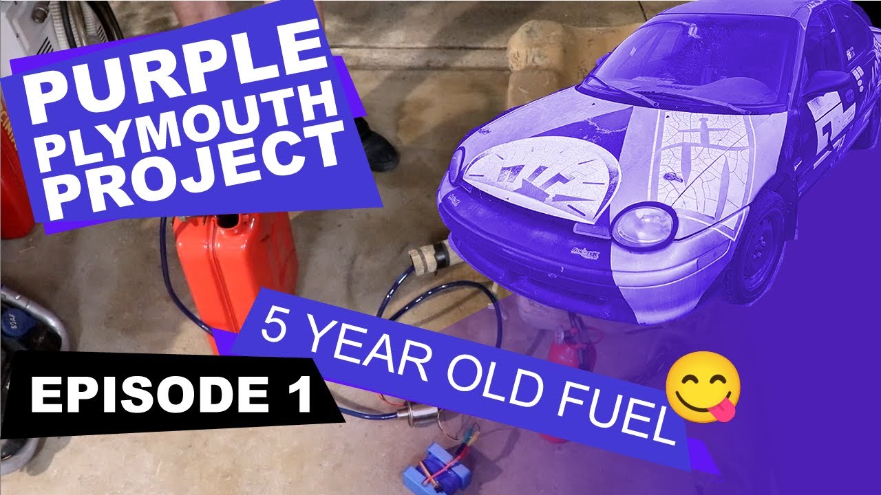

If you caught our last video you know that we’ve collected an old project car that’s been sitting in a field for about 5 years. A bird, some mice, and many other creatures seem to have taken up residence in the Plymouth. Chewed bits, droppings, and UV have taken their toll, but all is not lost - we’ve got a super beefy roll cage that was built for future regulations, a TeraTrip rally computer, maybe salvageable Cobra Seats, a “run when parked” SOHC 2.0L, and a set of Bilstein inverted struts.
I did make a joke about rabies, but seriously, you don’t want to breathe any of this stuff in. After I dropped the front skidplate - I put on a respirator. I “evicted” the current tenant, and slid the contents of his grass home into a contractor trash bag. There are some tricks to keeping animals out of cars in the driveway, but really, all bets are off once it spends a year in a field.
I was anxious to see if I could get this skittle started, and first had to tackle a hastily added in-line fuse which the solder had let go a long time ago. I did a quick plumbing torch repair job on it.
I had success starting this car in 2015, but once I had power, I turned the key and got nothing from the fuel pump. After getting under the car and checking that the wiring wasn’t chewed, and that I HAD power going back there - I attempted to smack it back into life.
Soo - Time to drop the fuel tank! The Neon tank is held in with only two straps, so really the struggle is the connectors, the 22 year old hoses, and letting it down with 1/4 tank of bad gas. Once the filler tube is free, if it tips off the stand, it’s going to splash, so always take precautions, gloves, goggles, and have a fire extinguisher handy before you even start something like this.
The fuel pump is inside the tank, and unlike most cars of the day - it’s not only not accessible from the top, the pump is in an assembly we like to call “the baby” that fits up inside the tank at a downward angle. You could pull it from the tank while on the car, but it would have to be completely empty. The only efficient and safe way to empty a fuel tank is to have the internal pump - pump it all out. That’s why we’re just dropping the whole thing.
Okay, now to get 5 year old “fuel” out of the tank and into a safe container. If you look online there are “transfer pumps” available, but this transfers gasoline from a container INTO your tank. I didn’t really want to reverse engineer one of those - so I kept it as simple as possible:
A 12V fuel pump and 10 feet of fuel hose. I re-used the existing fuel filter - just to keep the bits of debris out of the future lawnmower fuel. I really should have put the filter before the pump, but I wasn’t sure it was going to pull a vacuum and prime with the filter in the way. This was all done with the garage door open and plenty of ventilation. That little battery pack is a 12v LifePo4 that’s handy for powering time-lapse camera sliders and fuel pumps.
That little pump made quick work of it, and I rescued 2.5 gallons of fuel from the tank.
This is what “the baby” looks like - it’s got the pressure regulator, the level sensor, and the pump as par of it. I used isopropyl to clean and dry the tank and ordered a new assembly. One thing I forgot to get was a new fuel filter, so that’s on order.
