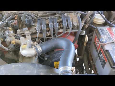

My skid plates had been off for months. Shit you not, six days after I finally get them back on, I’ve got a coolant leak. Off they come! And wow. I knew we were sitting low on 30s, but that trail run did a number on my front skid plate. This is just the rocks in the center of a narrow two-track up into the mountains last weekend.
My first thought is heater hose, so I start looking and it doesn’t seem like heater hoses? Fortunately, I was talking with Josh at ADD. He suggested recording video with my phone and carefully slipping it between the engine and firewall. Brilliant idea. Never occurred to me.
I reach in and start feeling for cracks or cuts and… Is the clamp only finger tight?
YEP.
