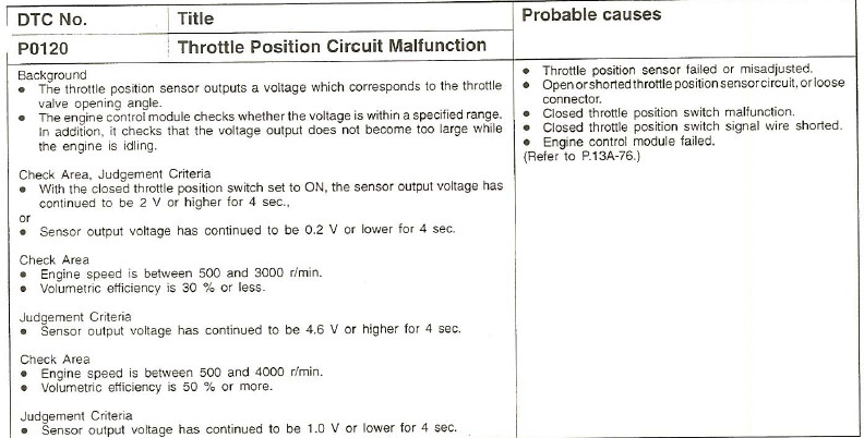

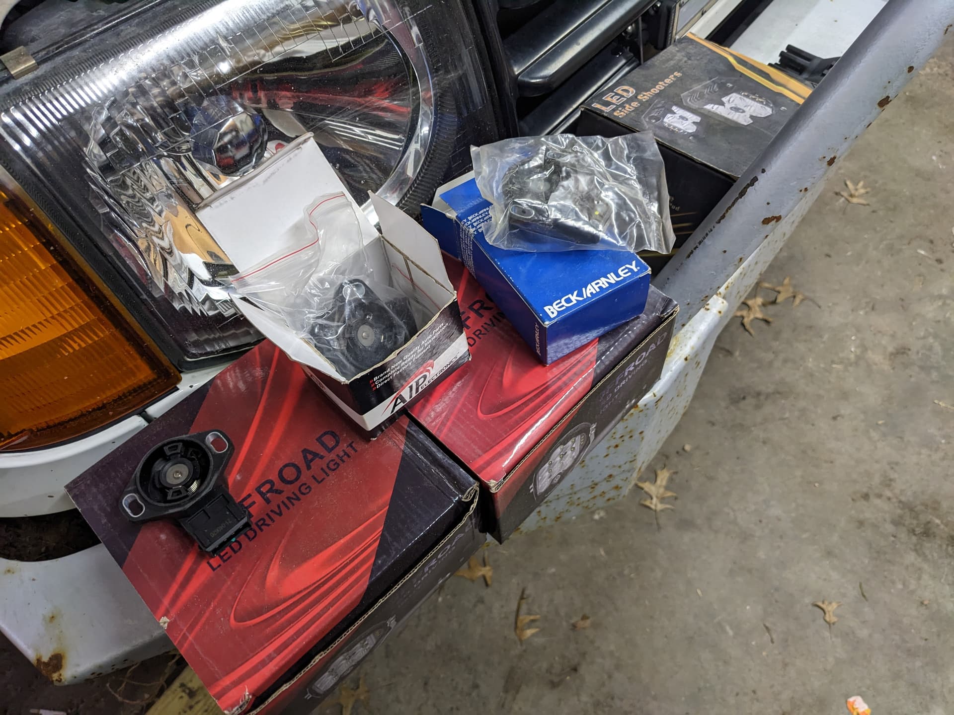

- I thought the problem was Amazon TPS—but the problem came back with an OEM TPS.

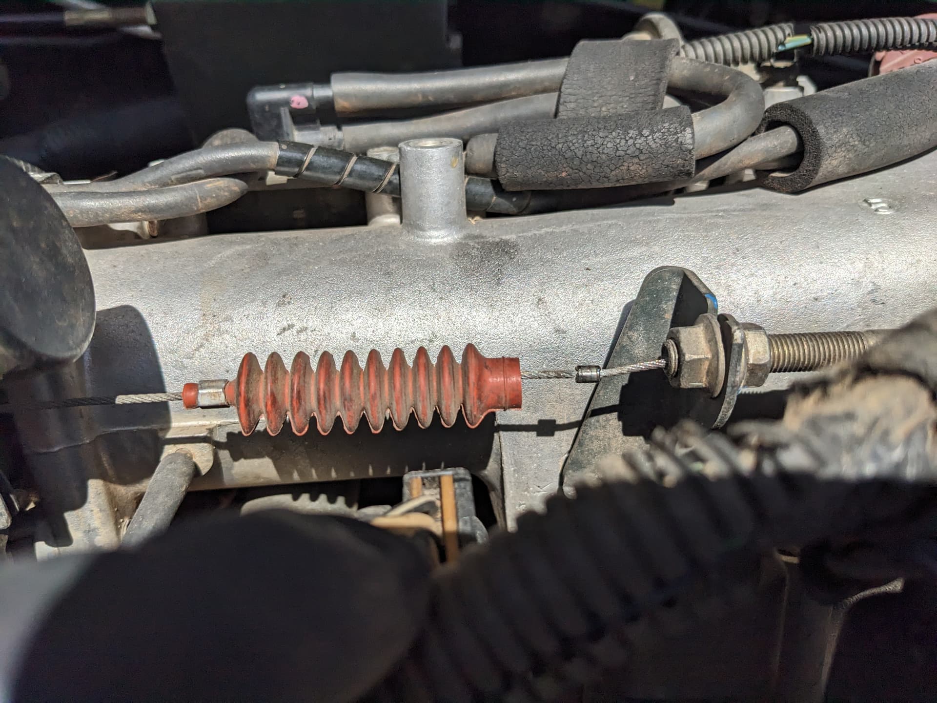

- I thought the problem was the cable adjustment—but the problem came back after it was set.
Staring out into the abyss through the windshield, I found myself wondering if the OBD scanner dongle was to blame. I mean, let’s see now…

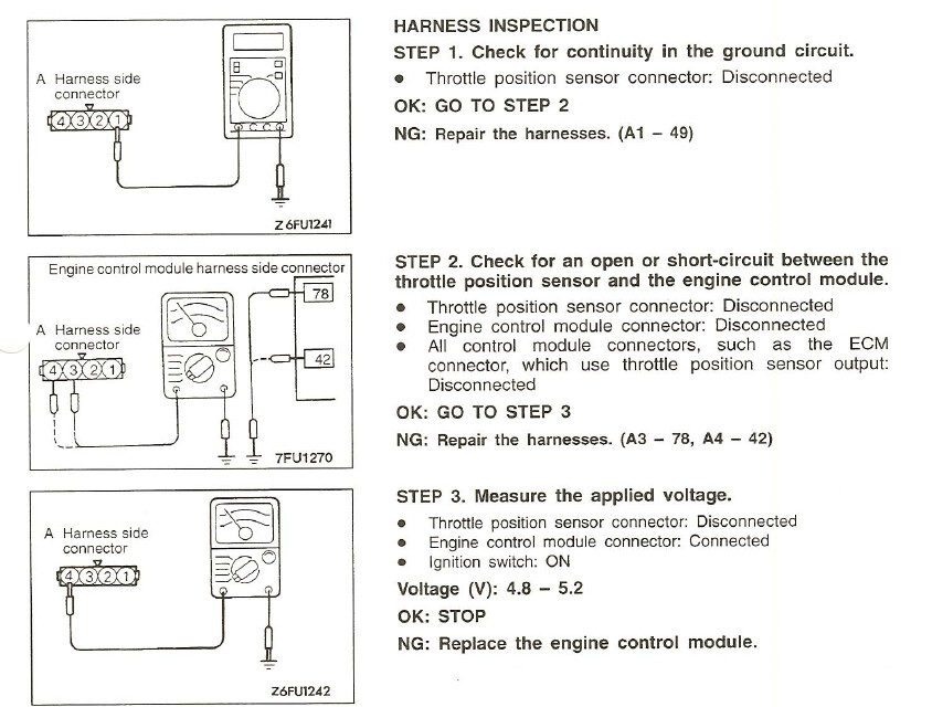

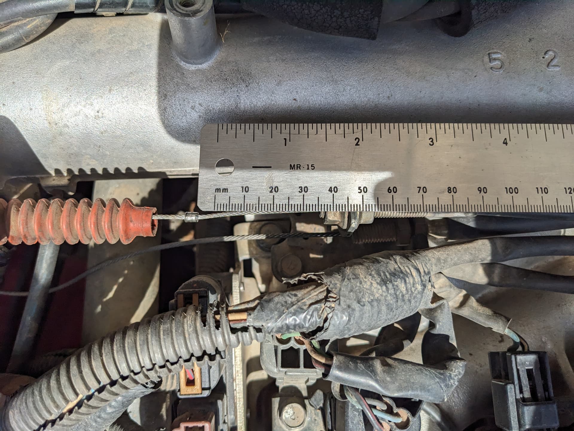

I re-installed the TPS and re-adjusted the cable. The logger read 60% or 90% no matter what. Just like it had done on four other TPS I had lying around. Mechanically, I was set. Electrically, something was off.

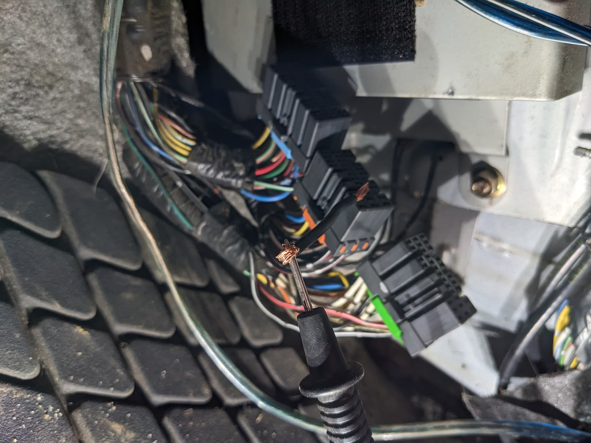

But I had already traced the harness between the TPS and ECU a couple weeks before and verified it was intact and secure.; at least at either end where things were most likely to be moved. I also confirmed the ECU was sending the proper voltage to the TPS. So I should have been set, electrically, too.

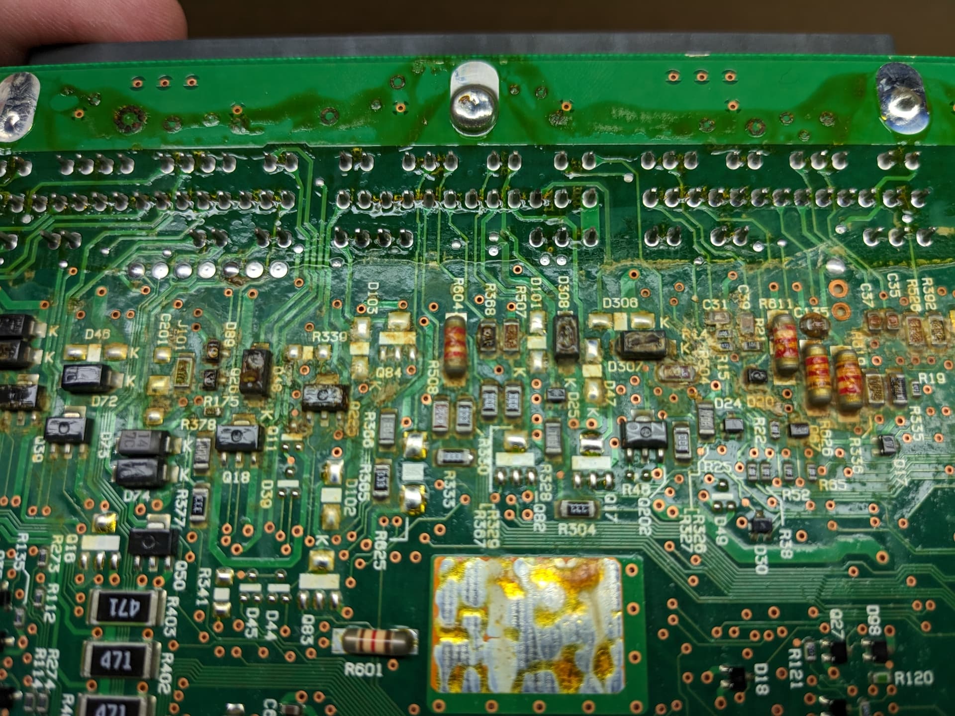

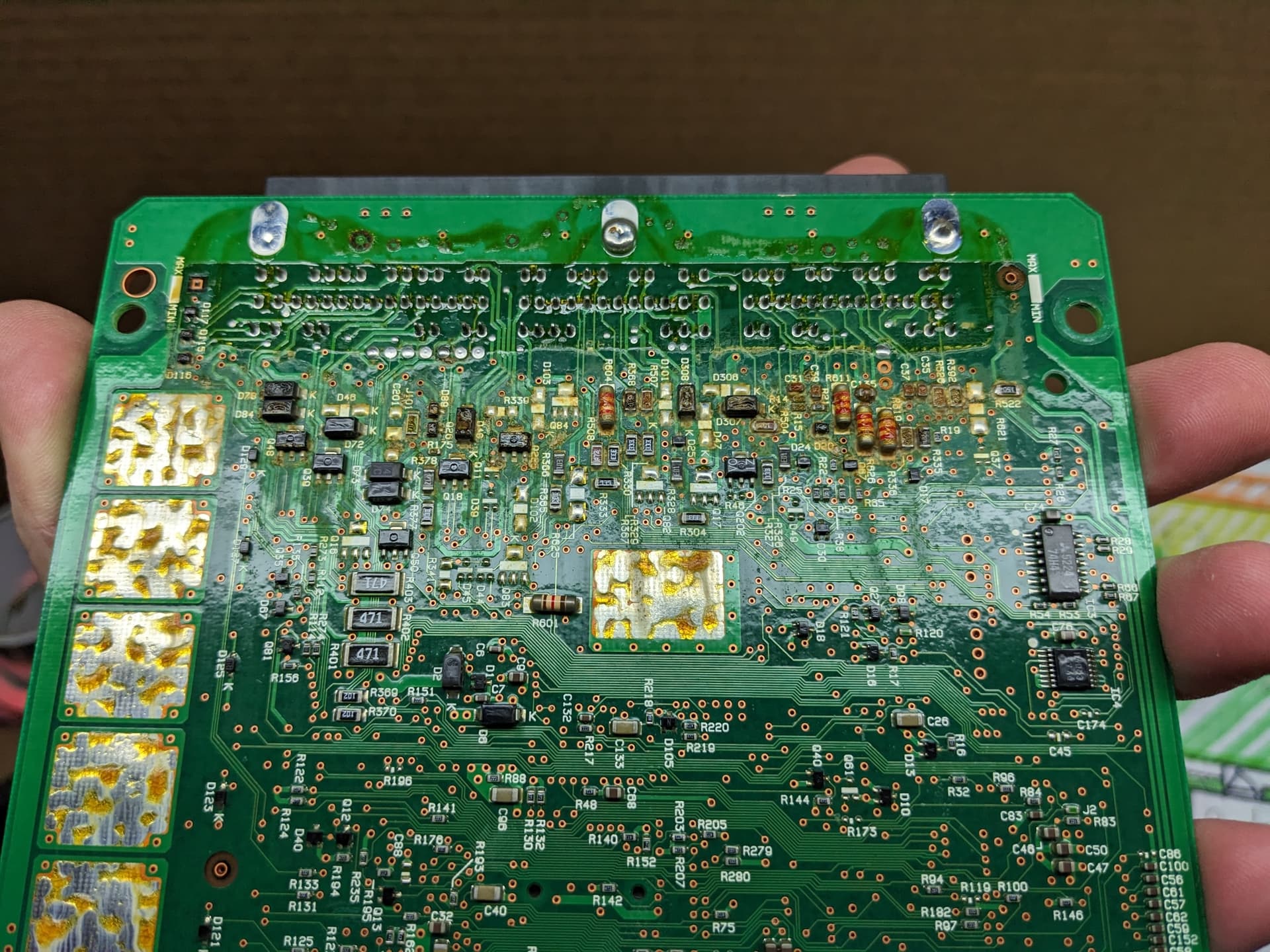

The kick panel was still off from when I traced the harness so I decided to pull the ECU and check for leaky caps. There were none. In fact, the ECU looked great, except for a stripe of rusty-brown surface corrosion across the back of the board. This corrosion cleaned up nicely, with minimal scrubbing with a new toothbrush and 99% isopropyl rubbing alcohol.

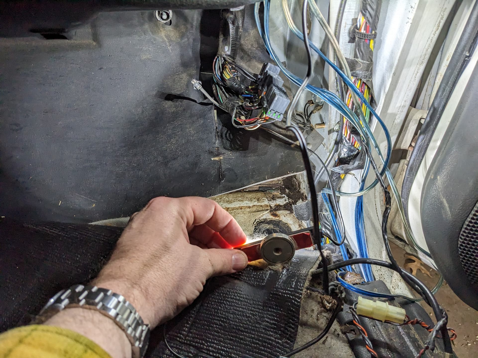

Removing the mud-crusted WeatherTech floormat in the process of getting in there, I discovered the carpet was wet (again). I pulled it back and found the insulation behind the rubber pad on the footwell was soaking wet. (Not seen, it was soaking wet all the way over to the center tunnel below the heater core, too, but did not smell at all like coolant. This was just water.) Was the windshield seal leaking? Had leaves or acorns or something gotten into my sunroof drains since I cleaned them in the fall? Where is the water coming from, and is it the cause of the fresh corrosion, and is that the cause of my struggles?
It’s looking like hanging the ECU over a sopping wet sponge for six months of winter might be taking a toll on the ECU. I’m hoping I can confirm the leaks, patch them, and get on with my life.
