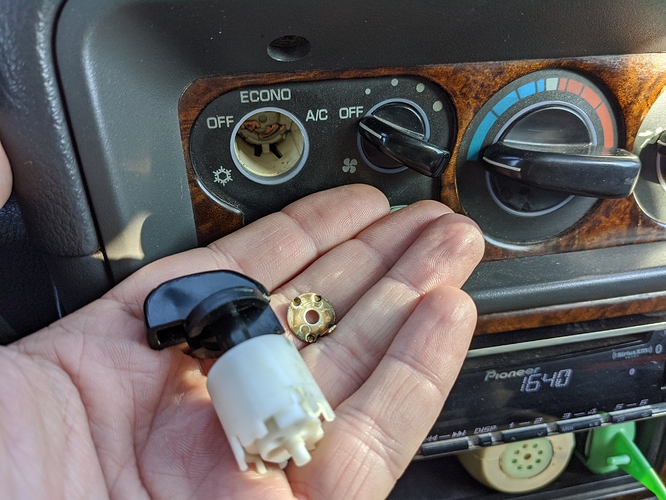

And then this happened.

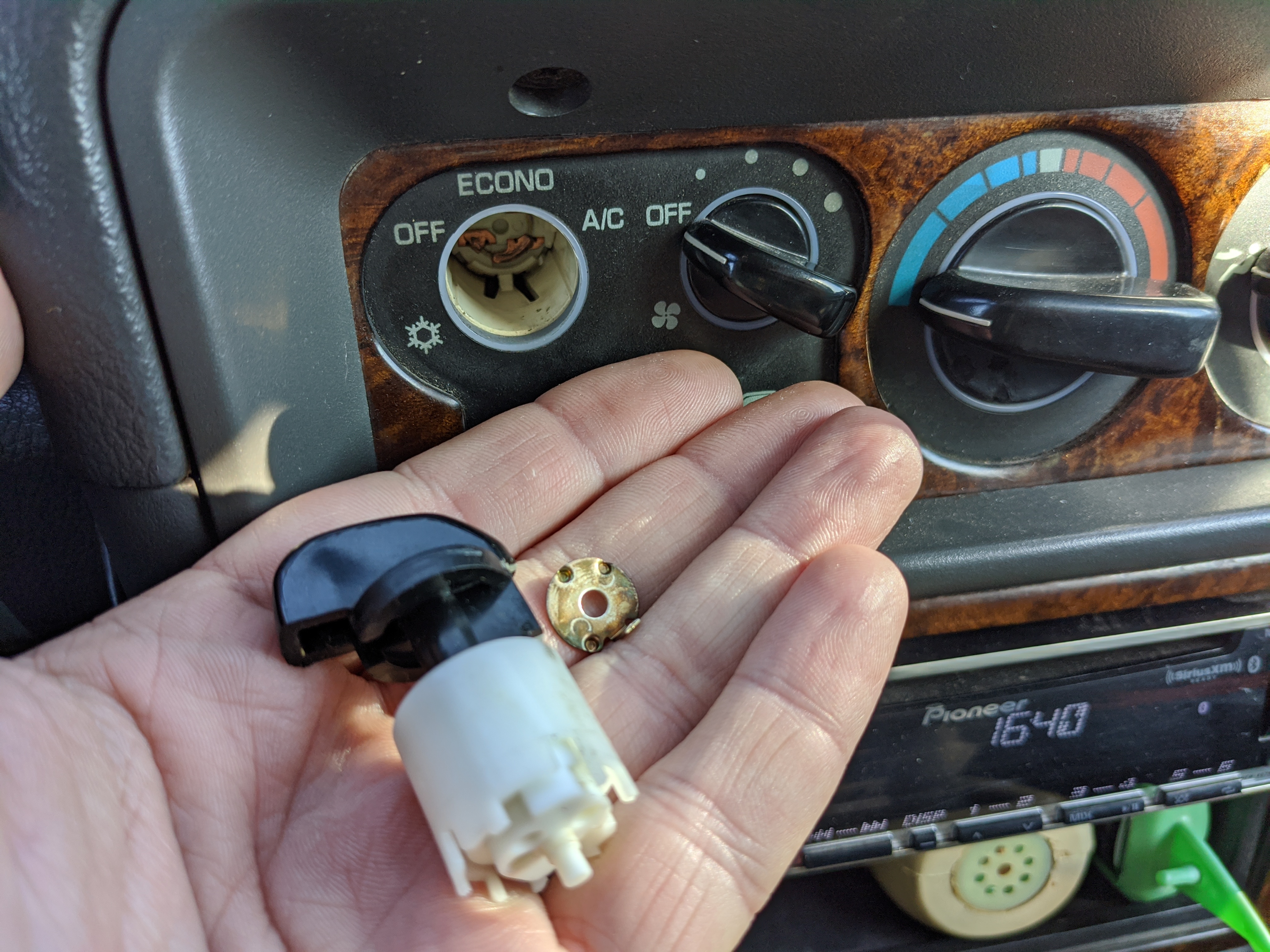

Seems like it should be an easy fix, but I can’t get it back in there and engaging the AC.
I’d really like to avoid opening up the dash to replace the HVAC controls…
:rage:

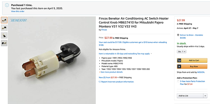

Quick Update: I posted the above picture on Instagram and good guy Ryan Yantzer pointed me to this jobber:
Should show up just in time to be necessary, though I’ll still tinker with the old/busted one to see how it works.

You have a link to the switch?

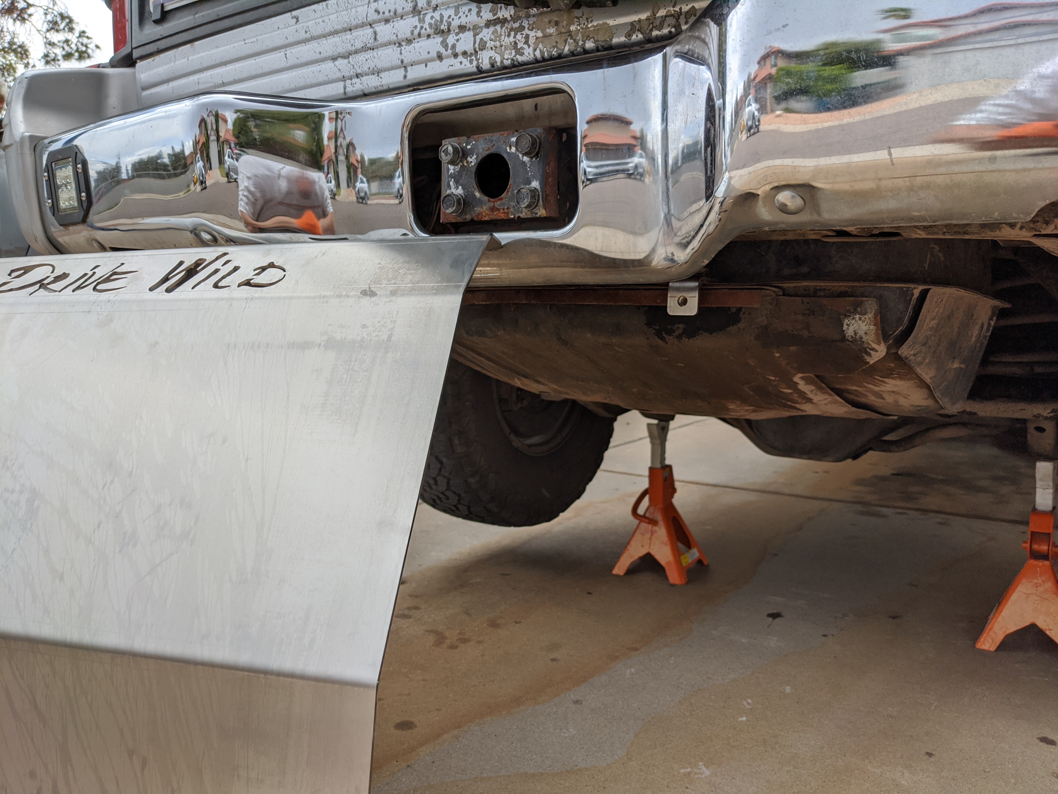

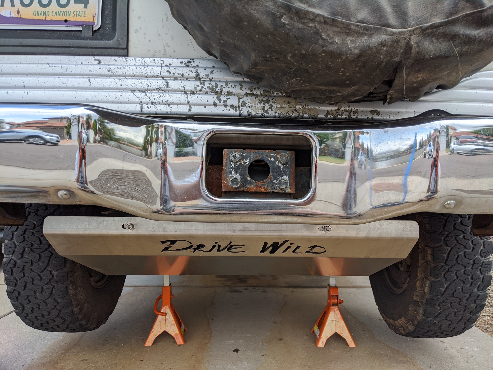

I’ve got the complete set of four skid plates from ADD. They’re beefy as hell. And since I had the rear up in the air to top off the rear diff (I forgot a quart on the shelf last weekend, meaning the rear diff was a quart low), I figured I’d install it.
First thing I did was pull up @racedinanger and @BradD’s excellent install video:
I was a little nervous about not having a second set of hands or fresh hardware, but I’ll be damned if it didn’t go in fairly easily.
The install went quite smoothly with the exception of one of the bolts being bent forward almost 30° from The Camry Incident. After trying to bend it back into place with vice grips, a variety of implements on a floor jack, and a sound beating with the mini-sledge, I ran a longer bolt through from the top and worked my way around to the back. Boom. A righteous skid plate to protect the ol’ fuel tank.

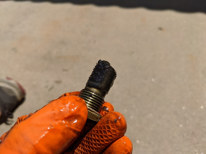

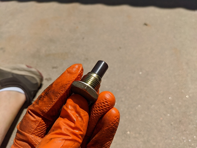

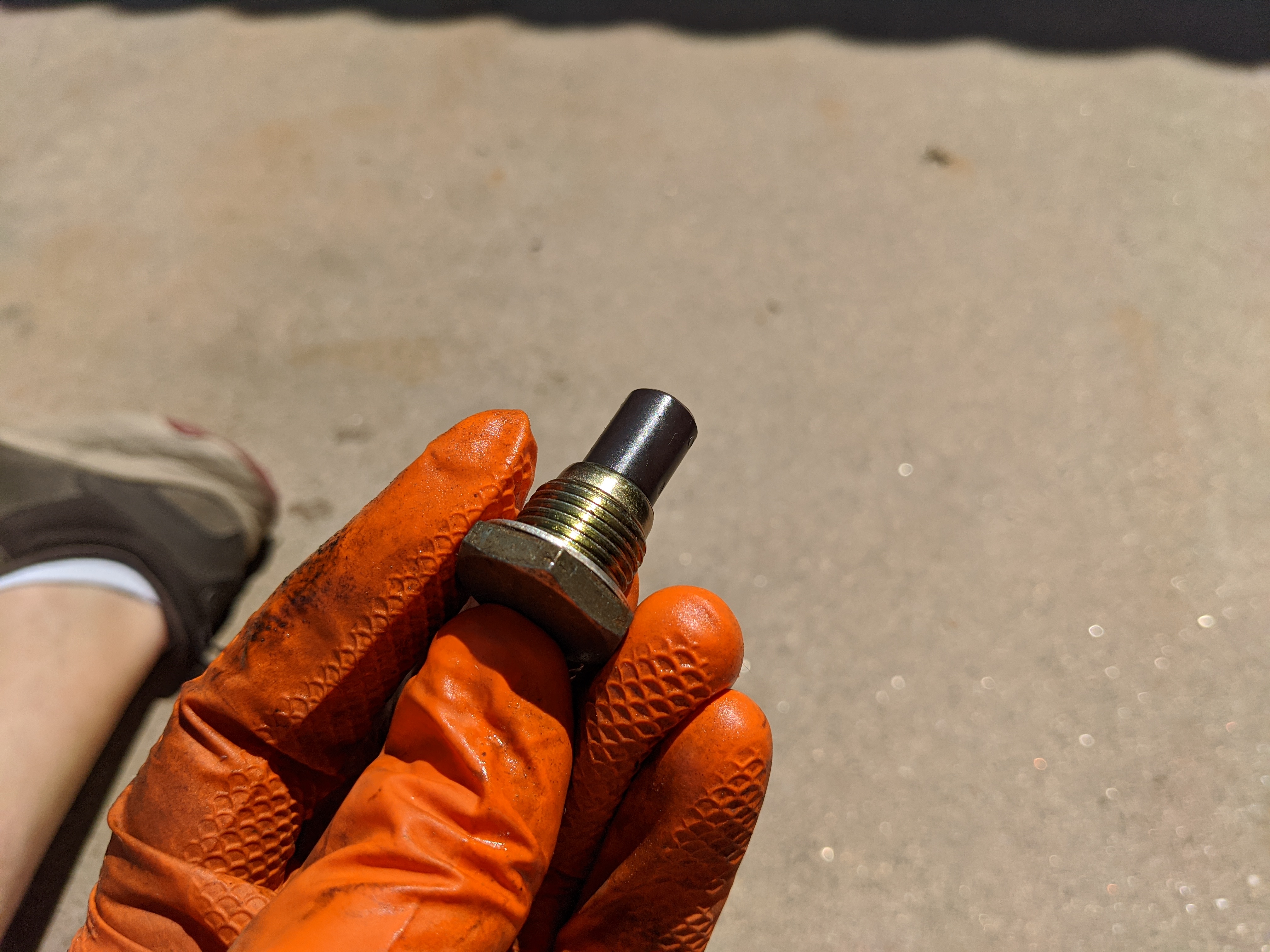

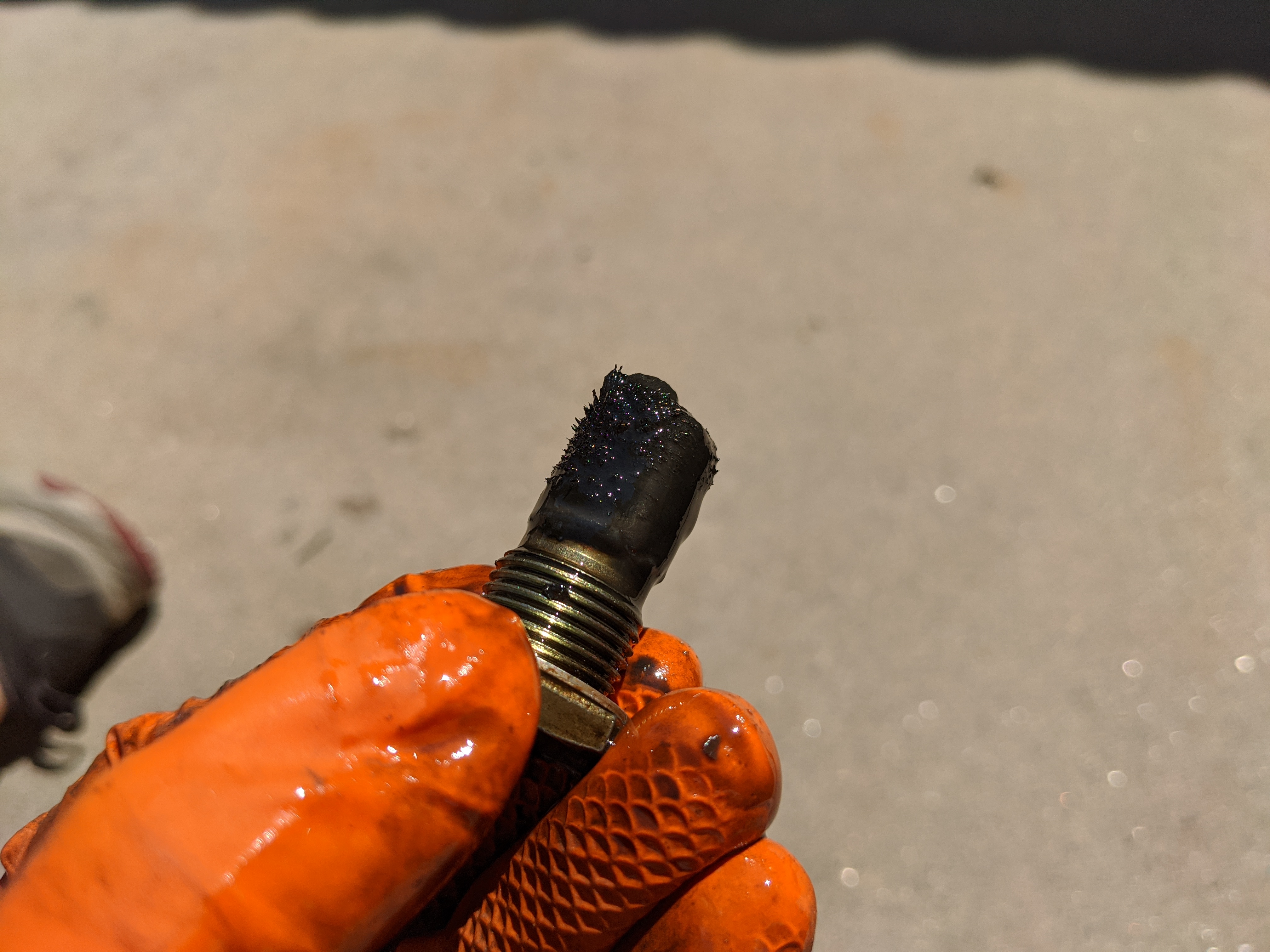

After topping off the rear diff, I set my sights on replacing the tcase oil. Like the diffs, there was a magnetic drain bolt. Does anyone know if this is factory stock? I mean, I’m glad I’ve got them, just not sure if it was something nice the previous owner did right for once. Just look at all the sludge on that thing. (The rear diff was the same way.)
Here it is all cleaned up. That’s a lot of sludge.

The rear skid is easy to install, I too would like to add sliders before I go “off road” because IIRC I’m only running 31". I use my truck for doing domestic stuff, so building it into a total off road rig is not in the cards.
The rear skid was indeed easy to install.
