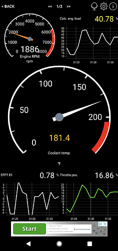

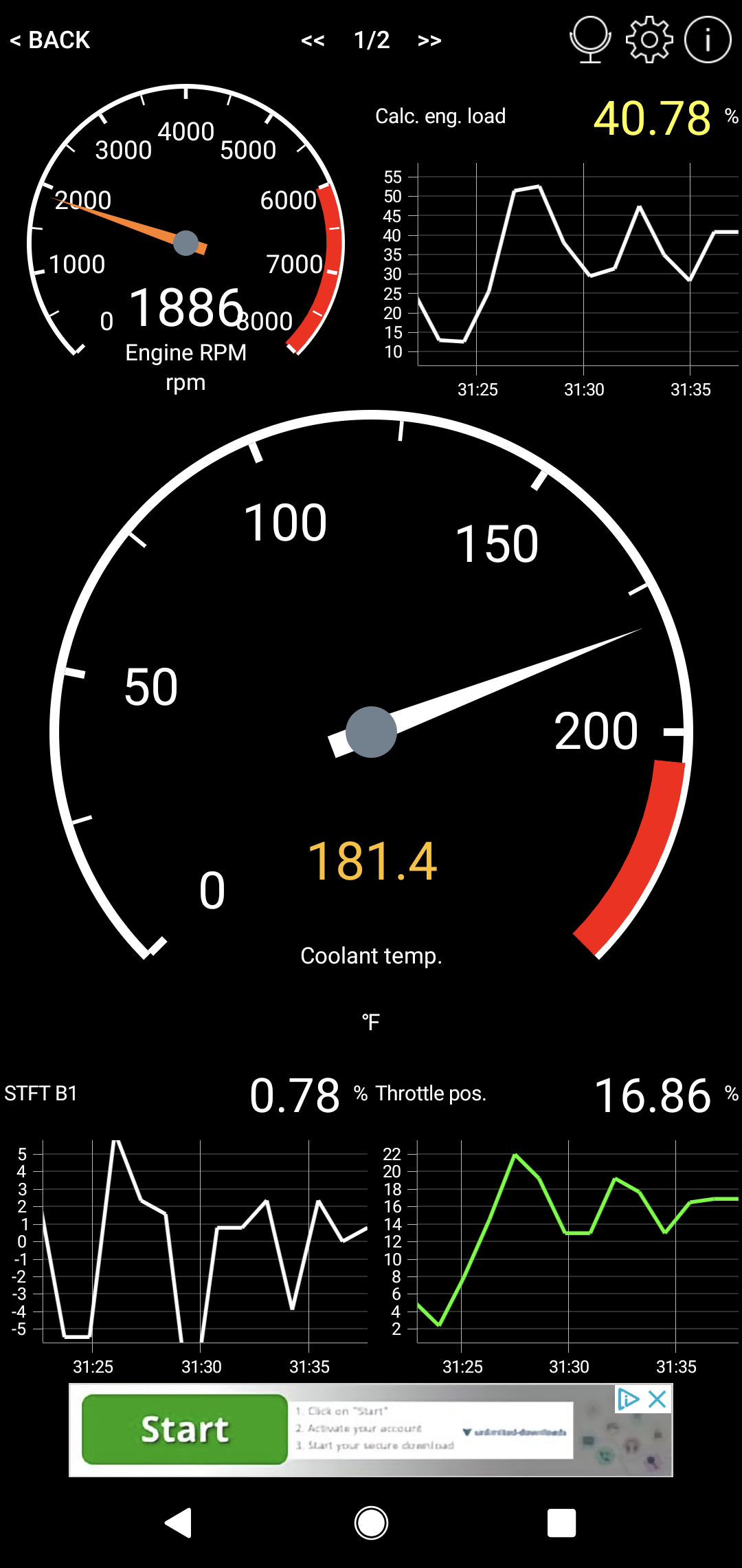

I’m told 20% load at idle is likely due to a combination of the automatic transmission and alternator—but I still feel like it should be a bit lower. In any case, I found a better scanner app; cleverly enough called Car Scanner. Go figure.

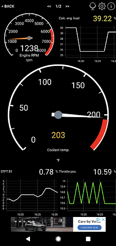

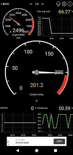

The below is after idling for five minutes in a shady parking spot with the AC running. TPS is definitely doing something odd. I wasn’t even touching the pedal. And, with the engine off (but the key in the ON position), I got a range of 0-89% max.
I tried slowly depressing the throttle to look for any flat spots en route to WOT. Didn’t see anything.

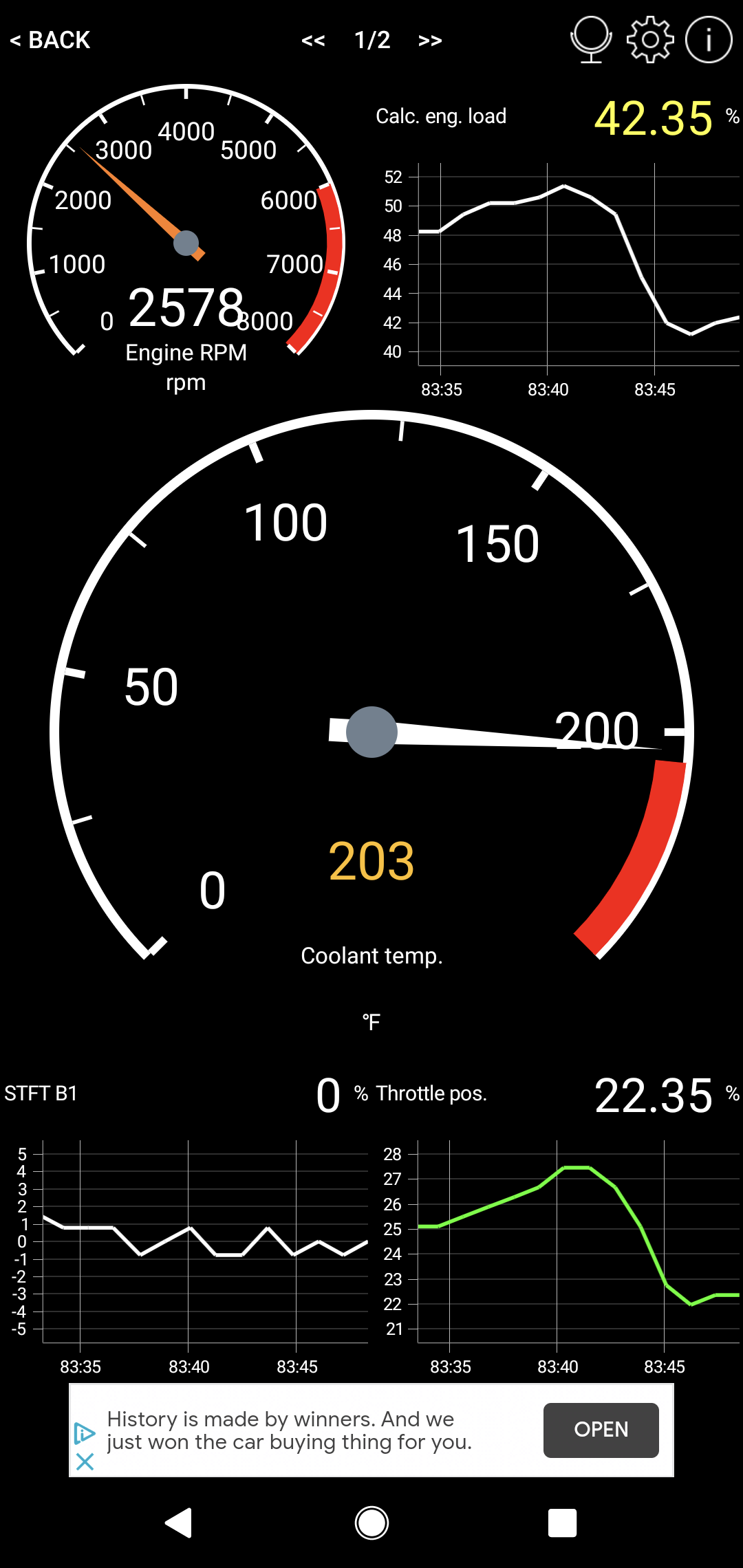

We decided to try making a run up the hill to take a hike. I was nervous, and I took it real easy all the way there. We did 50 uphill in a 65 zone. We got passed–a lot. But we never got above 204.8°.
Of course, it was 10-15°F cooler when we were on the hills and we weren’t loaded for bear, but still. We got back on the 17 southbound and immediately did a 20-60mph, uphill blast out of Camp Verde–with the AC on.
(Check that crazy TPS action under cruise control against calculated engine load up top. Weird, right?)
I left the OD off and held speed almost all the way. The final crest in sight, and seeing the speedo drop below 50mph in third, I grabbed second and punched it. Crested the hill at 70, touching 210°F for a couple seconds before quickly settling back down to 195-203°F for the rest of the trip.

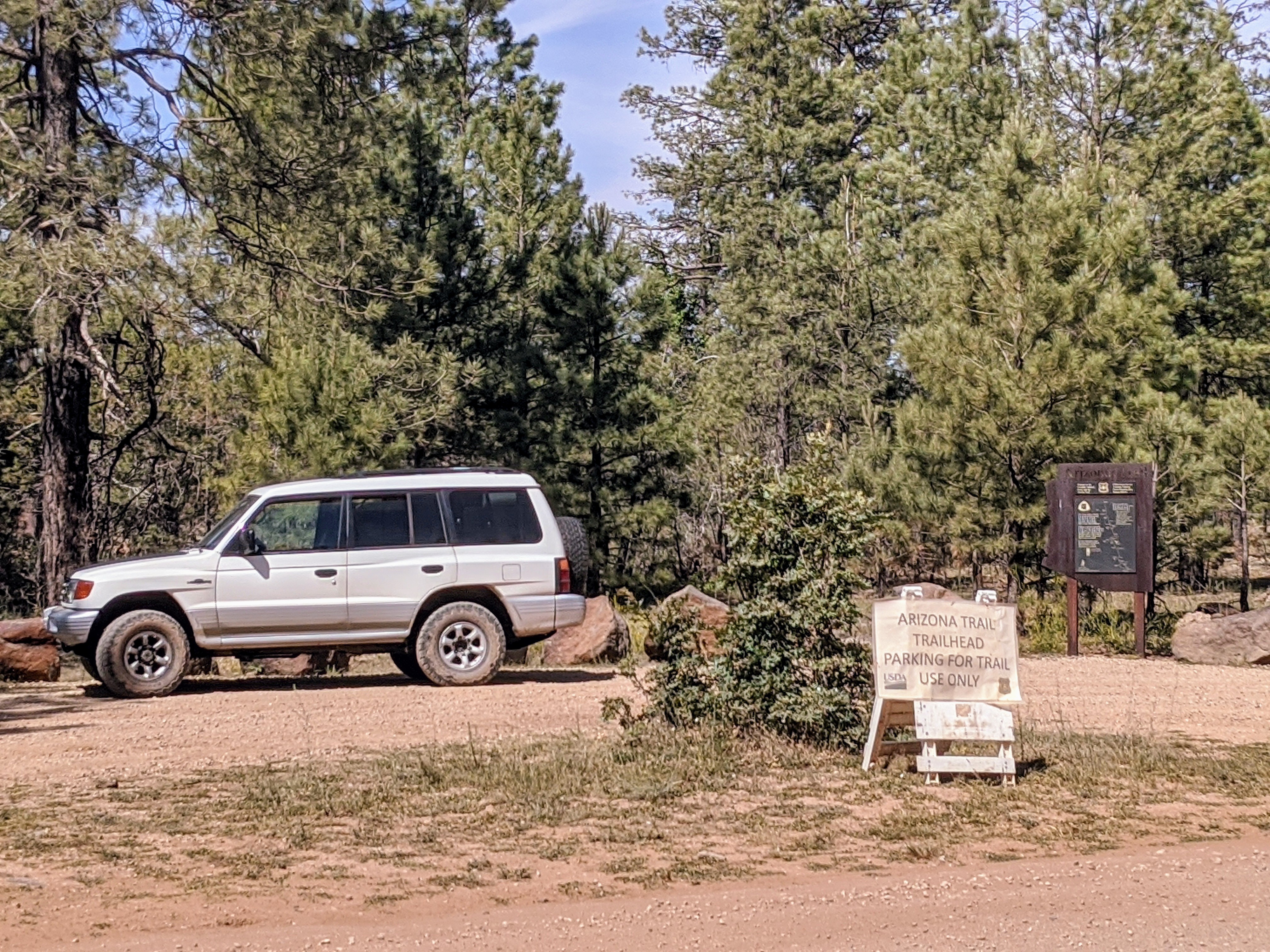

Picture from the above mentioned trip up the hill.

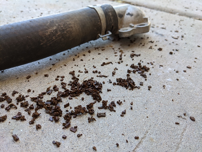

After changing the oil, I drained the brown pond water from the radiator and overflow bottle. Then I removed the lower radiator hose, thermostat, and upper radiator hose.
When I went to set the lower hose down next to the truck, all kinds of brown, crusty stuff fell out.
That’s not good.
And yet, it is–because it’s exactly the sort of thing that could restrict coolant flow through the thermostat. At least, that’s my theory.
I stuck the garden hose into the top of the radiator and let it run until the water coming out the bottom ran clear. Then I stuck it in the upper water neck until the water coming out of the thermostat housing ran clear. Then I hooked up a high pressure nozzle and sprayed through the radiator, oil, and trans cooler fins until that water ran clear.

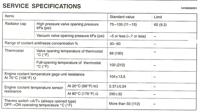

- Factory thermostat starts opening at 190°F, then fully open by 212°F. So I guess 212° is okay.
- Temp gauge in the cluster doesn’t move above normal until 240°F?!?! Not sure about that.
- “Modern” cars are known to run as hot as 240-250°F?!?!?! #shenanigans
